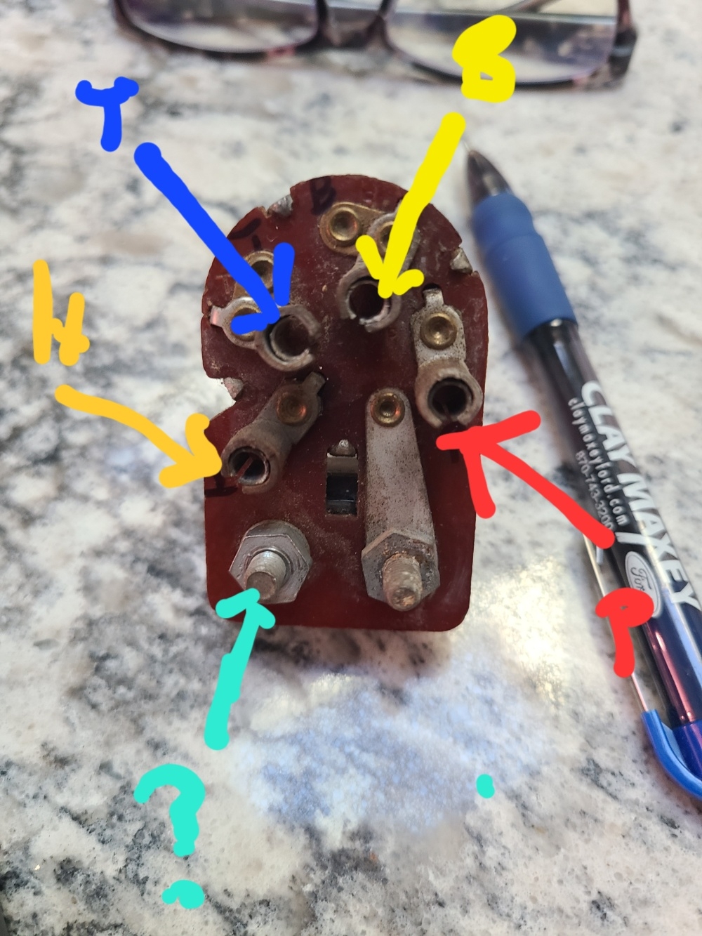

I have attached a photo of the 53 headlamp switch I purchased to replace the aftermarket headlamp switch the previous owner put on in the late 60s. I have looked through the wiring diagram and can account for almost all the wires.
H is dimmer switch
P is parking
T is tail lights
B goes to main circuit breaker (aux side) and door light feed.
The stud terminal marked in the picture in teal appears to be lighter, clock, and main circuit breaker (bat side).
My question is, the diagram shows the clock, lighter, and main circuit breaker feed all on the same side of what appears to be a resettable breaker built into the switch. This matched the clipped wires that were on the used switch I bought. Should the clock and lighter actually be on the unmarked stud terminal in the picture.
