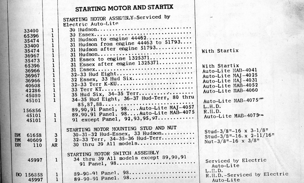

You can also find some starter listings on a Hudson factory bulletin found at
https://openforum.hetclub.org/uploads/FileUpload/47/c38f42b41486ec5b903b1149c5ecb5.pdf
Ivan, so 4075 is what the 92 is supposed to have? Thats the way I read it to be.0
So 4076, can I use that?0
Val
Here is more information I have from manuals as well as an article from WTN Sept/Oct 2006 by Walt Mordenti.
In the General Information Bulletin , the note at the top states starters from 1936-1947 are interchangeable except for solenoid mounting.
Hope this helps.
Ivan L.0 -
