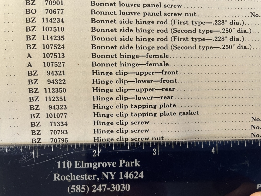

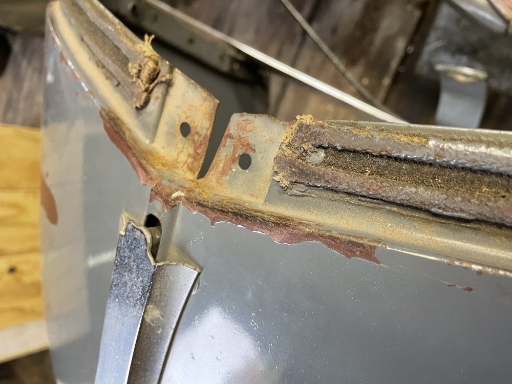

Can anyone post a picture of the hinge clip mounted on the radiator shell for a 35 T. It was missing when I got the car. The parts book lists a few other parts related to the clip. Wanted to know if it's similar to the one mounted on the fire wall. Also wanted to know if anyone has a spare one they are willing to part with.

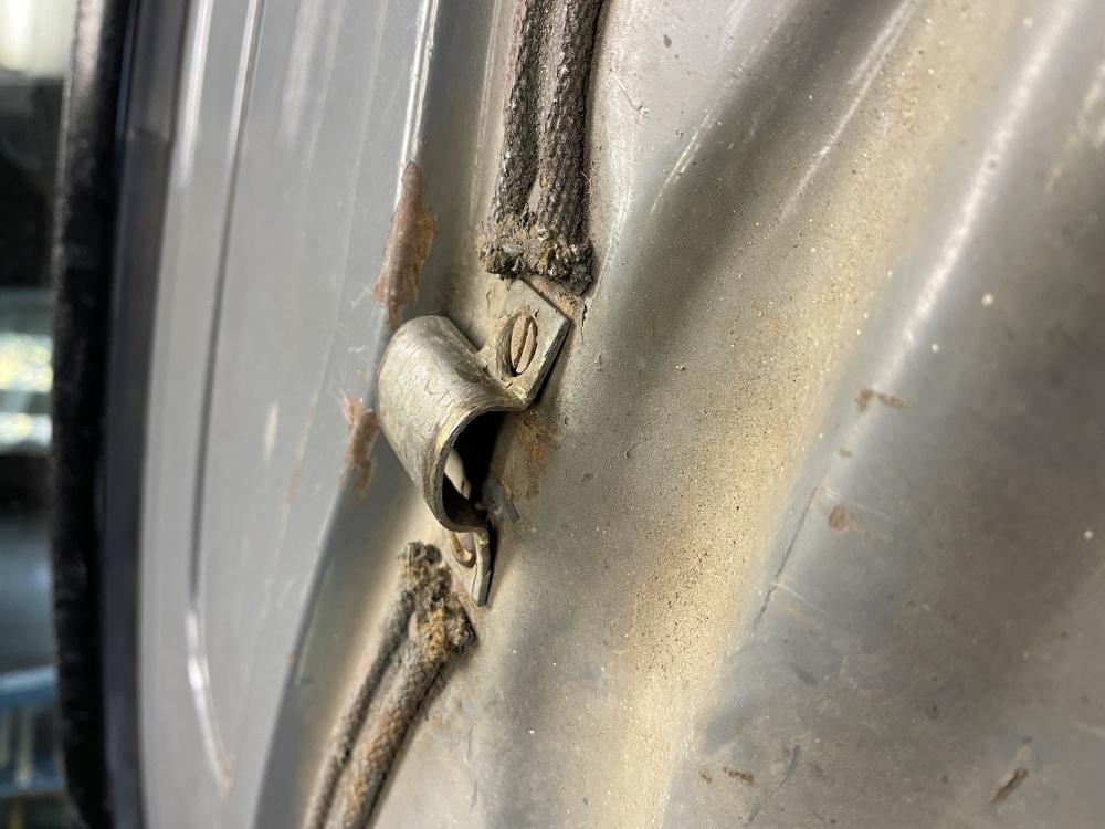

I am on the road, but if memory serves..they are essentially the same. I did not check the part numbers. I can look at my car next week when I get back if no one chimes in. Regards, Tom0
The 35T bonnet hinge ends are the same front and back, for a 35H the front hinge end is the same as the T but the rear hinge ends are different. Hinge ends from any early MG, models TA to TF will work for the 35T.0
