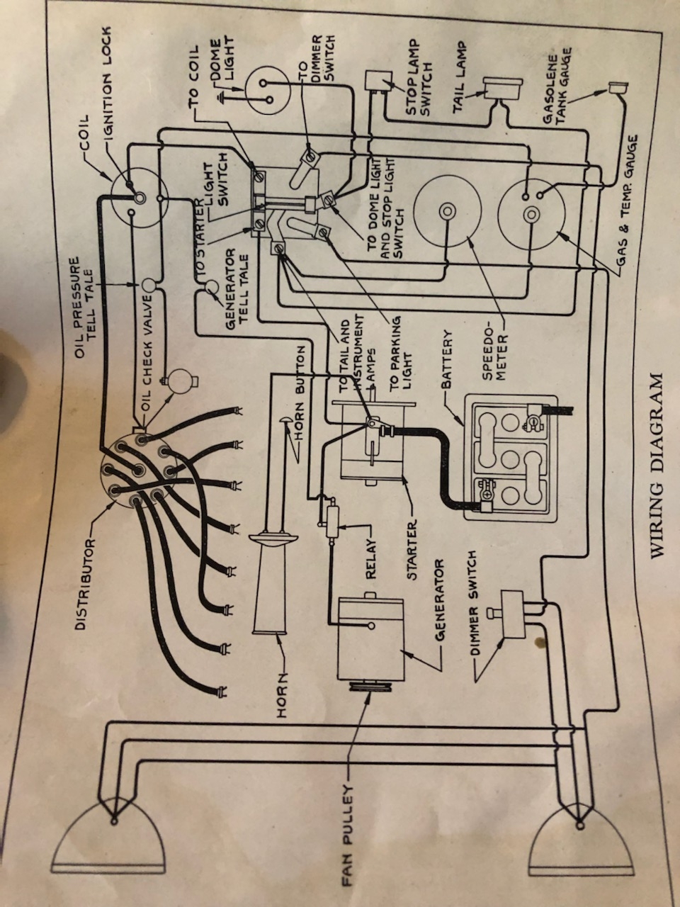

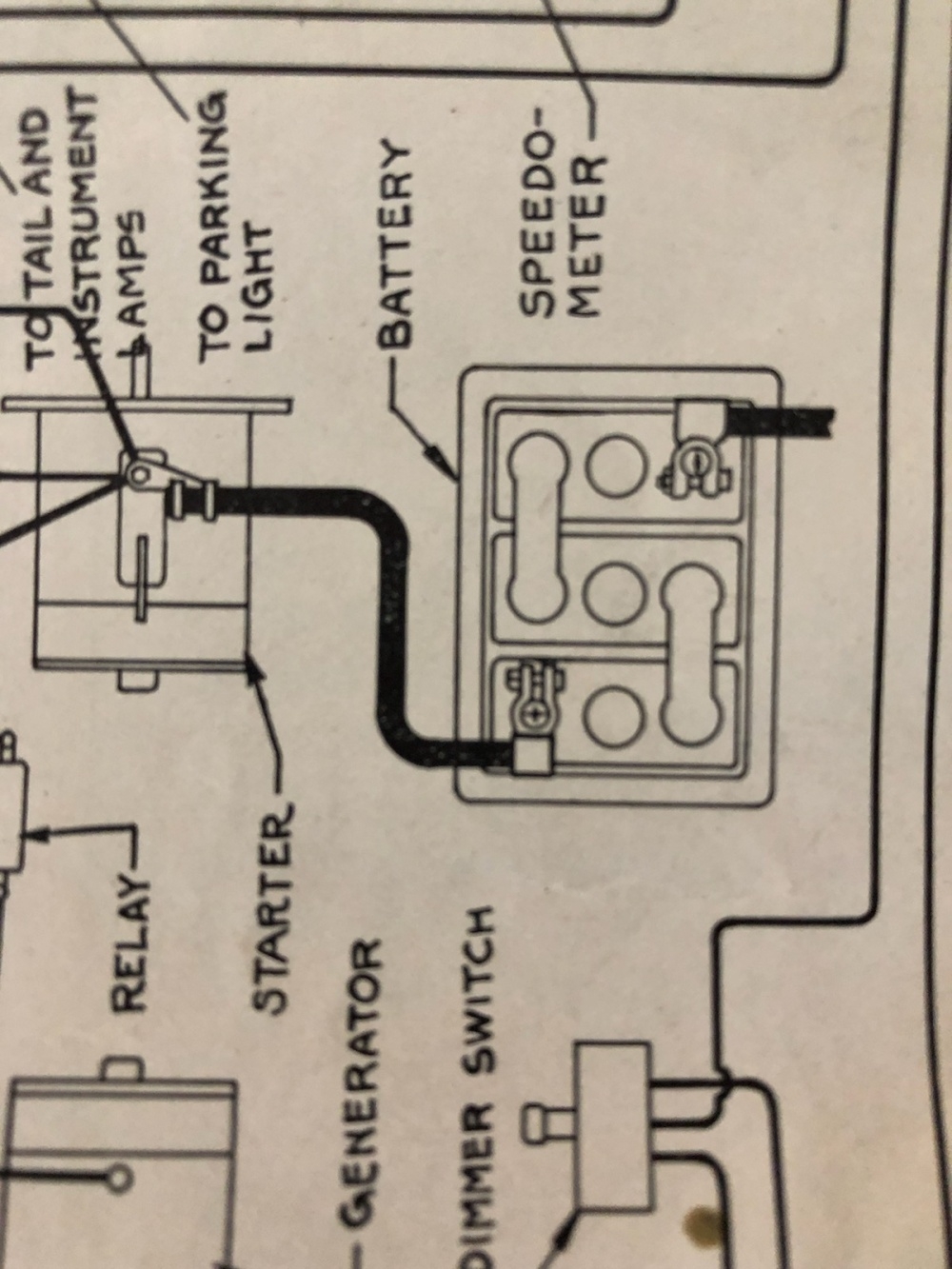

In looking at the wiring diagram from '33 Terraplane 8 manual, it looks as if the positive side of the battery is going to the starter. Look at the blow-up picture of the battery in the attached.
Can this be possible? This would make it a negative ground.

That is correct. '33's were negative ground. Hudson went to positive ground in '34.0

My hudson 8 from 1934 has the positive to the mass.
I wonder what prompted the change?0
One source suggests that with positive ground the insulation did not tend to disintegrate as much , due to the reversed chemical action of converting acid to electricity.0
My 1950 MGTD (and ALL MGTD /TFs and every MG before) are positive ground. The only reason owners are converting negative ground is so they can power ports to charge their electronic doo-dads.Regards, Tom0
