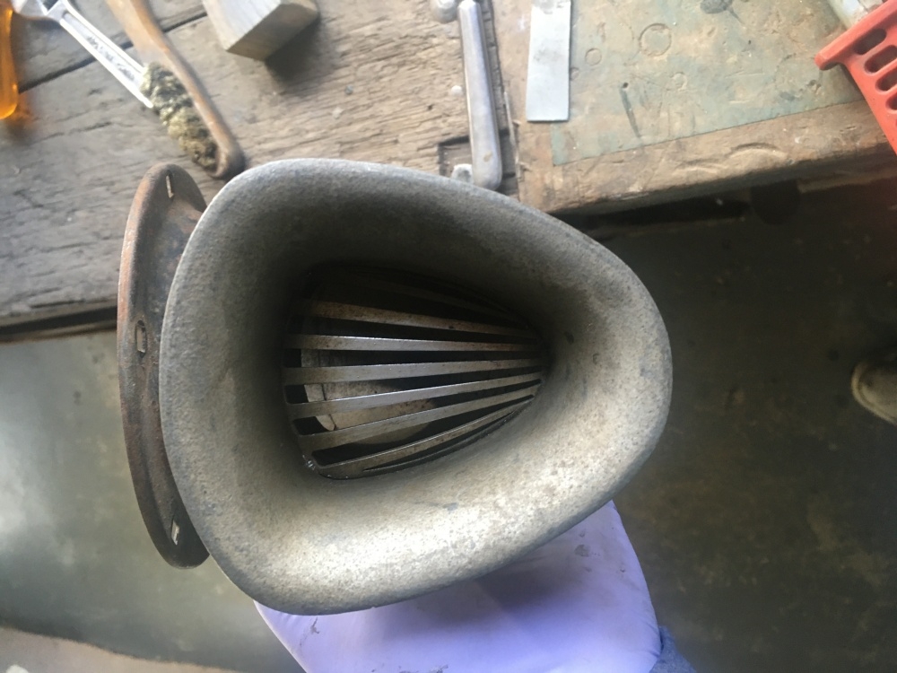

I have been fortunate to locate, what I believe, is an original tear drop horn with "grill" insect screen intact. I would like to remove the screen and get some laser cut. My problems is - how to remove it with damaging the screen?
Before I tackle it, does anyone have suggestions on how to remove the screen?

I have had success in removing the grill screen - three golf balls behind the screen and a bit of pressure and it popped out without distorting the grill screen.
This is what the screen looks like out.
