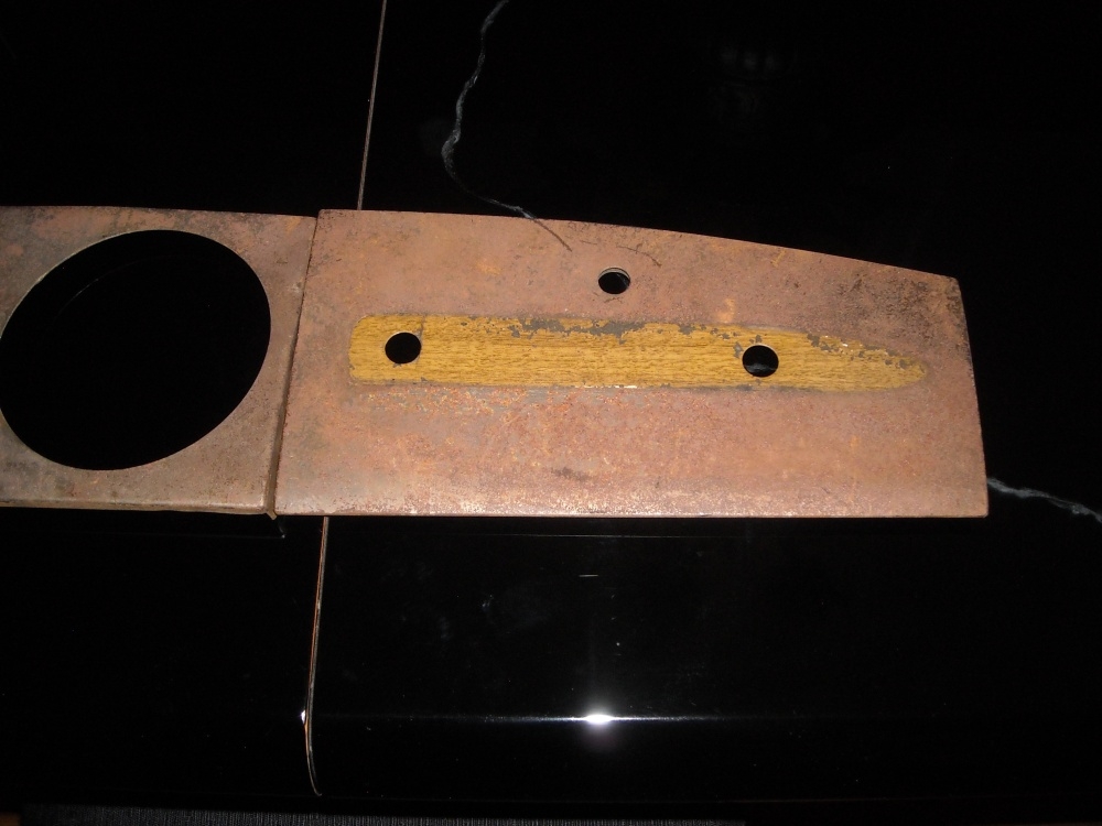

When I removed the plastic badge from the glove compartment door I got a good look at the original woodgrain ( in the attached pic ) and I agree, not flat not glossy. Unfortunately, the guy doing the hydro dipping offers only gloss or flat so it seems that gloss would be the best option. I guess my biggest concern is sun reflection if using high gloss on the top portion of the dashbent metal said:I would think neither. It's going to be something in the middle. When I used to paint cabinets we would order the finish coat in various gloss levels, depending on the customer's request. Usually in 20% increments. My guess is the original was about 60% reflectivity (or "gloss level"). However, I've seen dashes painted at full gloss that looked very nice. I don't know what factory stock was.0 -
