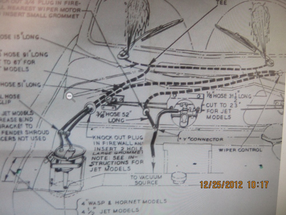

The July 1954 Hudson 'Service Merchandiser" has a nice illustration and description for the windshield washer installation on Stepdowns and Jets. You can view it via the club on-line library. Hope this is of some help.0

Thanks for all the info. I am getting there just playing around to convert grom vacuum operation to 12 volt but keeping looking original.
