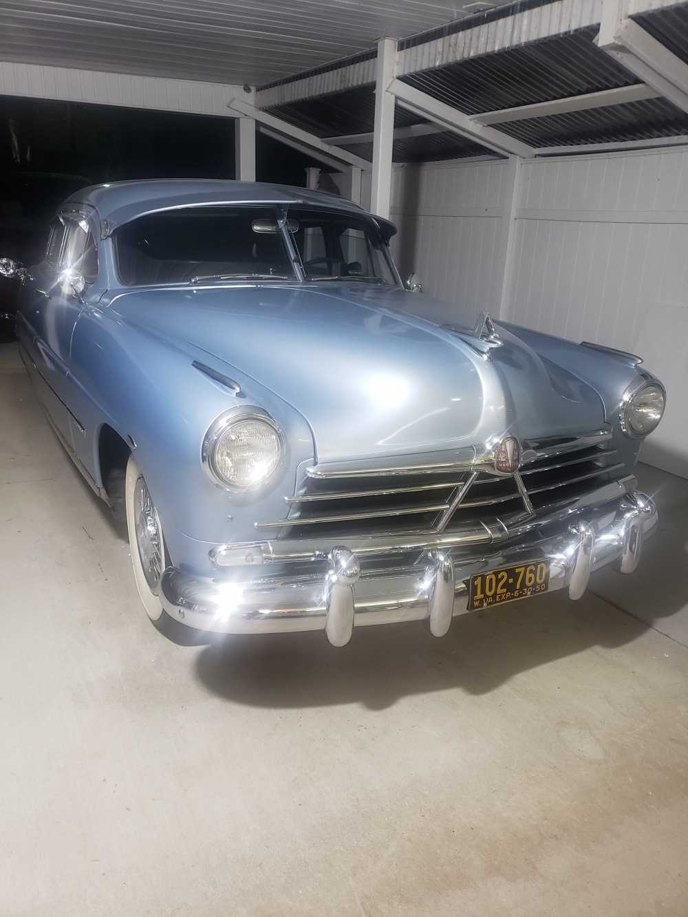

This is my 1950 Hudson.. I've being working on the seats and painting the engine..
Thank for all the help........0 -
Beautiful car, we’d like to see more pics when you can0
Wow!. beautiful Hudson
