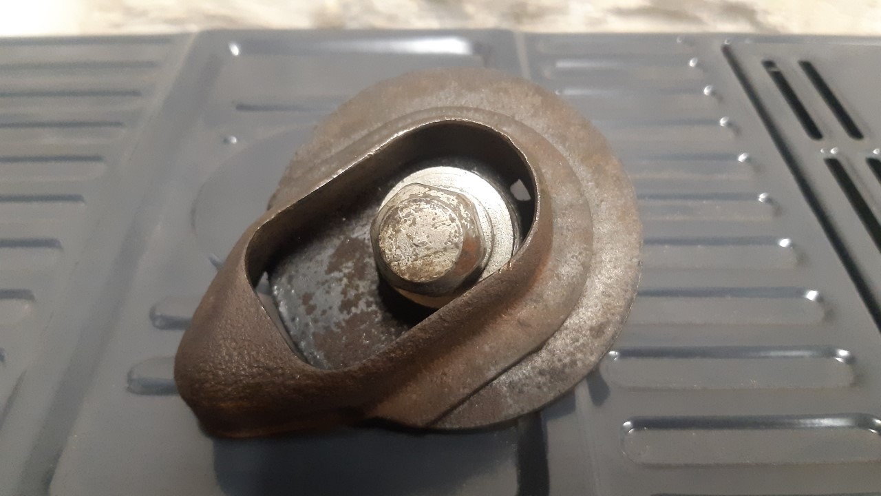

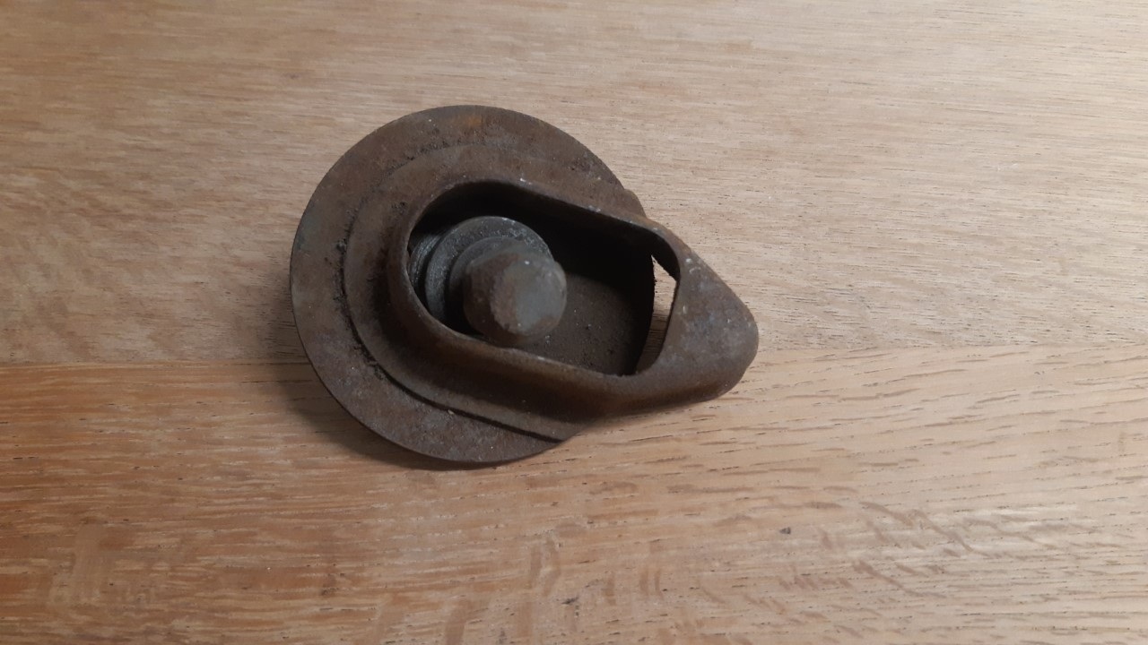

I'll try to take pictures of you tomorrow of my original survivor.
TapeI just got home from work. I took pictures; the vehicle is not my home
Thickness 1.5 MM
BELOW THE PIECE 2MM
If need be I'm here.
For my part; I'm looking for this piece to fix the second spare wheel. It's the only piece I miss
I have the original with the keys
