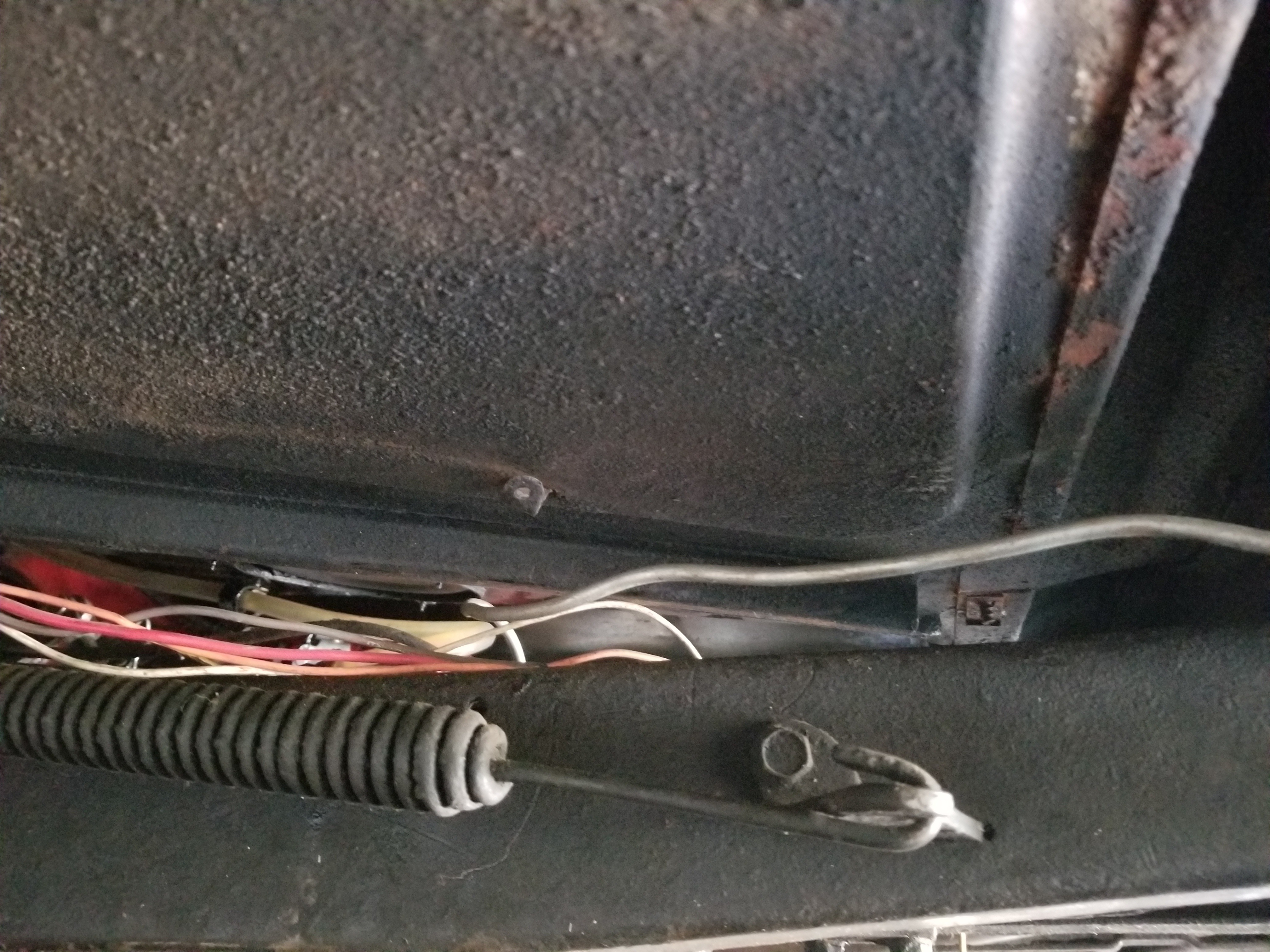

Glowplug that is not the spring that I'm talking about. The spring I'm referring to attaches to the lower end of the clutch pedal and a tab that is bolted to the frame. See the attached photo.0
Jason, no argument intended; but it is the spring and the tool Hudson provided to safely remove the spring from the tab. Look closely at the manual picture. The circular head of the tool is engaged in the spring that attaches to the frame hook mount. Good luck0

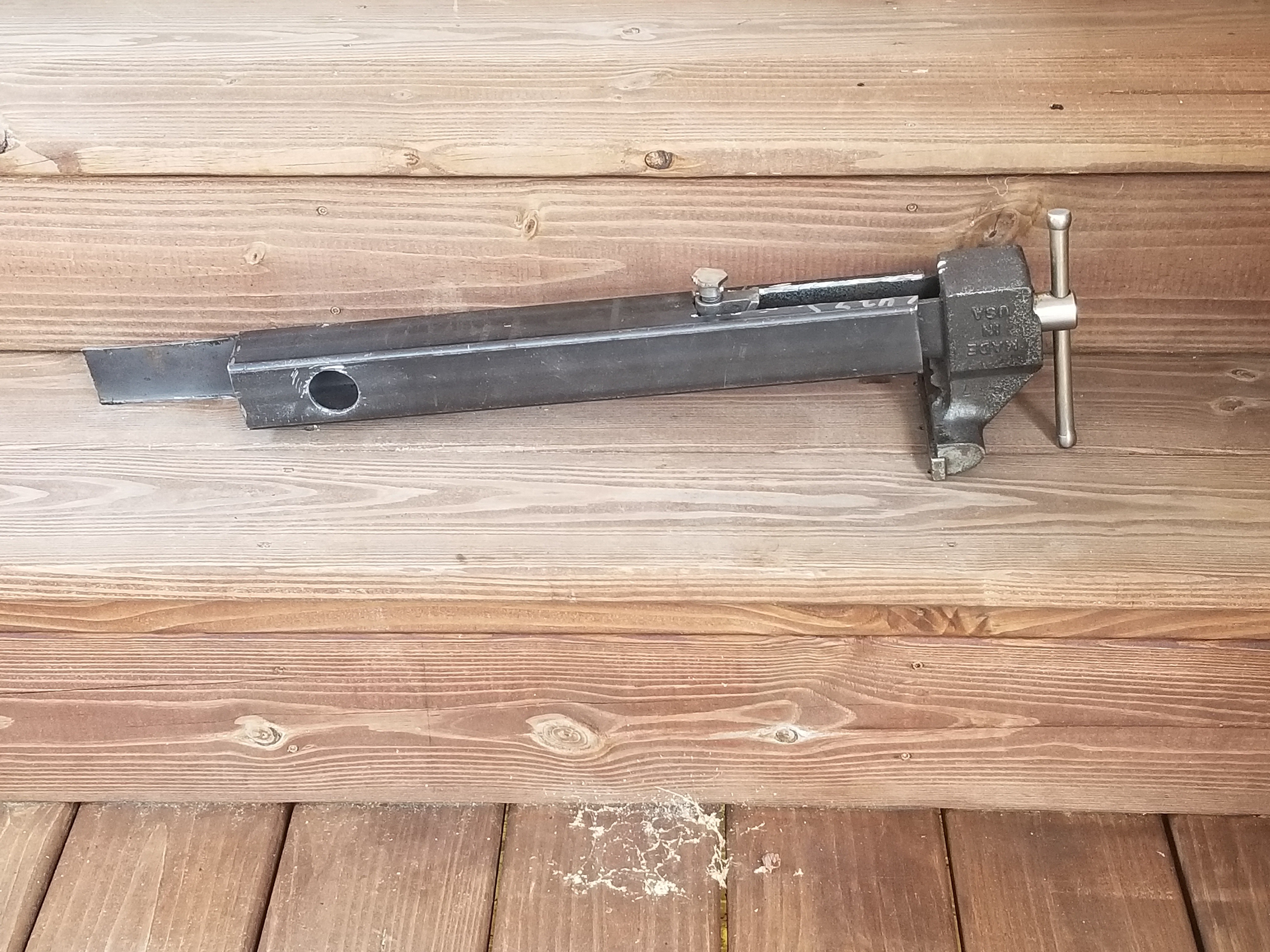

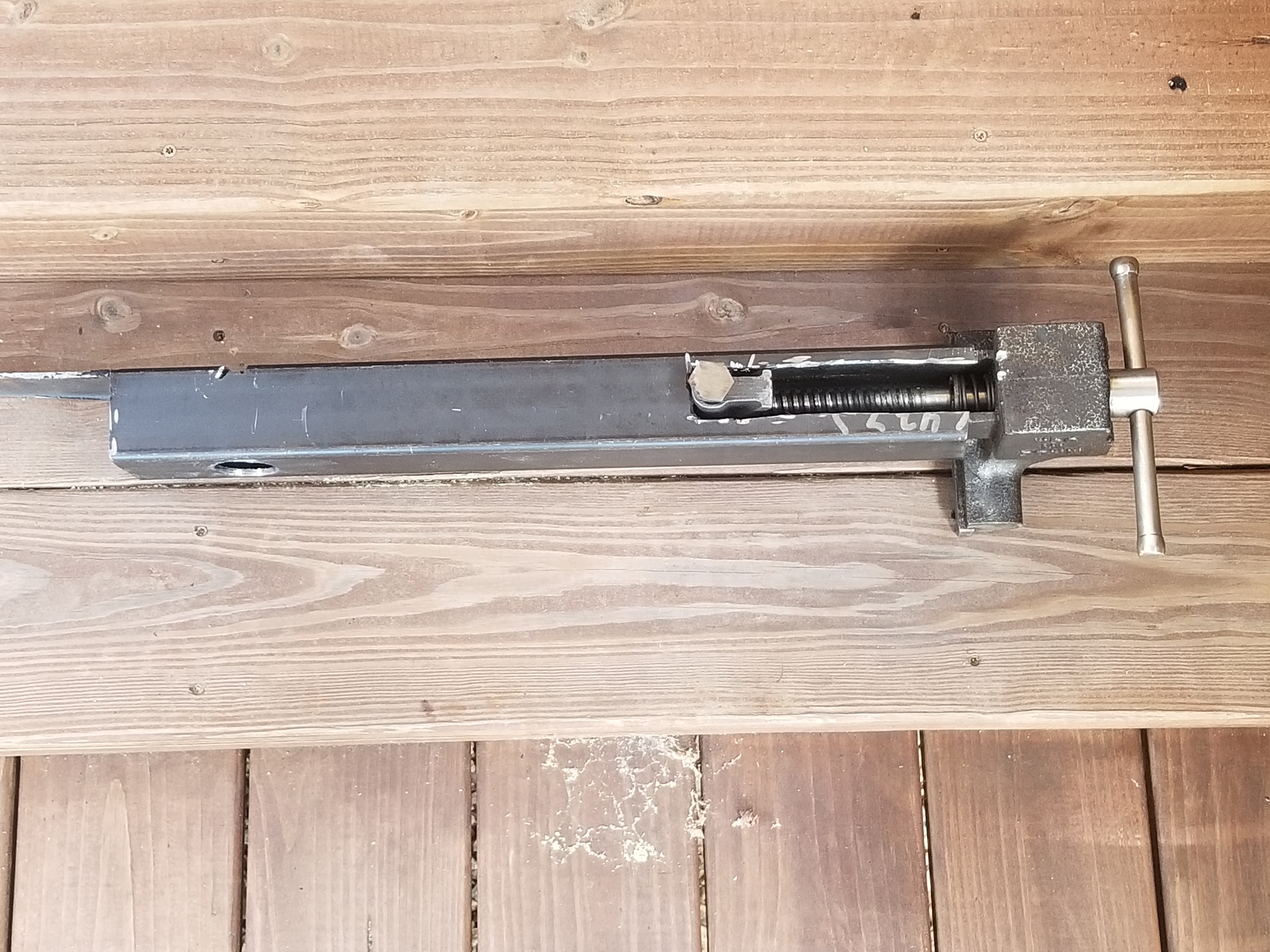

I'm a firm believer in the old saying, "Necessity is the Mother of Invention". I had an old broken vise and piece of two inch square tubing. I combined the two and came up with attached clutch spring tool. I have a few bugs to work out but it looks real promising.0
I used my invention to install the spring today. It took all of ten minutes and very little effort.0
