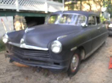

Heres a few pics ive only been working on it for a few months
i rebuilt alot on that on motor carb, fuel pump, generator, starter and all new old stock tune up parts

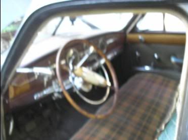

the interior looks alot nicer in the pic than in person
