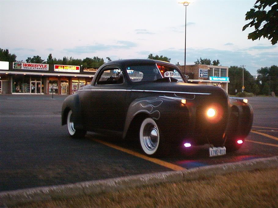

oh yeah heres a pic of the 41

Welcome aboard Brent, from an old Mopar lover, even tho I like Hudsons equally as well. Your car brings back memories - one of my first cars was a 1937 Chrysler C-16 Royal Sedan. Back in the '50s I raced on the old dirt tracks down south running 1937, 1938, 1939 Dodge and Plymouth coupes with the 1953 Dodge 241 small block hemi under the hood.
