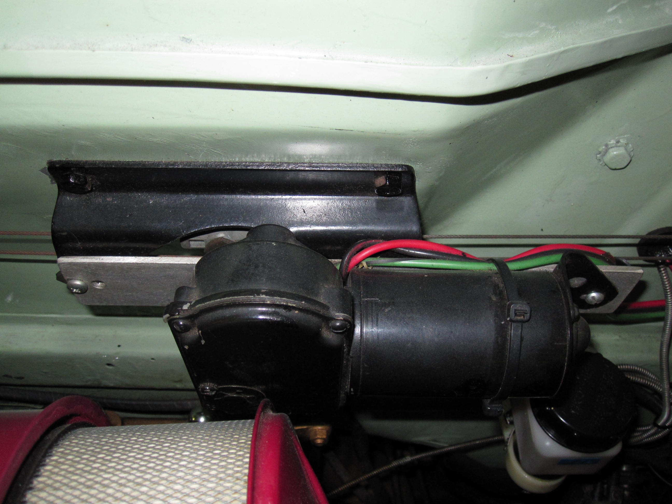

Can anyone tell me which is best model of electric wiper motor to replace the vacuum motor?
You need 12V..I installed an SUV Tailgate motor by fabricating a small firewall bracket then utilized the Hudson Link to attach the cables and installed a fused toggle Sw..It parks itself when shut off. Any motor Not mounted in the rear glass should work but I used a Motor from a full size Jeep SUV.
