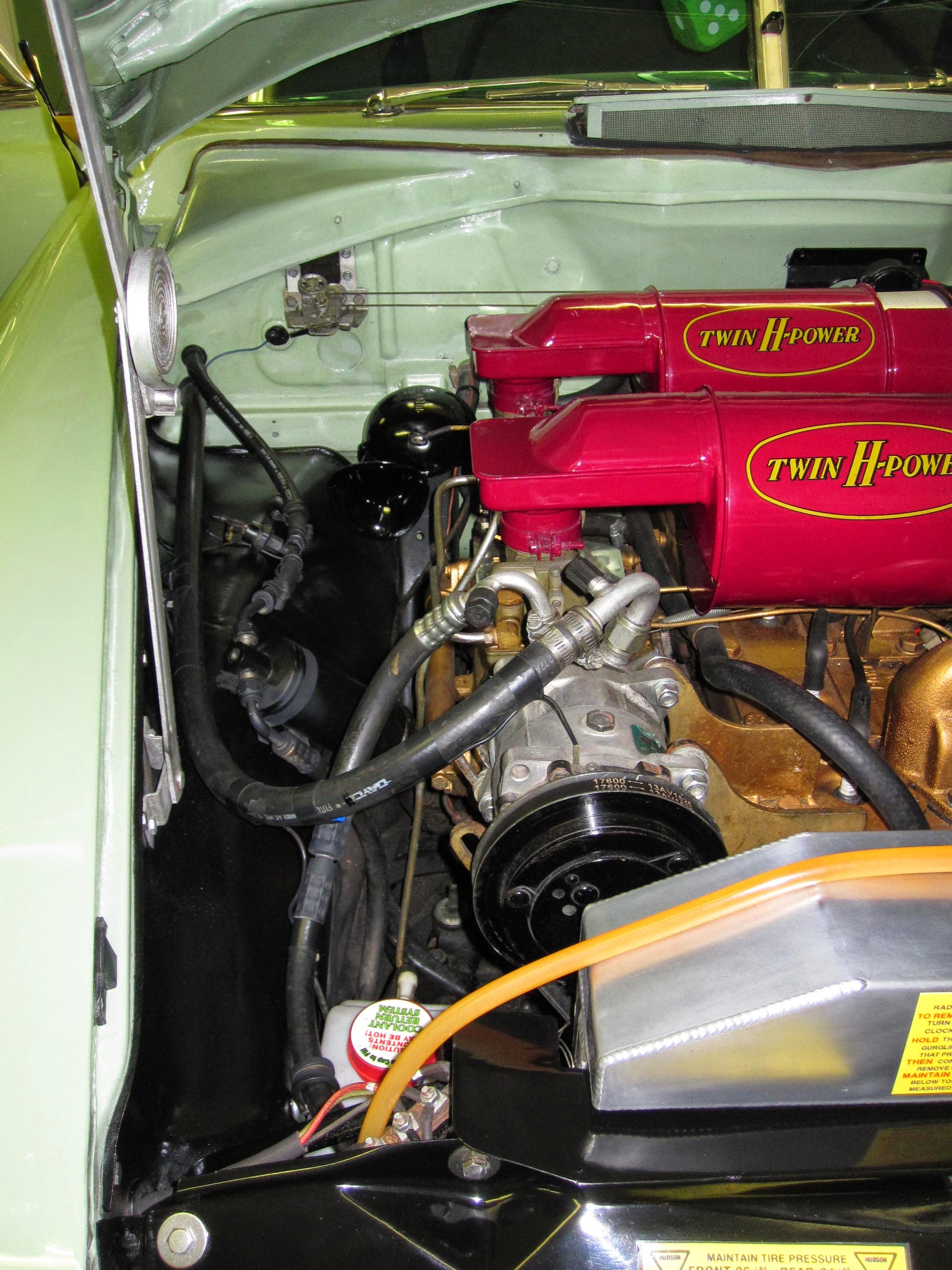

Go to Advance Auto and get the plastic overflow kit. Will include a rubber gasket you put in the cap. I have on two cars, works like a charm keeping the radiator totally full all the time. Mount reservoir on the inner fender across from fuel pump.
photo shows the clear hose(furnished) coming from overflow outlet going to the reservoir. Using Prestone yellow.0 -
