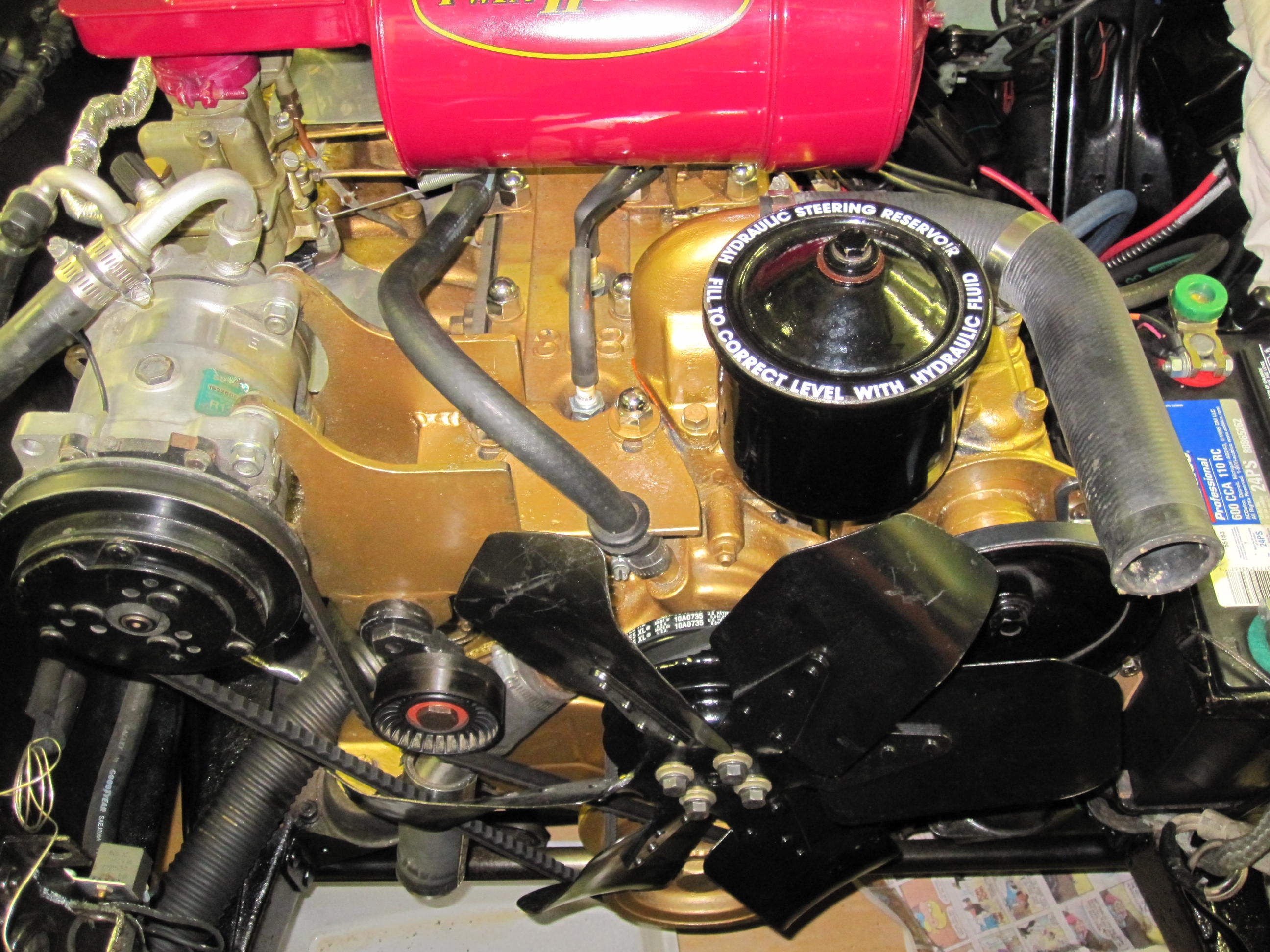

Do you know what the fan you have used is off of ?0 -

The '54 and later fan blades had curved ends which actually shifted more air, and were much quieter.0
Must be what I have, Geoff, after checking my photo above!!0
No Richard, you obviously have an aftermarket fan. The -54 blades were only 4 blade, but were not set at right angles, thus improving noise due to harmonics, and the blades were bent straight at the top, if that makes sense, and curved inwards to an angle so that they sliced through the air much quieter. You should not have any trouble overheating with your set up though.0

The picture shows an older 4-blade Hudson fan (bottom) compared to what Geoff described (top). The "tweaked blade" style does move more air.
