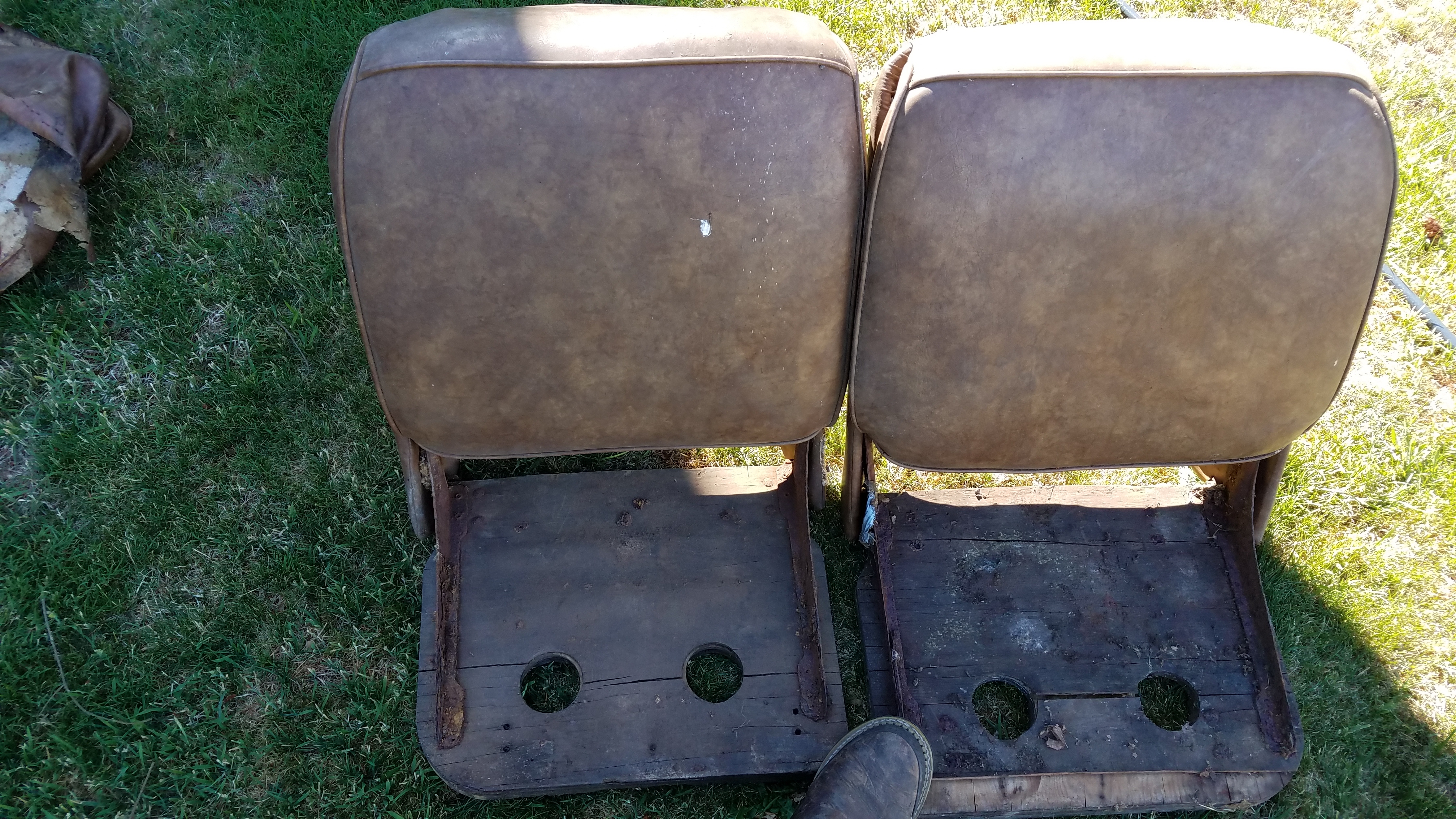

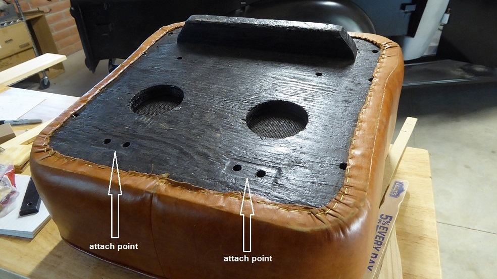

With the rusted state of the original floor, it was not apparent how the seat cushions secure to it. Towards the back of the plywood bottom of the cushion (the wood is original), there are indentations from a previous metal bracket having been attached (see pic 2) but those parts are long gone. The Hudson engineers were pretty clever on how they did things, especially making a pickup out of a sedan, but how the seats attach to the floor is not very obvious. If anyone might know how the bottom of the seat cushion attaches to the floor, it would be greatly appreciated. I've attached a couple of images to help describe the parts. Thanks!

They hook in the back wall with 2 metal pieces that insert into to hole in the back wall and two pieces of wood screwed into the floor where the seat sits on top to prevent it from moving my two cents0 -
That’s the same way the seat is mounted in the 46-47 pickup. No seat tracks or adjustment.0
Those seats look like sedan delivery / panel truck ?0
Looks to me as though the seat bottom has small flat metal bracket pieces that slide forward into loops mounted to the floor panel and the seat back may mount to the cab back panel vertically in a similar manner. The seats would not be adjustable however. I have seen similar mounts in other applications0

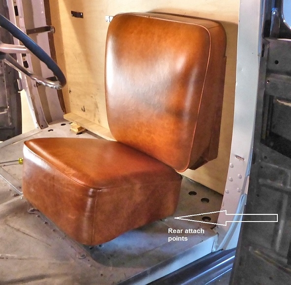

To finish up this thread, I am attaching a coupe of photos which show the correct attachments for these seats to the floor. The section with two holes fastens to the rear part of the seat cushion base, and the single hole fastens to holes in the floor. These are original and have been powercoated. So, one less Terraplane mystery.
