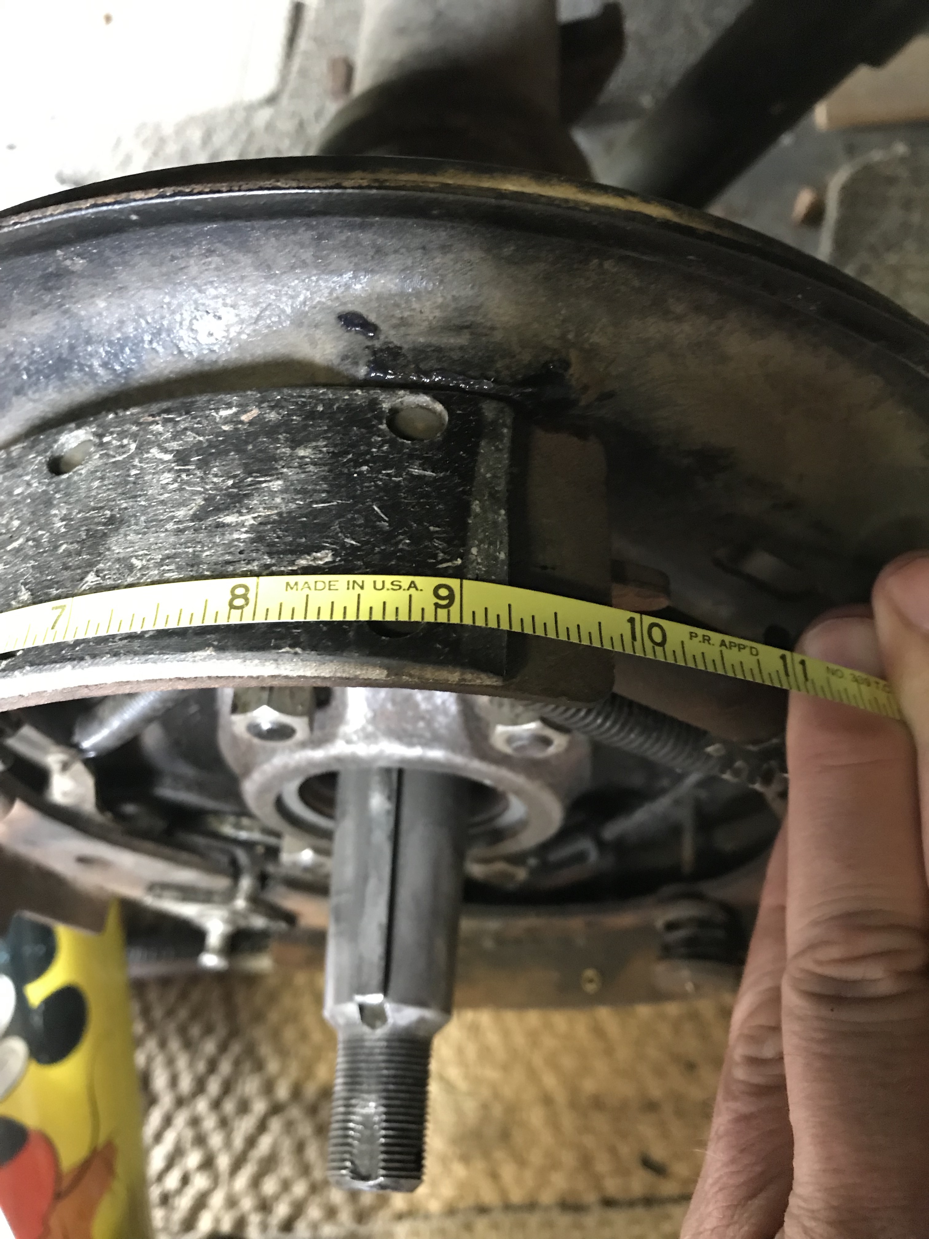

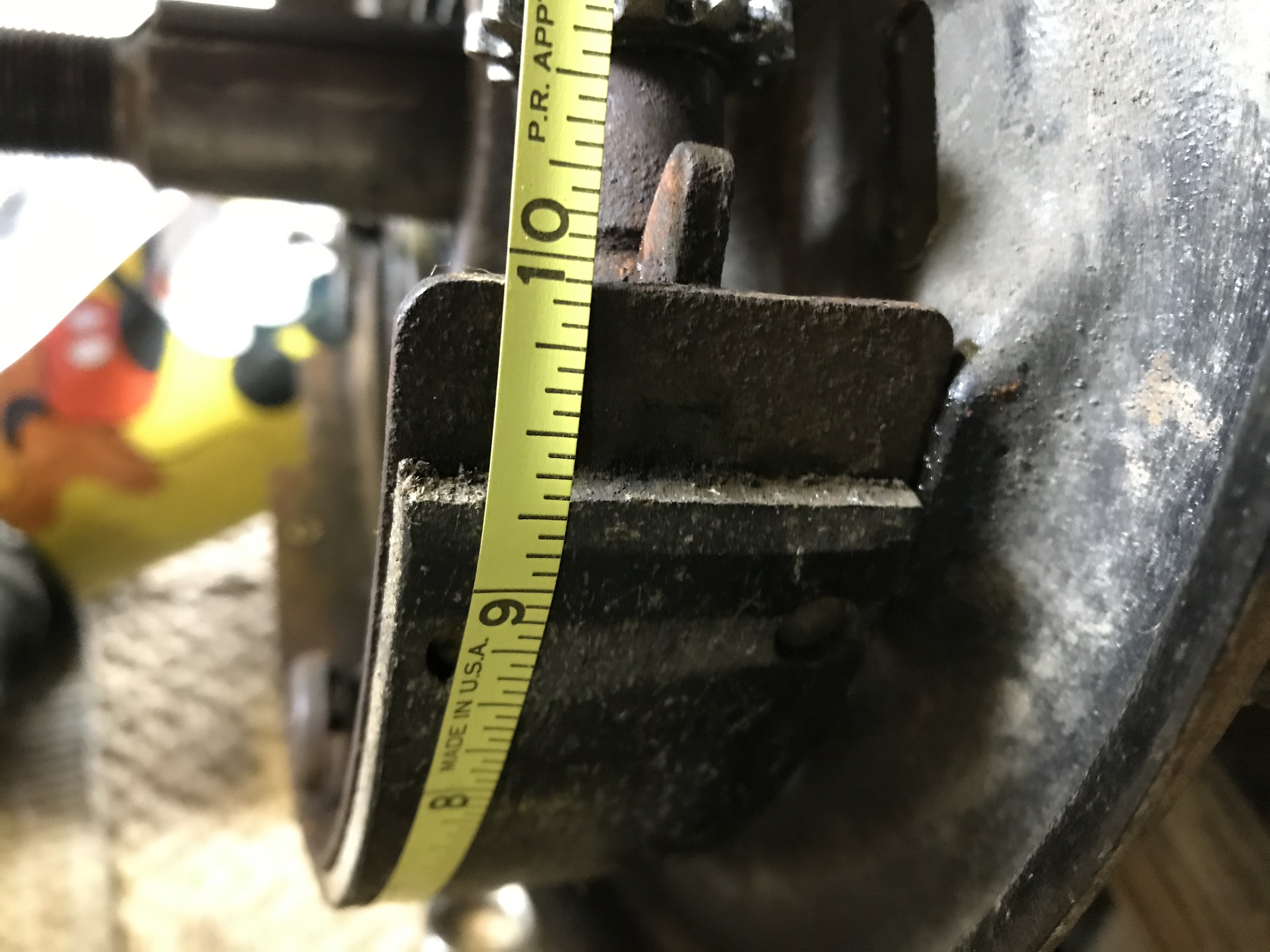

After doing much reading it appears all four wheels have to be adjusted as described in various sources I have. Is this correct? I’ve been trying to get the shoes centered on the right rear wheel only but with no success. The 0.010 clearance is good most of the way around except at the anchor pin ends. I have not disconnected the cable. Can anyone provide any insight into adjusting just one set of shoes OR is this not possible?
Are the primary and secondary shoes the same length? The ones on my car are nearly the same.
Thanks for any help
Tom
Disconnect the cable as a starting point. then set the anchor pin and eccentric adjustments, then re-connect the cable so it does not pull the brake on. the rotary equaliser should be right back against the stop.

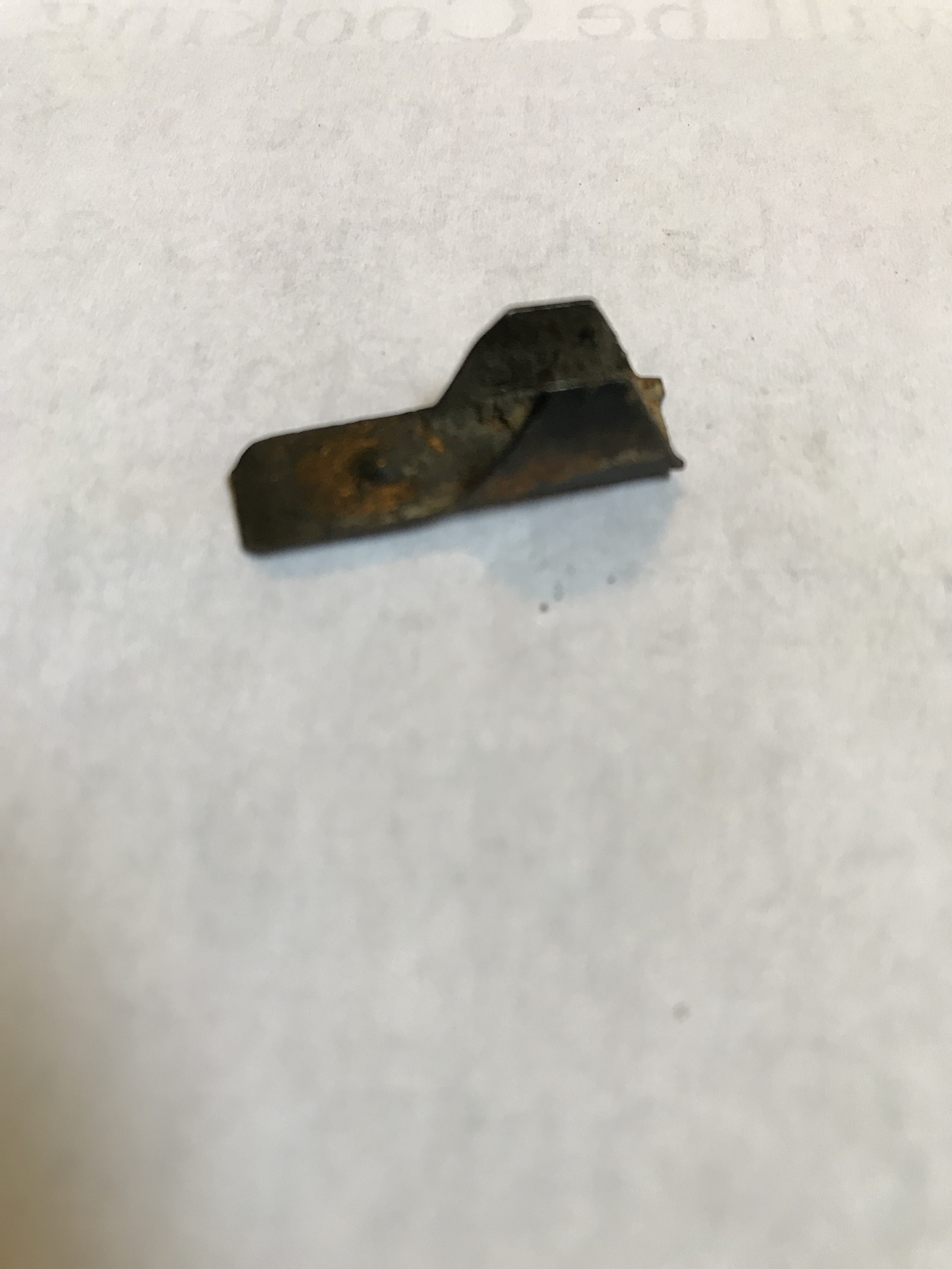

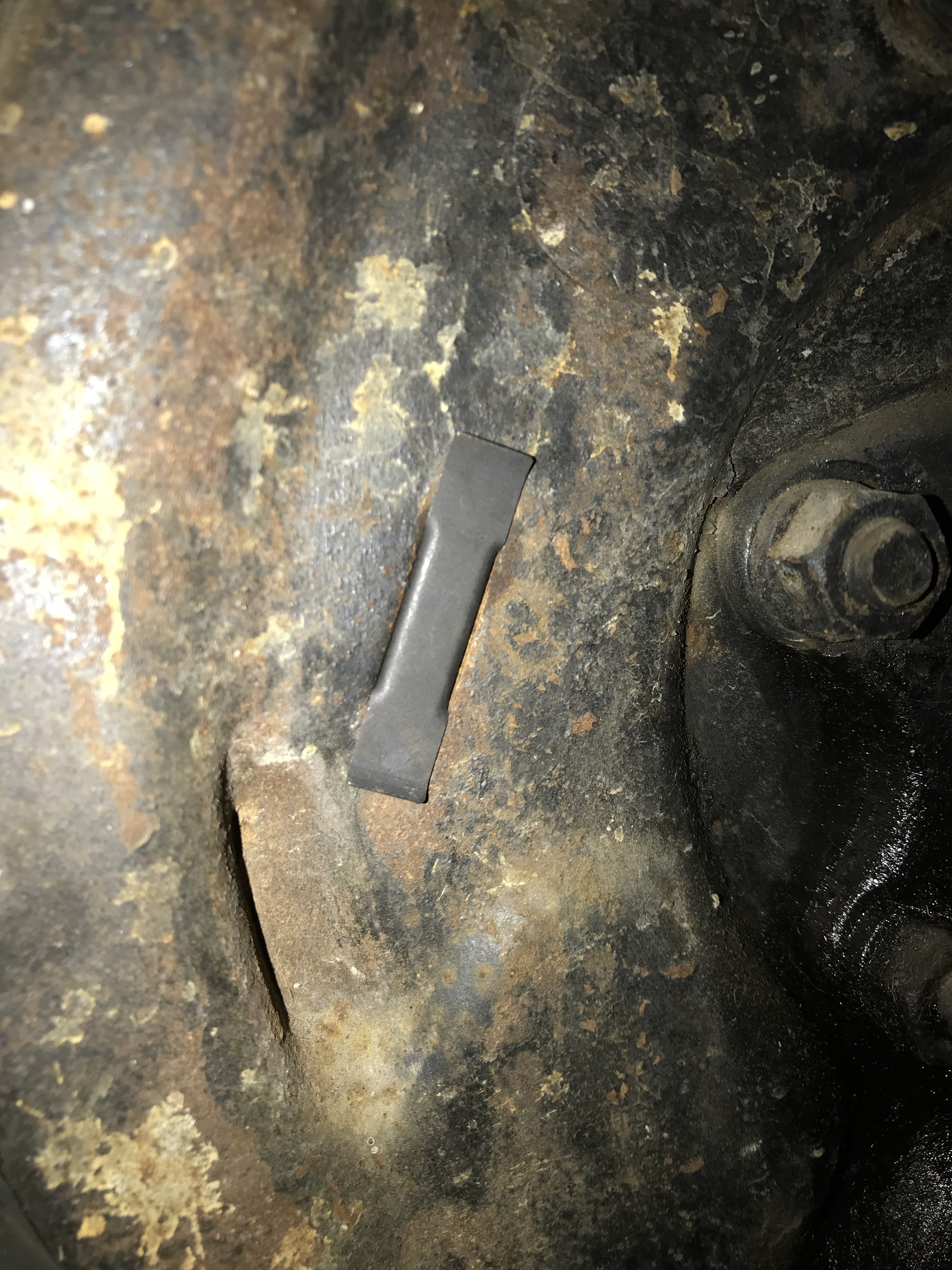

I think I've got it. One more question. Does anyone have or know of a source for the spring covers for the star wheel adjusting hole in the backing plate. I have one broken one and one missing.
Thanks Tom0 -
If they don't have to be a 'spring cover' you may be able to get a rubber plug the correct size at the local auto parts store.
Jeff
I'd posted the question about the covers on the face book Terraplane Seven forum. Lewis Mendenhall replied with this eBay link. He indicated the early Corvettes used Bendix brakes, the same brand installed on my car except by the 50's hydraulic I'm sure. The part shown looks like the ones on my car. I'm ordering them and will report back on the fit.
https://www.ebay.com/.../1953-1962-Corvette.../1517853621...
