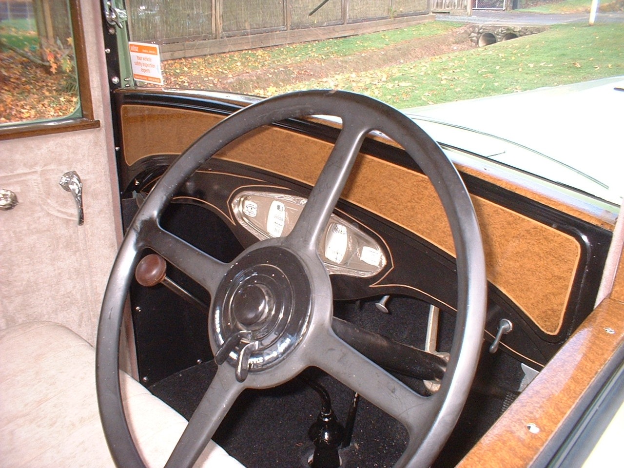

That chassis number indicates it is an early series 1928. The dash panel and window surrounds were originally wood grained, and upholstery was cotton velour, with leather as an option. Picture is of a 1929 dash, but '28 was identical.0
