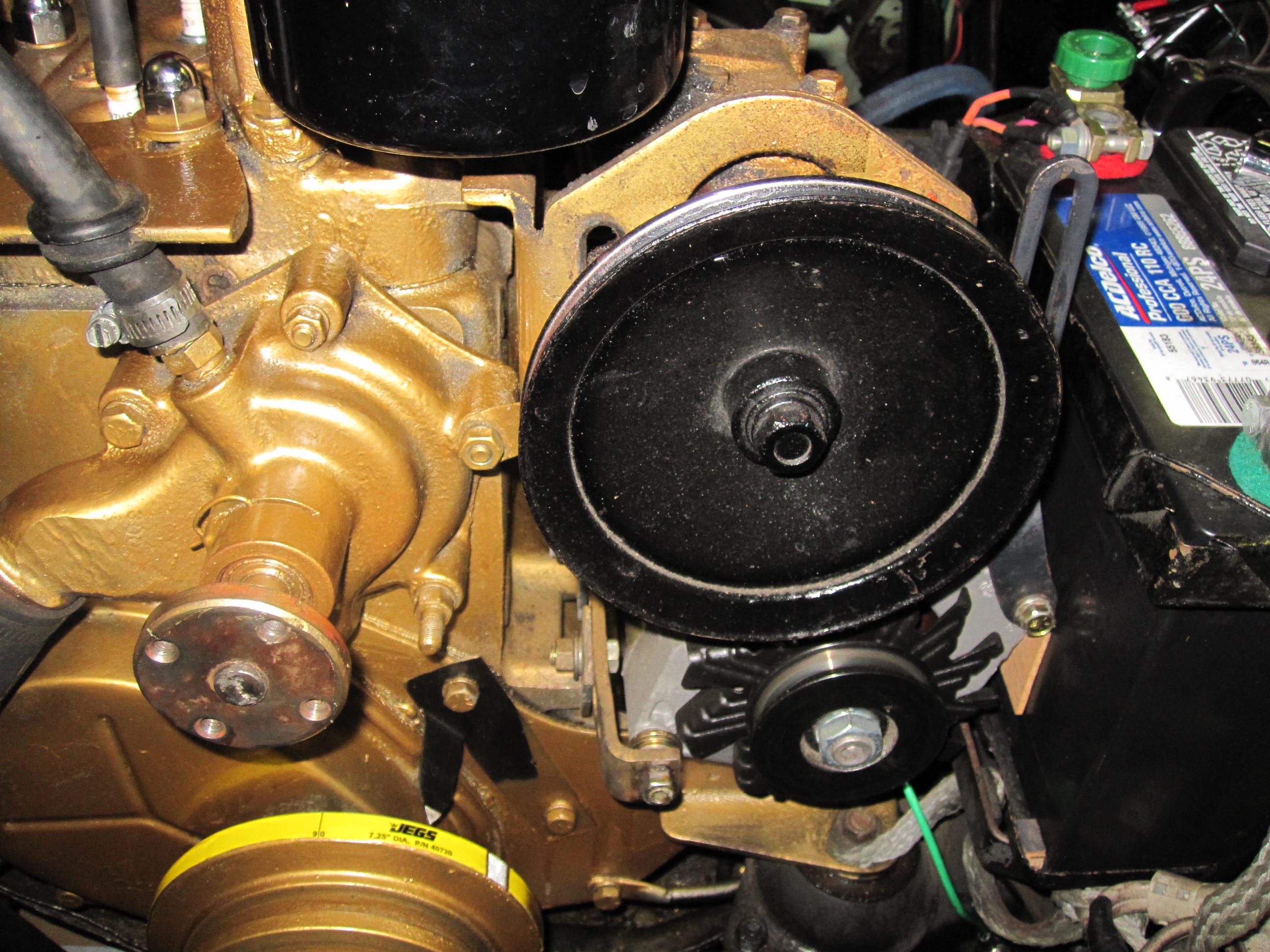

I am using the smaller belt on my car. The Alt. pulley is about 3-3.25" in diameter, I think. You will need to be sure your alt. pulley is lined up with whatever is driving it. I have a/c & power steering and I had to take 2 WP pulleys and weld them together to have ratio and line up I needed. Anything can be done. Also be sure to have 'swapping' permission when you get one. Also you might have to change belts 2-3 times to get the correct one lengthwise.
My Alt is located below the power steering in the photo {click img number to enlarge}.0 -
