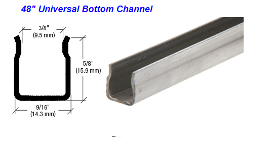

Ok, I get it. I would think that would be available from a Ford restoration supply in lengths that you could trim to fit your application. Just a "U" shaped piece that you could weld onto your window regulator slides. Then, you add the fabric tape. Glass should never touch metal.
Fliptop, I have Window setting Channeling, 24" $10.00 ea. , 32" $13.00 ea. If the brackets are not rusted you can remove and replace on the "Window setting Channel"0
