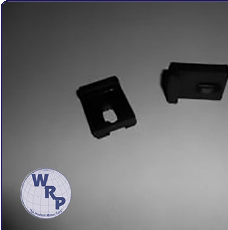

When I did Ivan's 1933 I made some rubber parts that I couldn't find. I don't think Wildrick has these. Check with him first. The first picture is the door catch rubber that the dove tail goes into. The second picture is to go into the corners of the windshield frame work. If you open your windshield and look at the A-pillar inside where the windshield would close against. In the bottom corners there is a vertical slot about 3/16" wide and 3/4" tall. Those slots would accept that L shaped rubber. Keeping the windshield centered and from rattling against paint when closed. I am guessing that '32 and '33 are the same. Maybe someone can confirm that?
Yes bent metal. '32 and '33 are the same. For some reason the parts book says the closed cars (like my '32 coupe) take 2 rubber windshield bumpers, while the open cars take 3. Do you have these extra rubber reproductions for sale?0
I can't imagine where the third would go? Must be right in the center? I made the rubber parts I couldn't find. These were for a 1933 Terraplane Eight Convertible. I did end up with some extra pieces that I would sell. Call me at my shop and I'll see what I have left.
