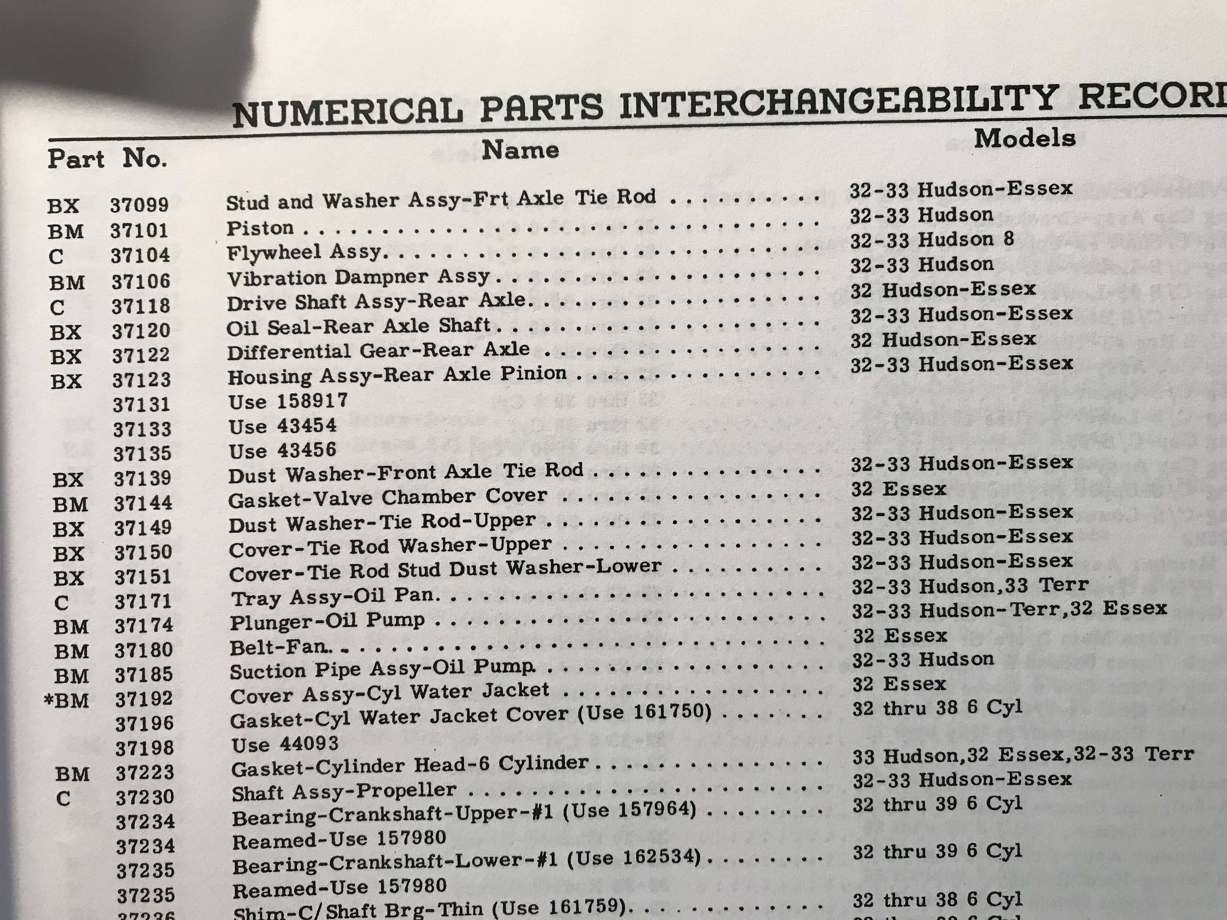

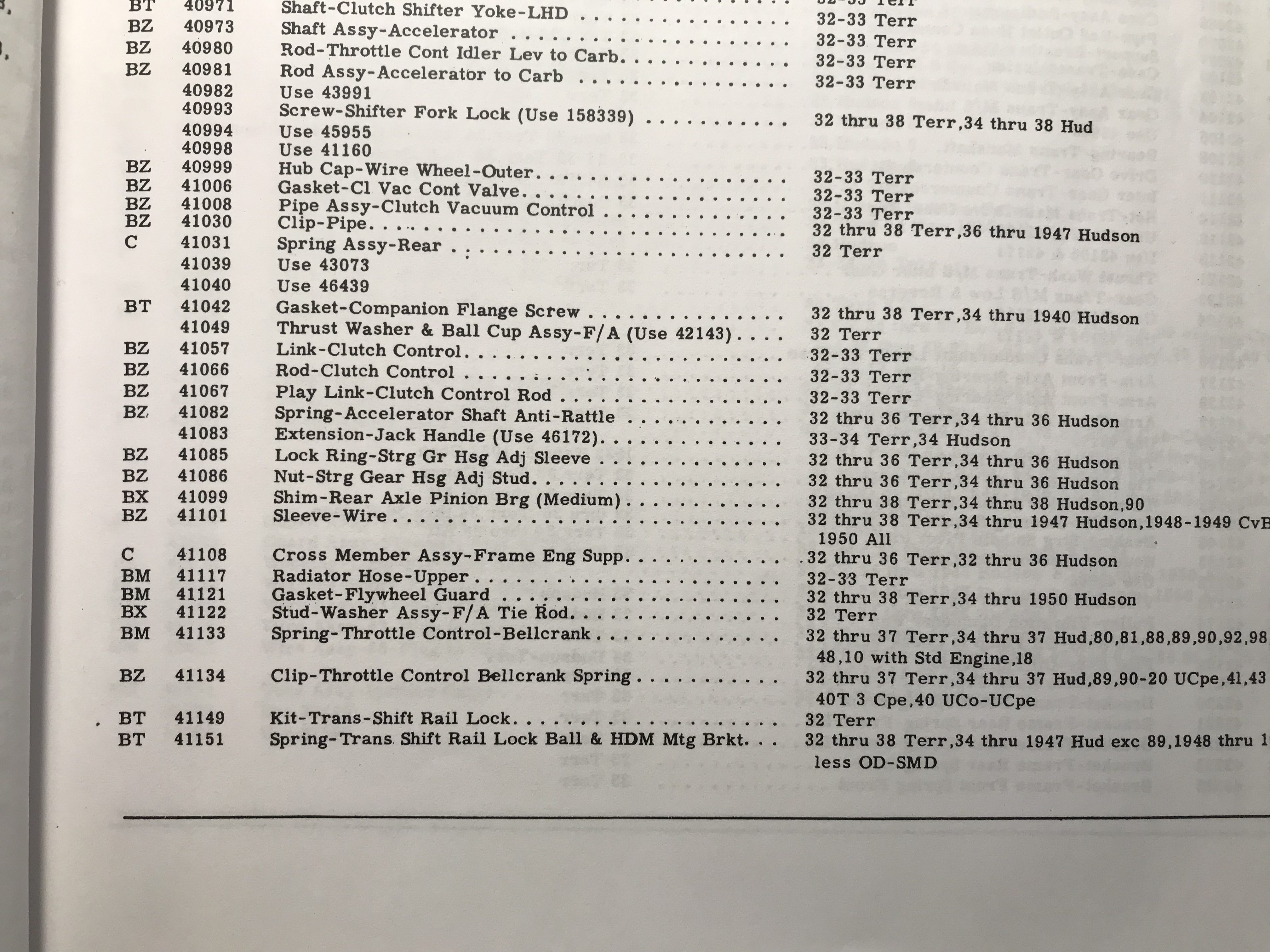

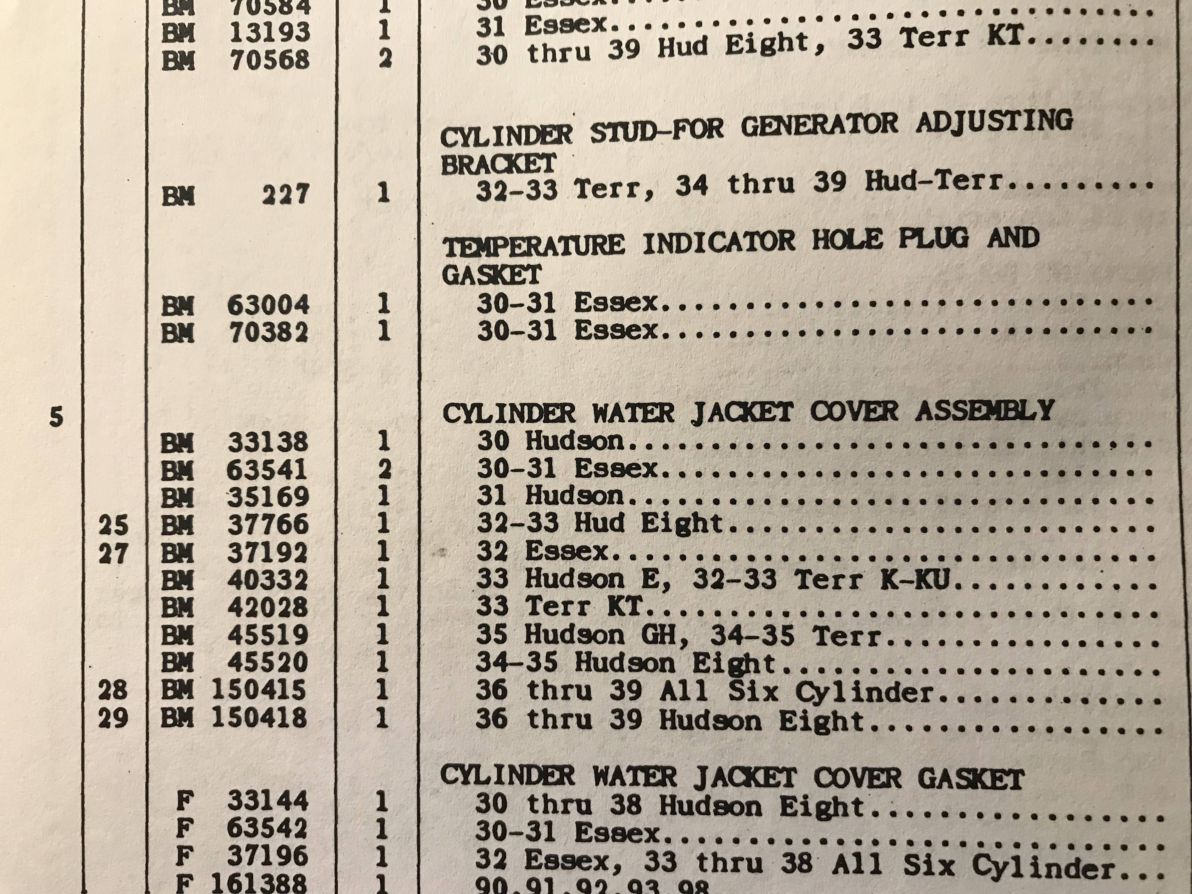

For reference, from the 1930-39 Master Parts & Interchangeability Books.
It appears to be unique.
I notice in your pictures the stamping of the top surface in the area of the inlet nozzle is slightly different.
Could be thats all it is, who knows.
Tom0 -

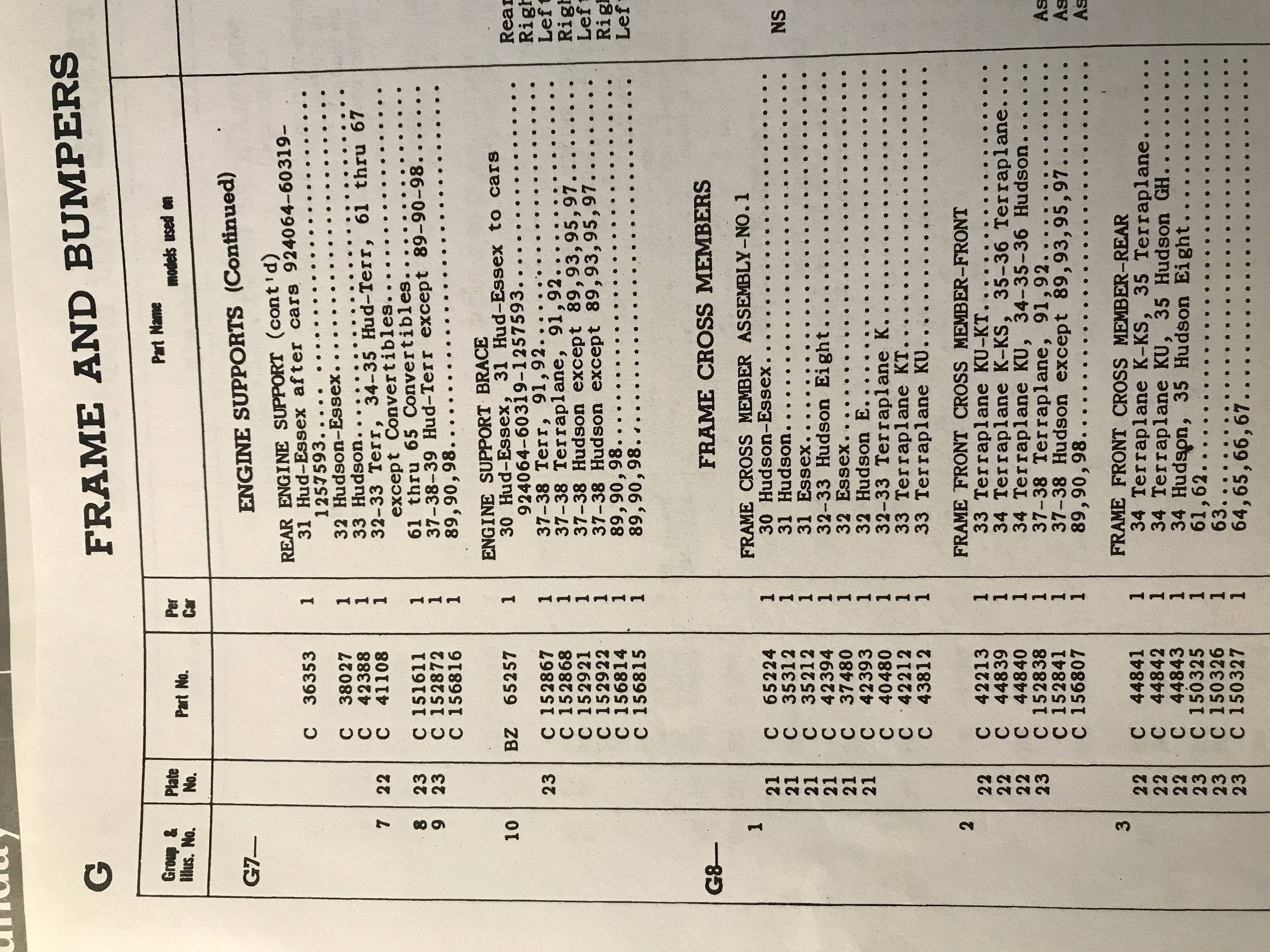

Tom, it could be that my replacement is aftermarket, and thus not exactly like OEM. And what is Hudson E? Some odd listings, the parts books are full of more questions than answers!0
Scott,

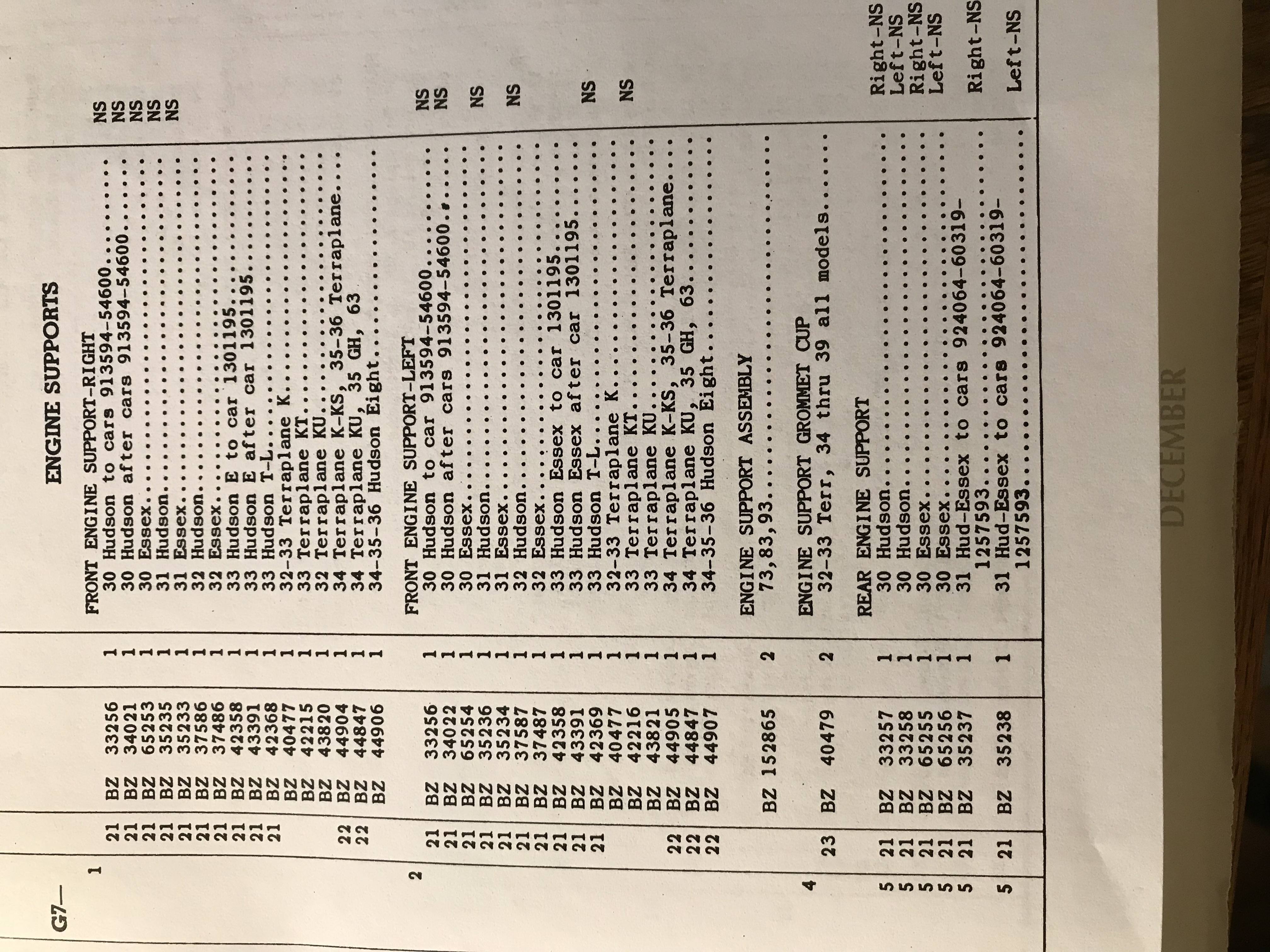

Per our call.
The attached shows the rear engine support the same for 32-36.
There is no graphic for these parts numbers.
Tom
