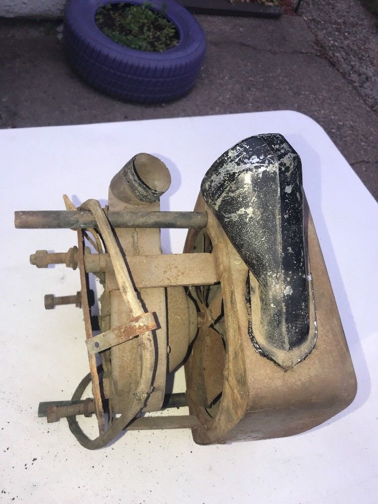

I know, info like that may not exist. I bought another heater like the one I have (for a spare) and was looking for tech info as I don't know if it runs. But for $12.00 I couldn't say no.0

It does, when out and you apply direct power. I checked voltage between switch and heater and received voltage indication. I then checked the switch and found it to be bad. I got a know good one from Dr Doug. Still no dice. So now I wonder if the motor is grounded? I'll have to pull it back out and see. I plan to use the one I bought as a spare or for parts if need be. Not sure if it runs but will bench test it when it arrives. But it does look complete and has the "horn" on the side for the weather master.0
Got the heater in my car working today. After months or messing with it I found that the ground wire was connected to the fuse block. I moved it a ground and what do you know. Works as advertised. Not sure how that got wired that way but problem solved.0
So that spare heater I bought does not work. I believe the motor to be bad. I will have it rebuilt. and a new wire harness made for it. I have it all apart except the fan is still attached to the motor. Any advice as to how that comes apart?0
