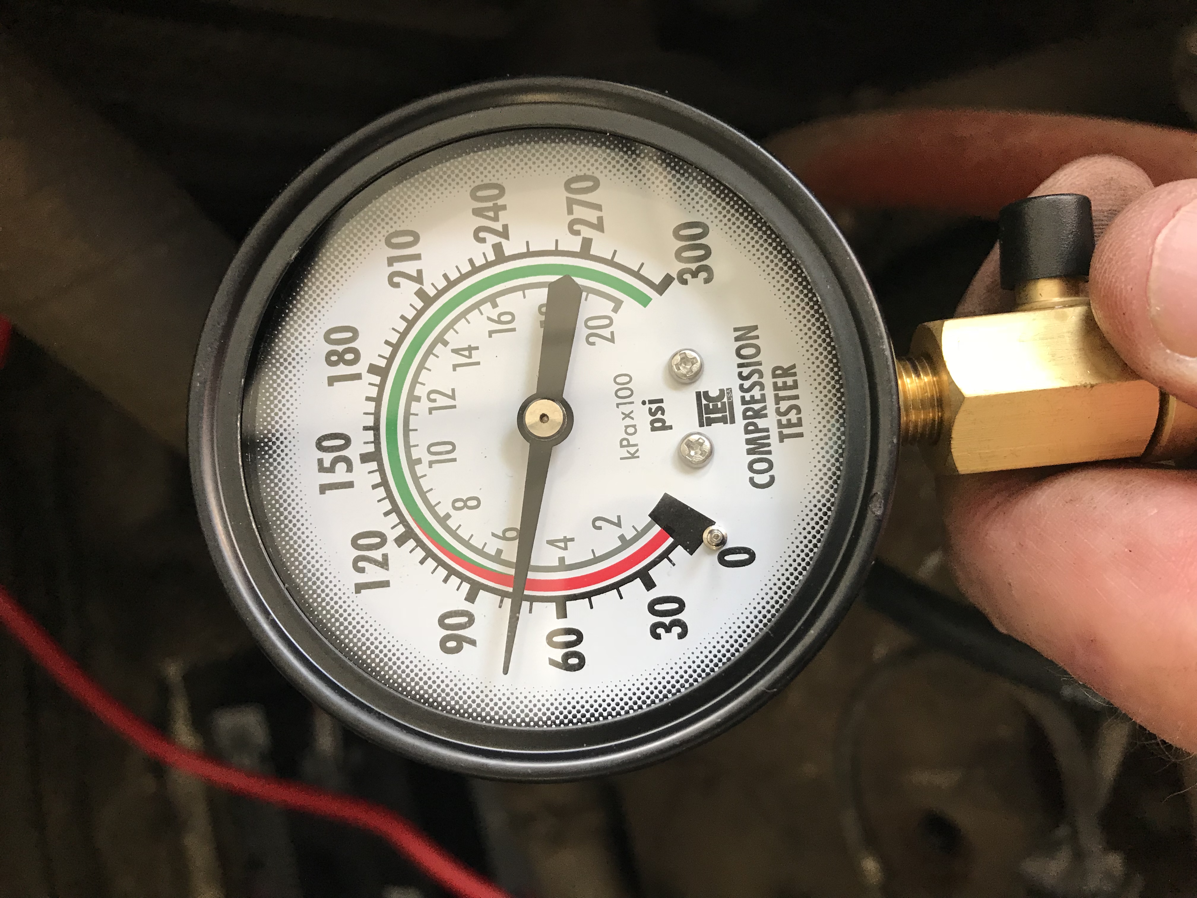

Update on the car, today since getting car two months ago, installed battery and the engine cranked and cylinders had pressure. All had 70 plus (spec is around 108 I think) and carb was not wide open so life in the motor, I’m thinking yes.

Even though a little low reading as long as they were within 10# of others you should be fine. Actually, after running awhile pressure may come up slightly.
