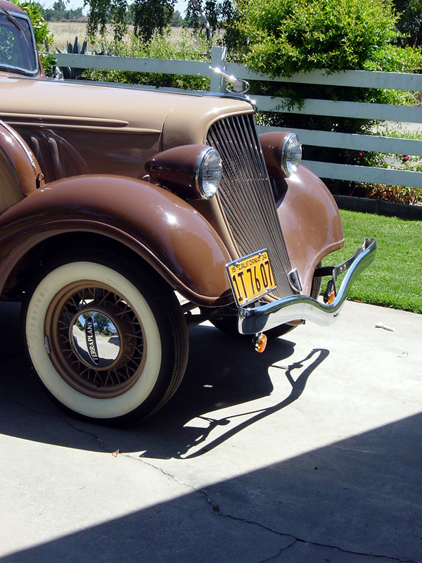

When I got it in 1973 it had sealed beams on it; they had just replaced the headlights with an aftermarket sealed beam bucket unit, sometime before 1950, when the car was shut up in my grandma's garage. I eventually replaced with circa 1937 or 1938 headlight bucket with sealed beams (see picture) - looked good and I never had anybody mention they were not original. BUT, in the end, I went back to the original headlights with re-mirrored reflectors etc. (and also took off the wide whites).
