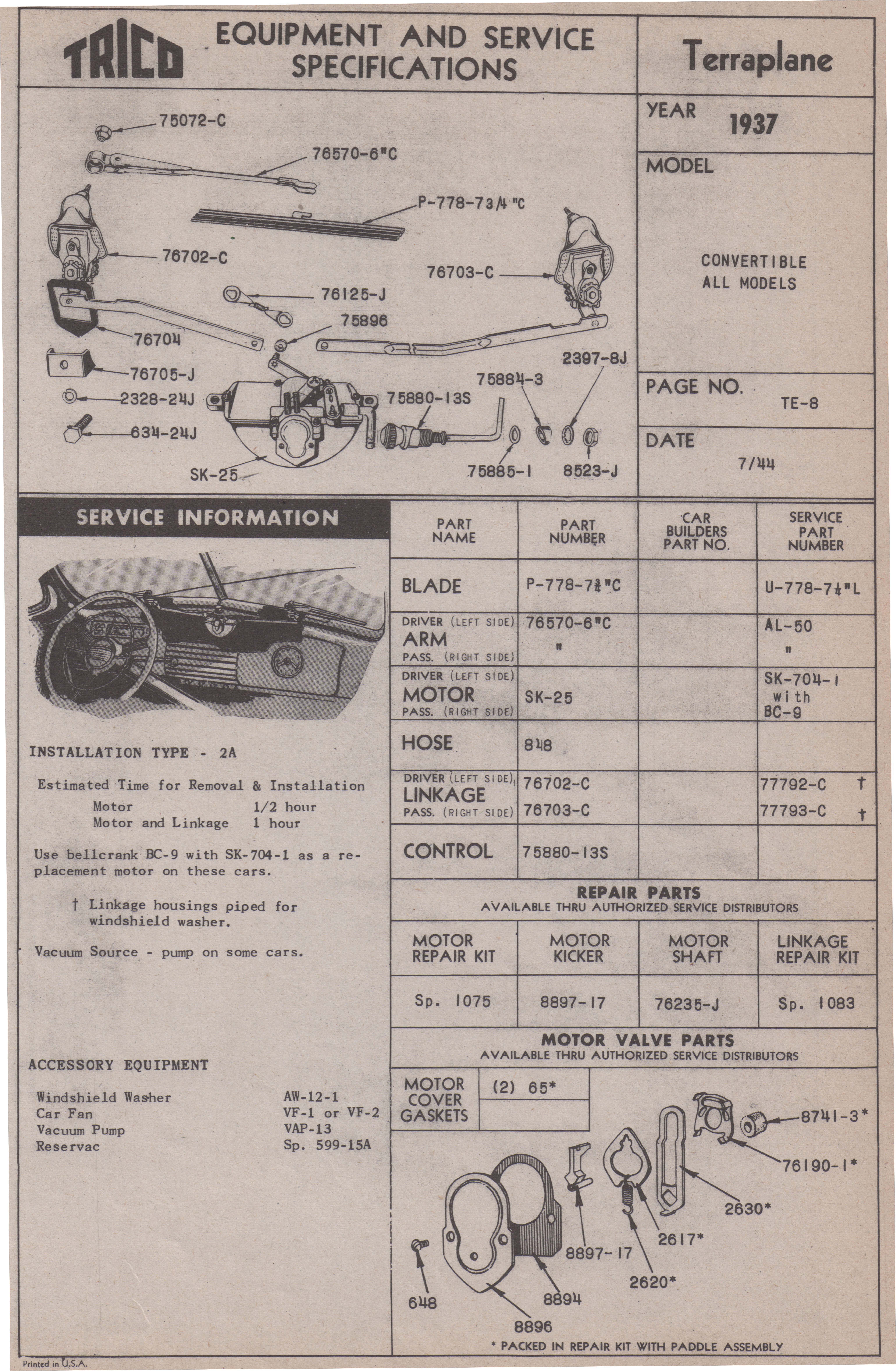

No, the original Trico number is SK-25.

There's a possibility that the motor body has warped over the years and you cannot get it rebuilt. The re-builder should tell you, if that's the case. Then you should shop for a NOS motor. In fact, start shopping now (Ebay's a good source). It may cost you as much as $100 to rebuild the motor so if you found one for $50 or $75 it would be a bargain. I think that Trico made some "replacement" motors that fit a number of cars, but I don't know the Trico number.0 -
