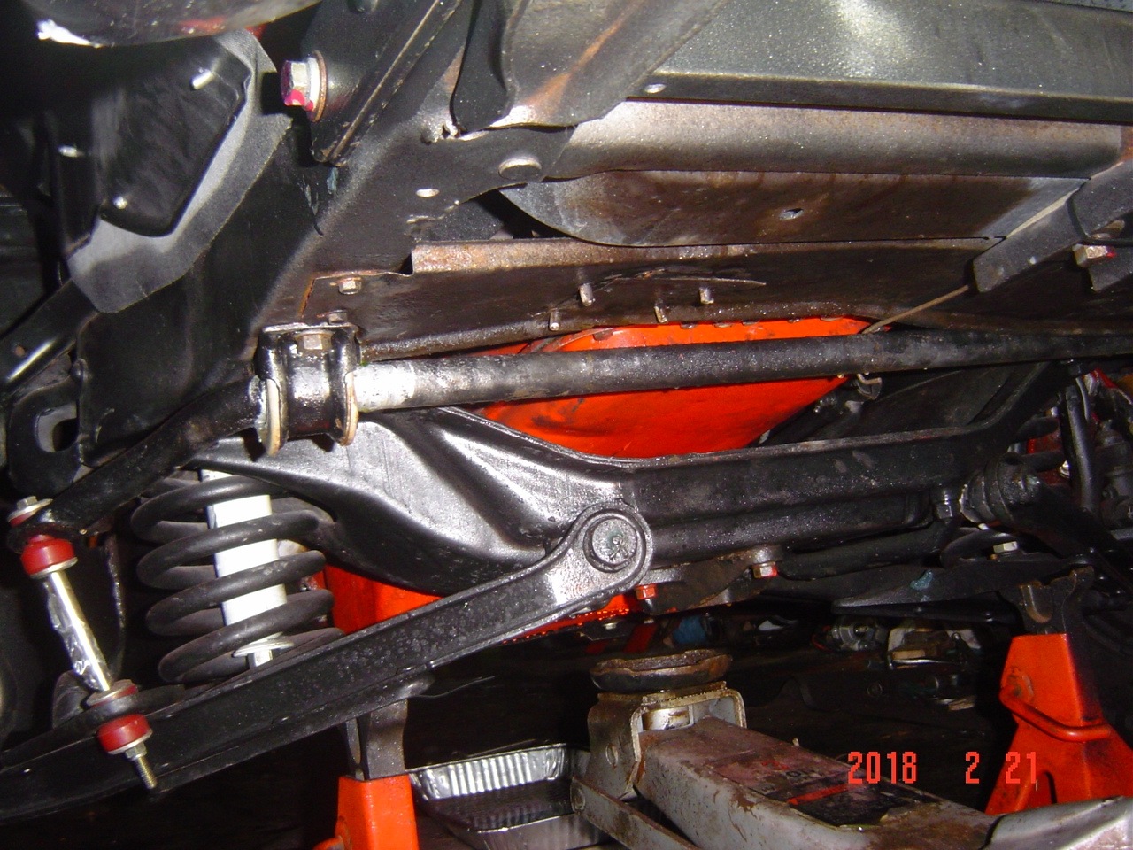

Working on the 53 still... runs good, stops good, not unhappy but, getting through the corners can be a bit disconcerting... lots of body roll.
So... my question; Does anyone have part numbers or known swaybars that will fit, both for the front and the back ?

Contact Dale Cooper, he has heavier front swaybars which really improve cornering and handling. Not sure that anyone has a heavier rear swaybar.

the car came with good sway-bars. Make sure they're connected.0
The Panhard bar at the rear most likely needs new bushings. And as Uncle Josh suggested , make sure the front links are in good shape and tight.0

I have complete set of Polyurethane bushings for the stock bar. Used 200 miles before installing HD bar.$30.paypal
I have some NOS Original front sway bars. $50 plus shipping. Ed Moore0
Dale says new sway bars in stock.
What size at the sway bars ? Diameter I mean... front and rear.

Orig anti-sway bars: 3/4" dia; HD bars: 1.125" dia. No anti-sway bar at rear.
More than double the steel in the HD bars. piaresquare.0 -
