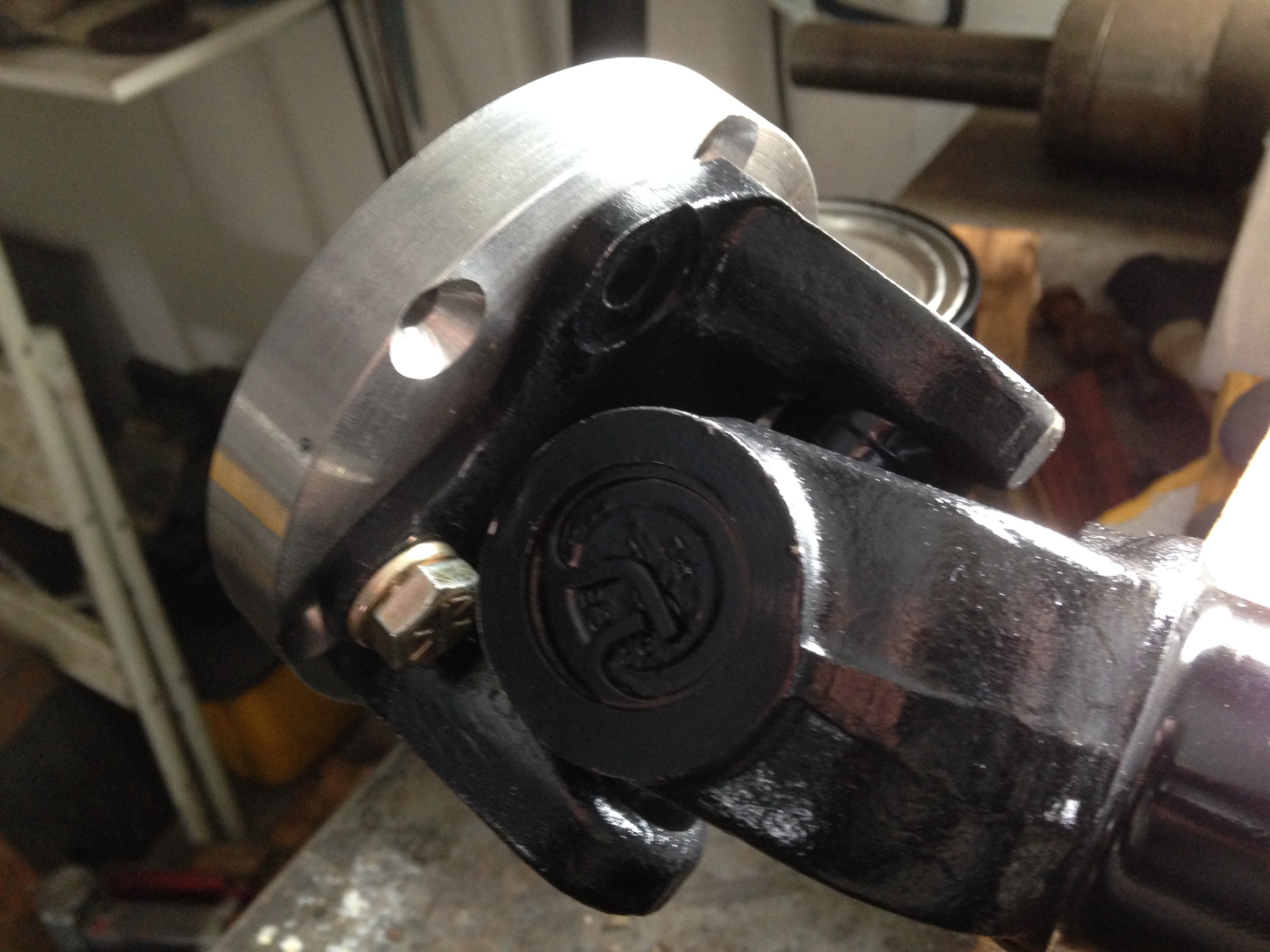

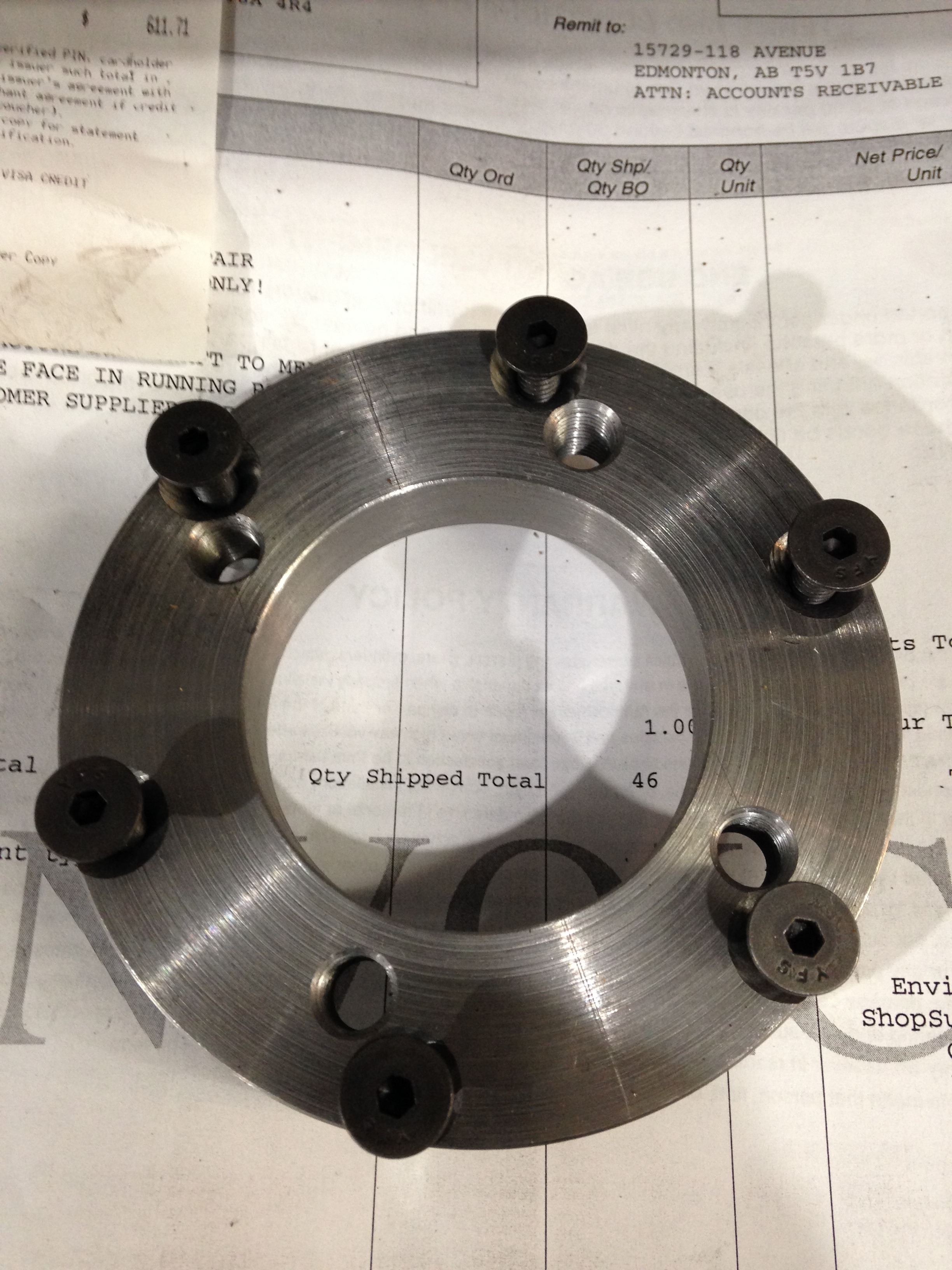

There are no direct modern replacement joints for these. Only option is to go to an engineering shop and get the drive shaft modified using modern joints.0
Does it mount to the trans. and diff. the same as a 1930 Hudson? I recently had one made.0
Yes, virtually identical set-up as 1930 H, just shorter length.0
Thanks Geoff, that seems to be the way I will need to go.
That's the ticket, I was making some from Aluminium bar.
