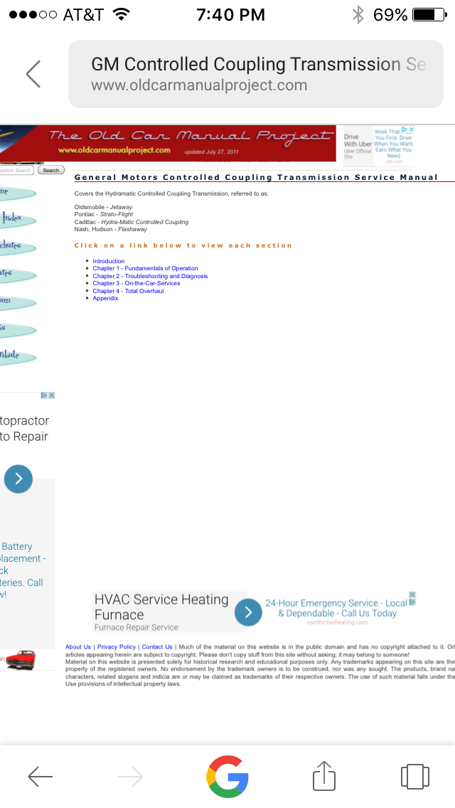

I found some information on this site called The old car project (Repair manual) . Apparently this Hydramatic was referred to with (4) different names depending on what make your vehicle was.
Attached is a picture from their site0 -
Blanket name would be "Controlled Coupling Hydramatic".
