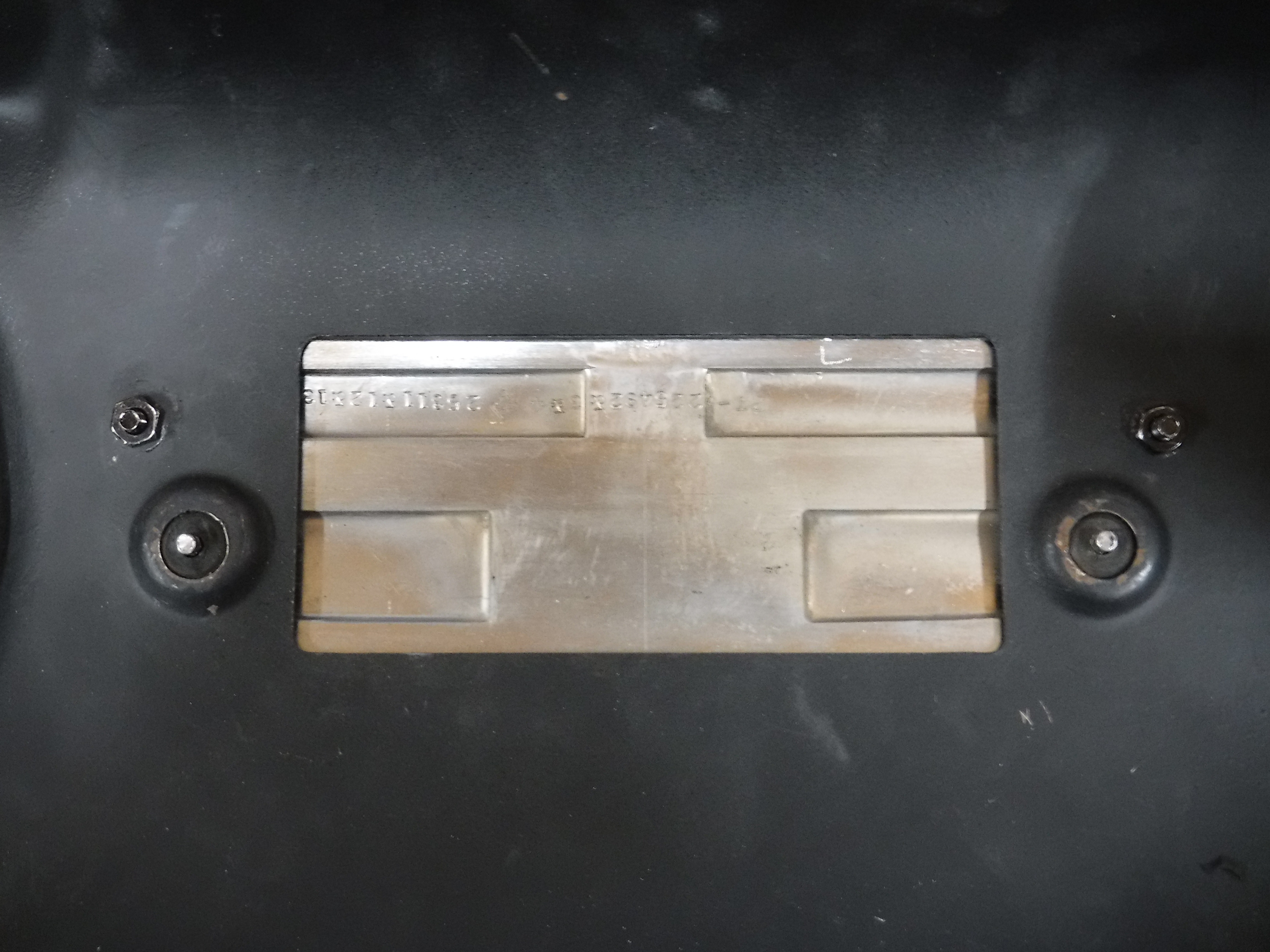

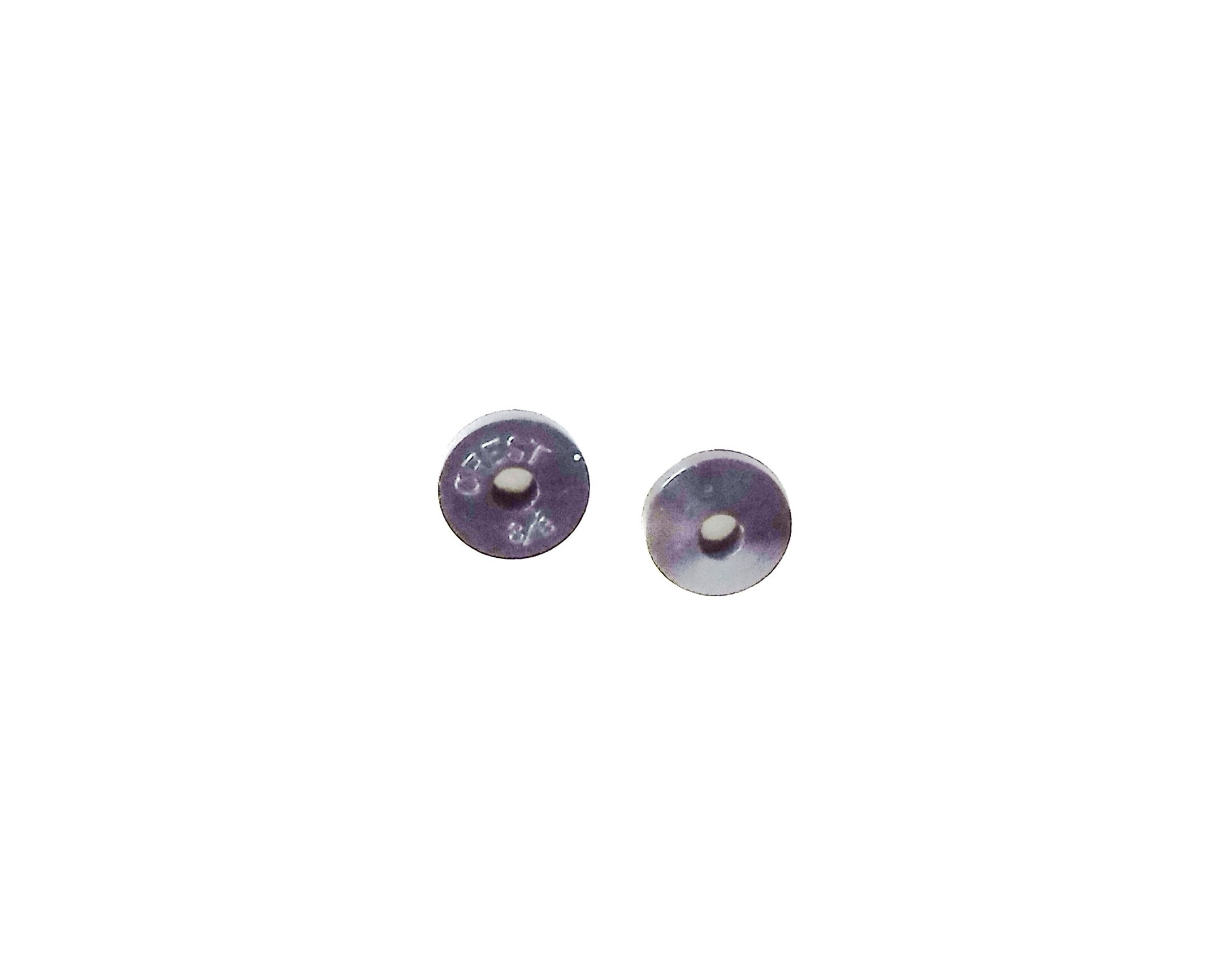

The 53 has recessed radio knobs which required that I find a way to keep the plate centered to minimize movement and provide good alignment with the surface of the dash. I fabricated two hard rubber spacers to fit between the plate and the bottom of the recessed holes in the dash. (I trimmed two water faucet washers, Crest 3/8” to fill the voids)
Using blue painters tape I temporally fastened the delete
plate with the spacers to the dash. Now

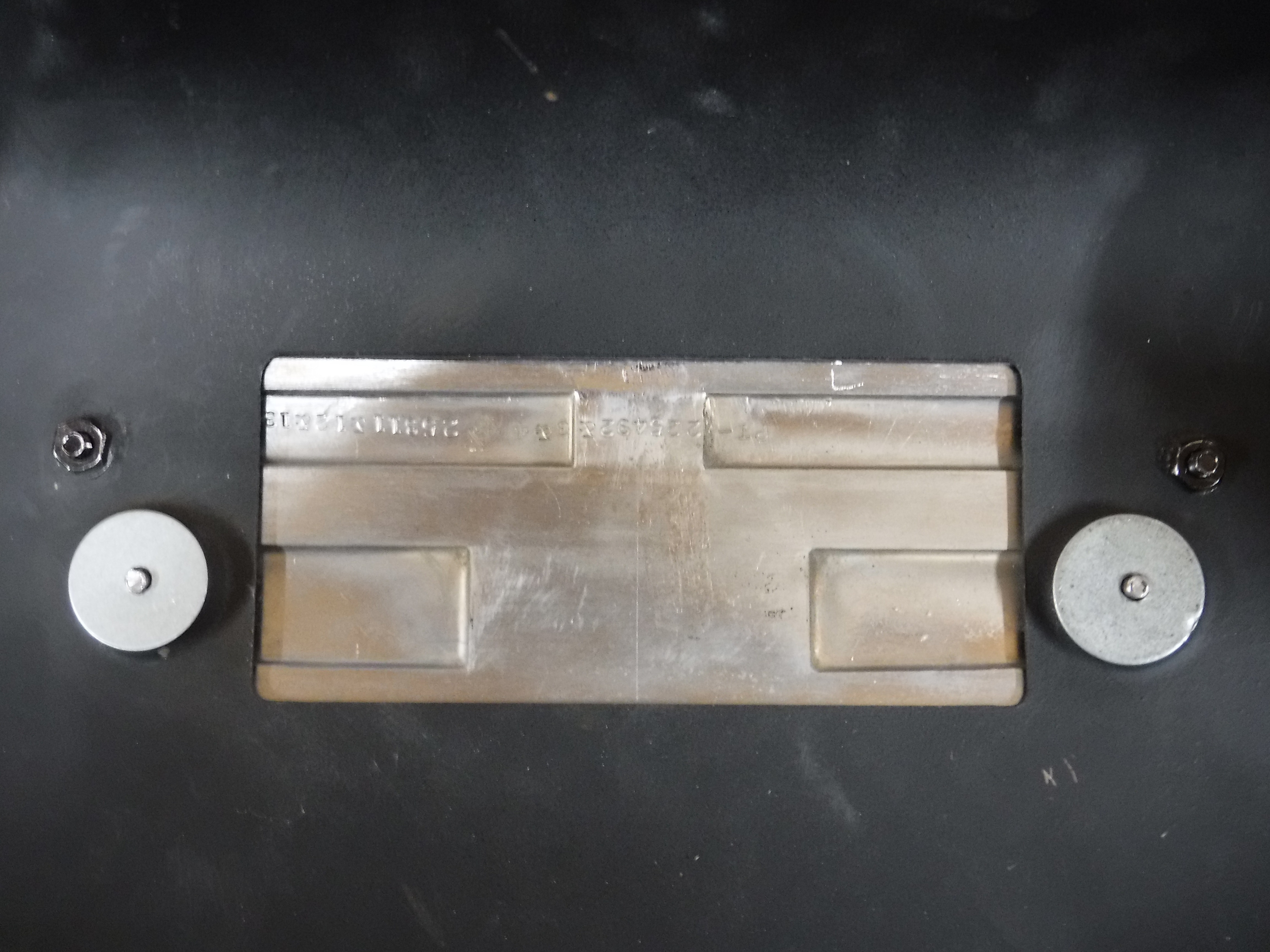

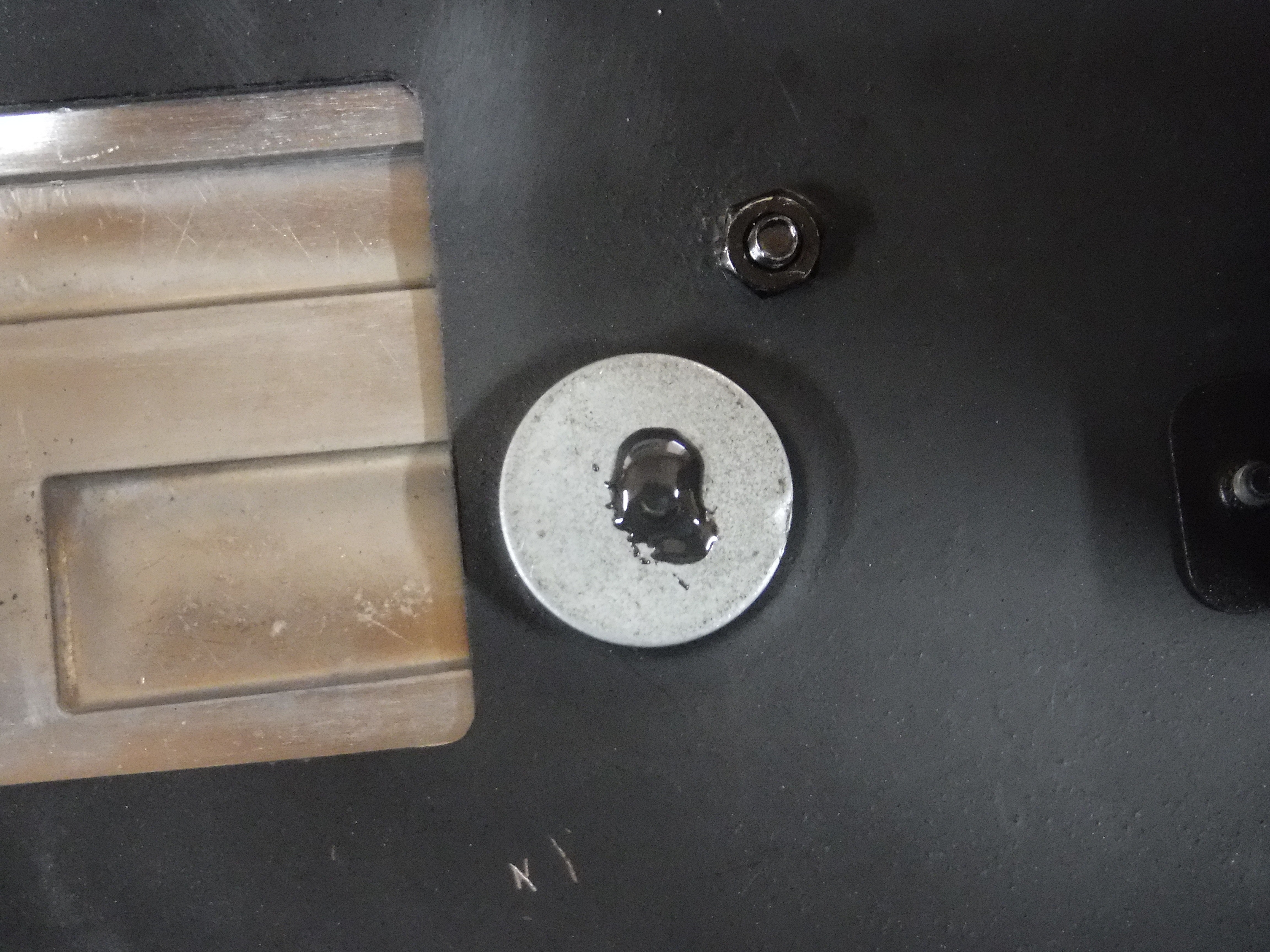

with the dash turned over I proceeded to install a flat washer over each peg
and using a drop of epoxy to fasten the plate in place. I now have a well
centered rattle free radio delete plate.
