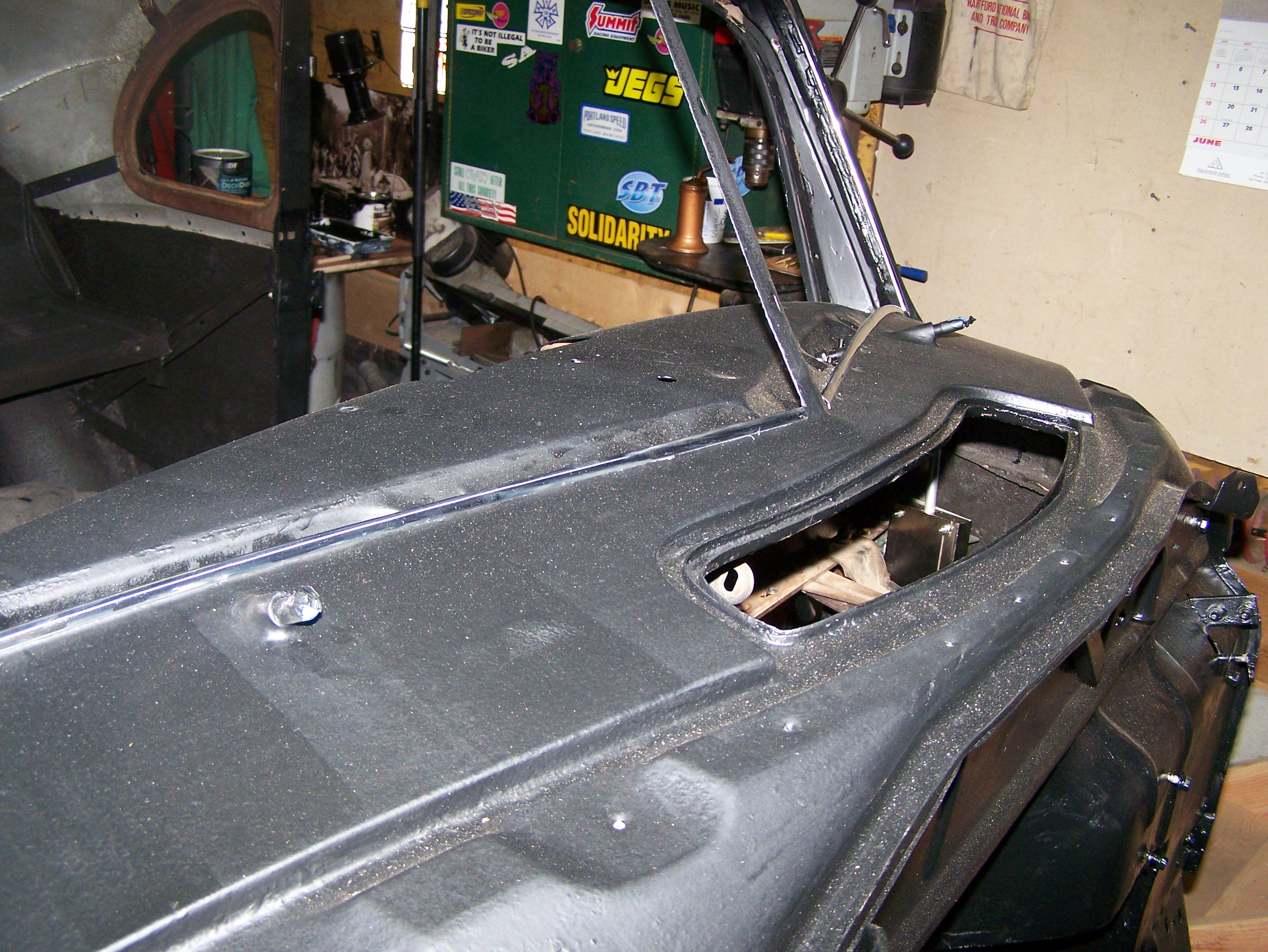

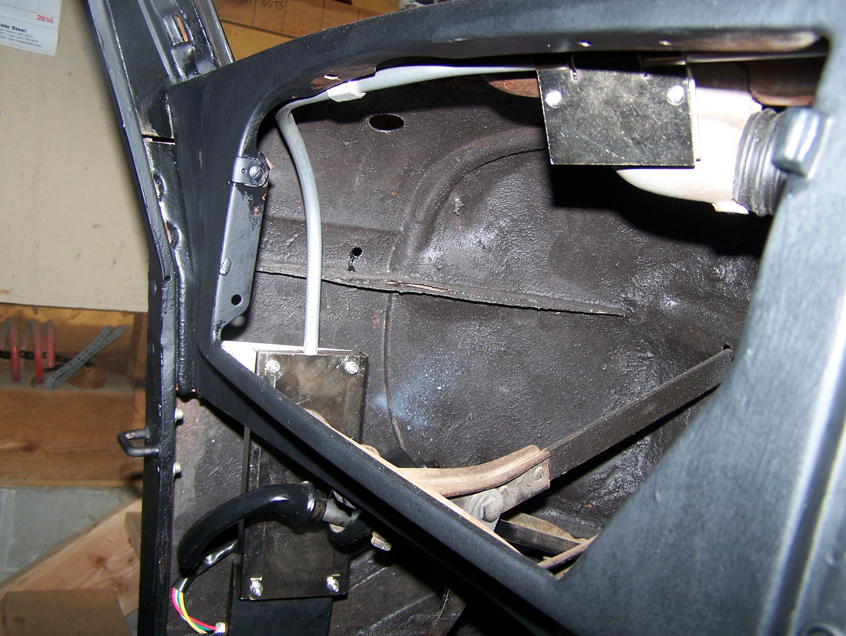

so after careful consideration, i was able to purchase an aftermarket electric wiper system with delay for $280 ... after receiving the parts, it was determined that the shafts would have to be installed through the windsheild defroster manifolds to maintain proper angle alignment with the glass ... i also had to lengthen the wiper drive shafts and bushings due to the increased length needed to pass through the manifold ... i have had it running for over 2 hours and it performed flawlessly
cross off another task from "the list"
