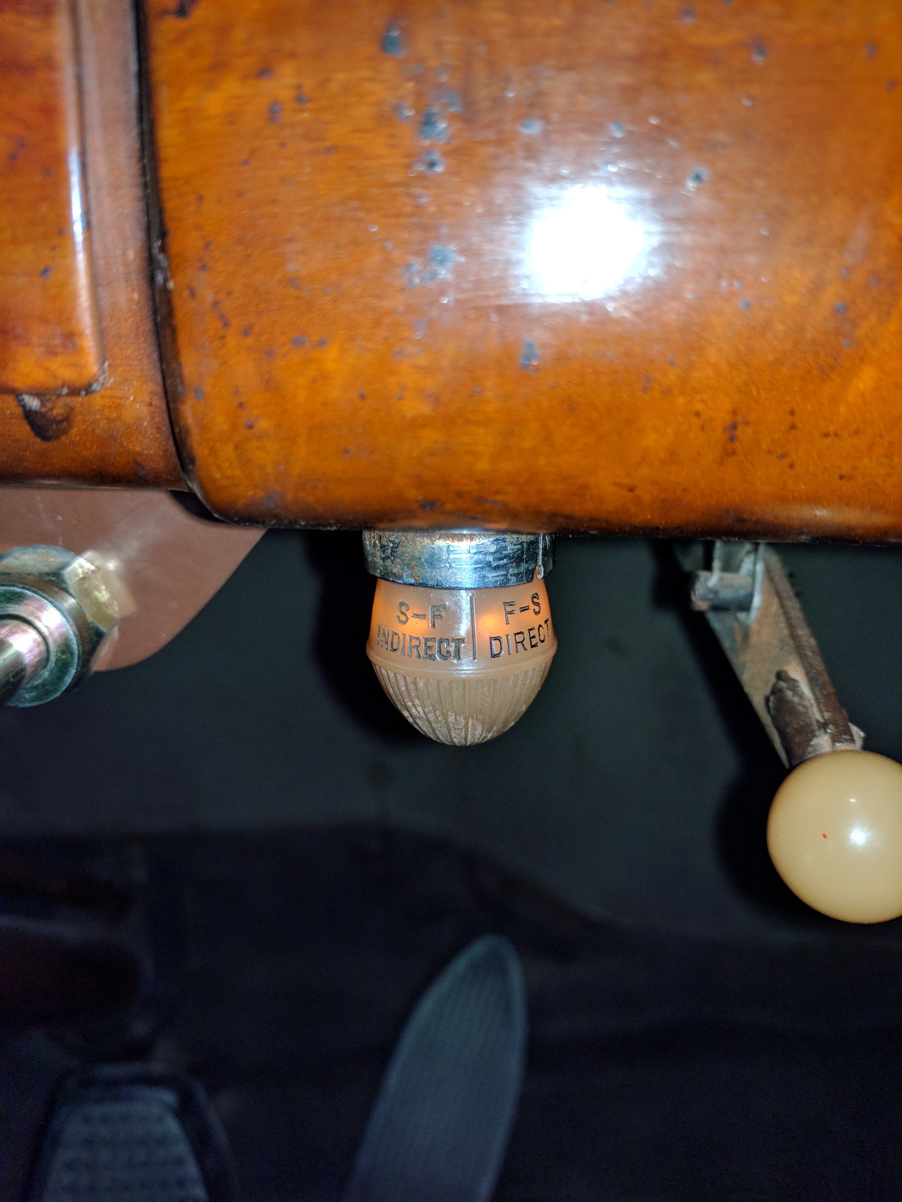

The heat/Defrost switch in my 39 is extremely loose. It goes around in a full circle and I don't believe it is making contact for voltage to go out to the heater itself as I show no voltage at the heater. Also the light stays on constantly. I believe
the switch itself is broken in the body somewhere. How do I remove it? I will attach a picture of it here.
the switch itself is broken in the body somewhere. How do I remove it? I will attach a picture of it here. 0

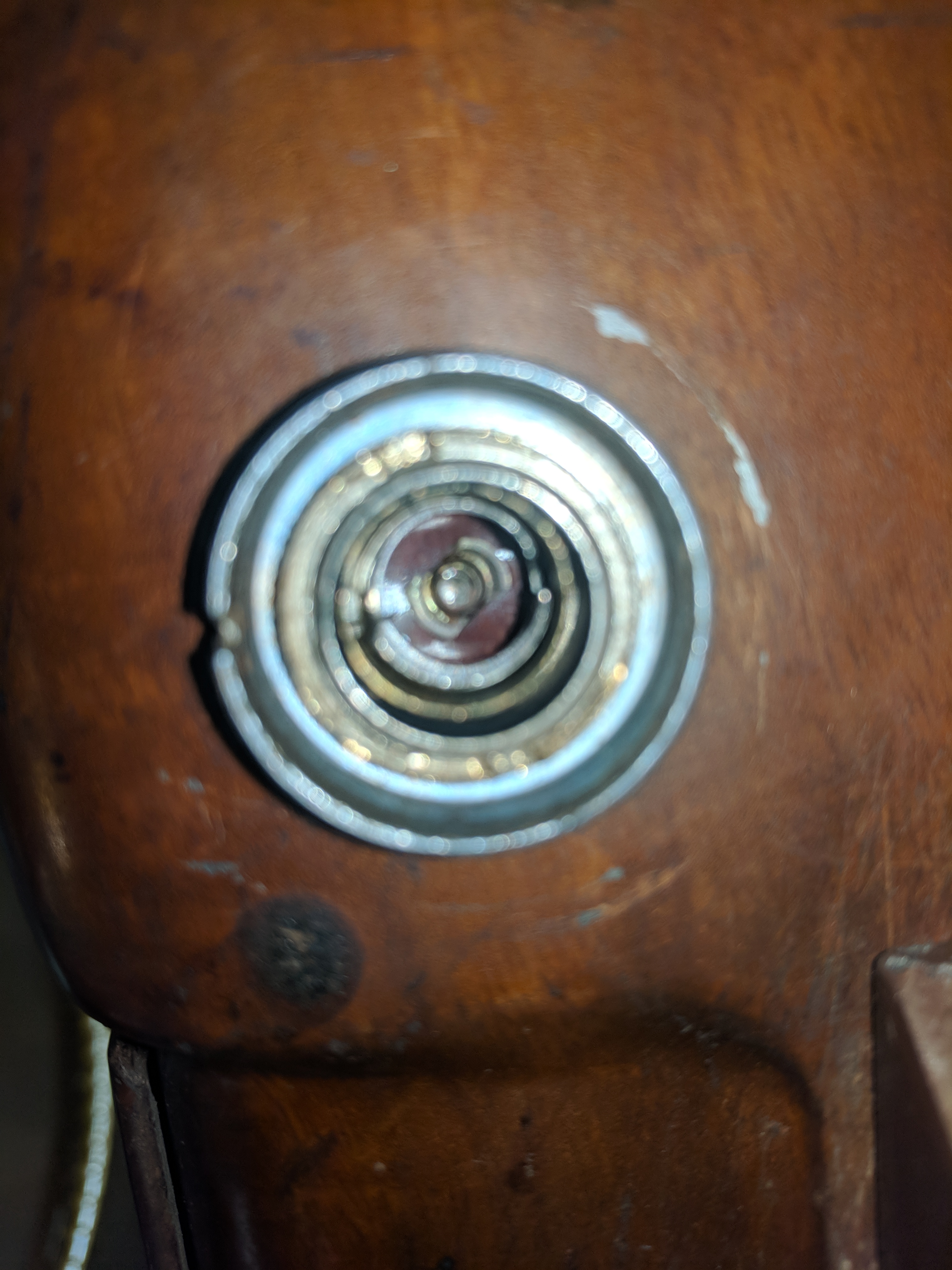

It's not a clear enough picture to give you further advice. Does it look like there is a knurled ring in there that you could unscrew with needle nose pliers?
If you are using your IPhone to take pictures try using your finger to tap the portion of the screen that has the switch in view, that should focus on that selected portion of the screen. You might be too close also.

Hello John I got it! Its all tightened up but still a no go on the fan so I think the switch is bad. But thanks for all your help. It was a spanner like nut that I used a screwdriver to turn and tighten. So I know how its done know. Thanks again

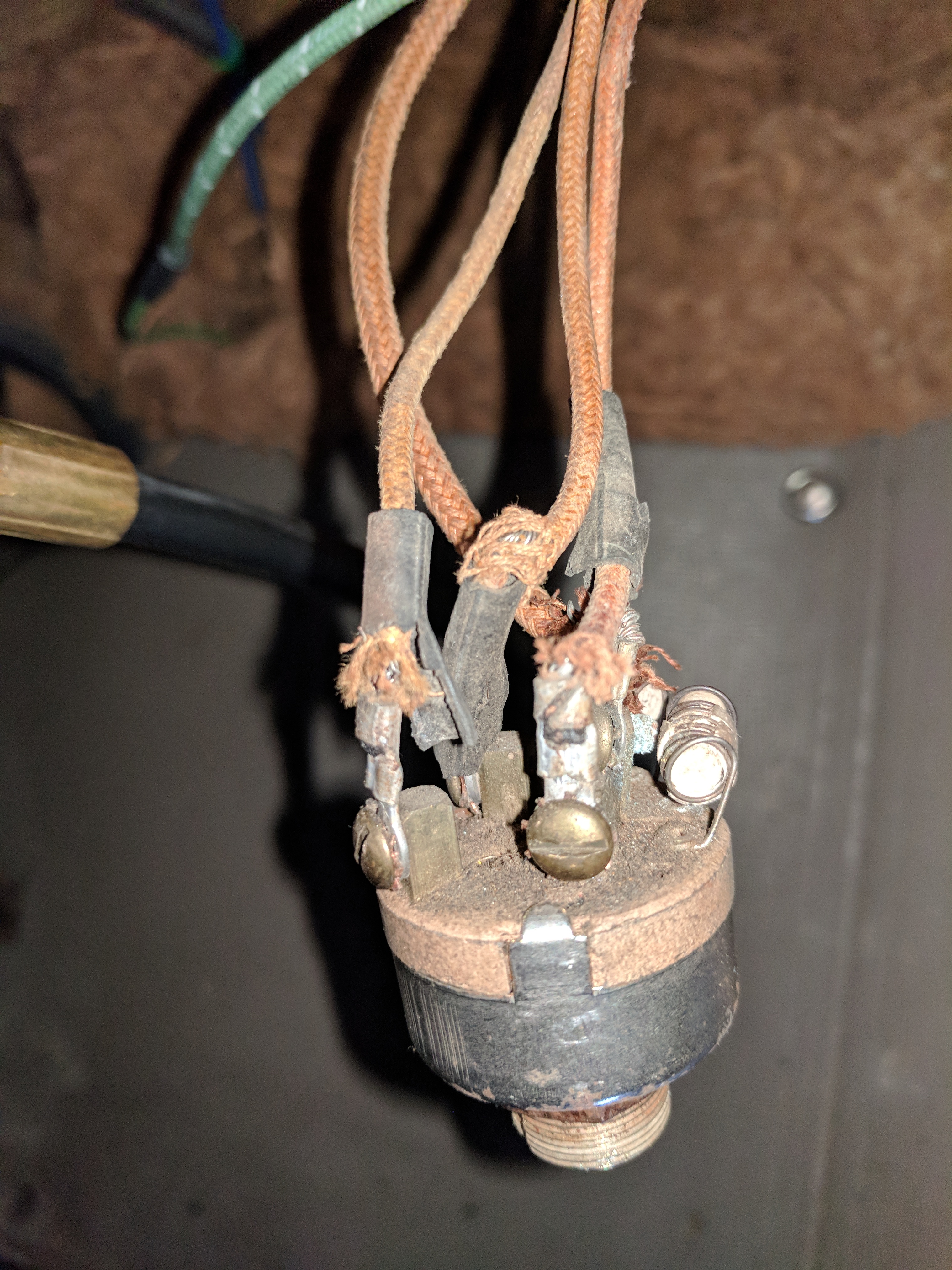

Ok after testing I have determined the switch to be bad. No power going out to the heater. The good folks at Wildrick's sent me another one. It should be here Monday or Tuesday. I will let you know how that works out.0
I have received the switch from Doug today. I am confident the good doctor can help me but incase this switch doesn't work out ( its a 2 position mine is a 4) is there anyone that may have a switch like mine or know where I can get one?0
