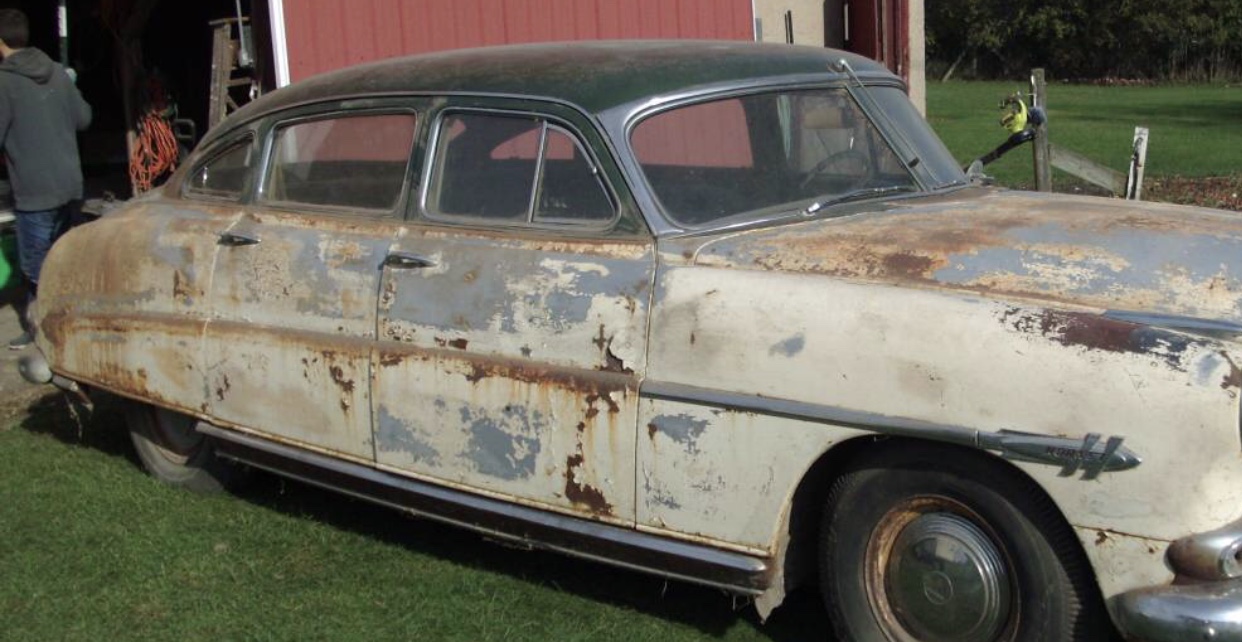

im sorting out parts that came with my hornet .it appears based on the oxidation marks there should be trim all the way down the sides . But there are no mounting holes in the doors or quarter panels .
I have the pork chop looking pieces for the quarters ( and mounting holes ), I have the trim on the fenders . I have none of the pieces that godown the doors or for the quarters . I also have no mounting holes for those pieces .
Im a bit confused because it looks like all the pictures I see of hornets all have the trim all the way down on both sides .
Do the pieces I’m missing not use holes to attach to the car ?

yes there should be retainer strips screwed to the doors that hold the trim
If you need the stainless strips let me know . I can help. Also the retaining strips.0
Haha well I’m gonna guess the screws rusted into the doors so well I cant find them . Maybe when I start sanding they will show up .
lance ! Yes please shoot me a message about the stainless and the retaining strips0 -
there's also stainless that goes above and below the side glass, but perhaps you've already removed those?0
Sadly no this is how I got it0
those aren't hard to find. I'm sure Lance has those pieces as well if you want them.0
