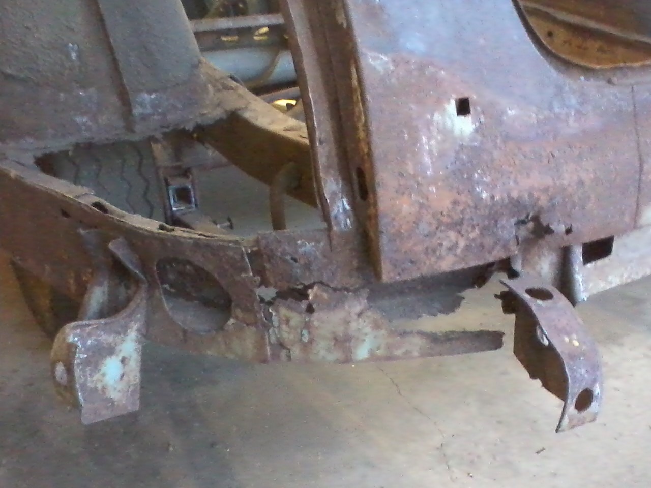

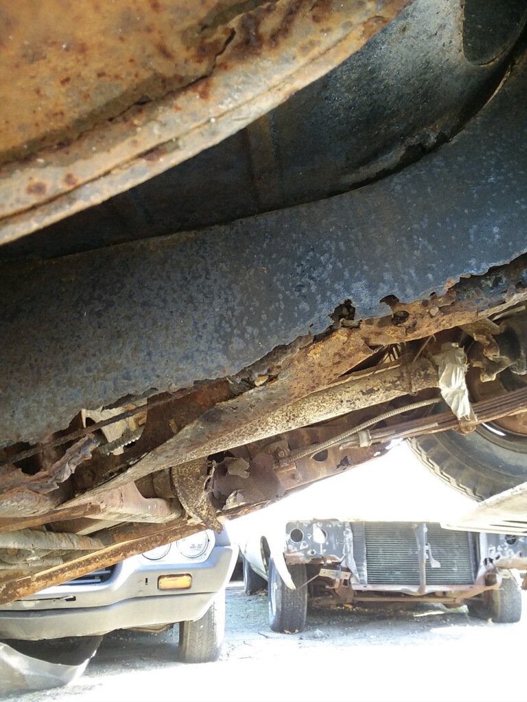

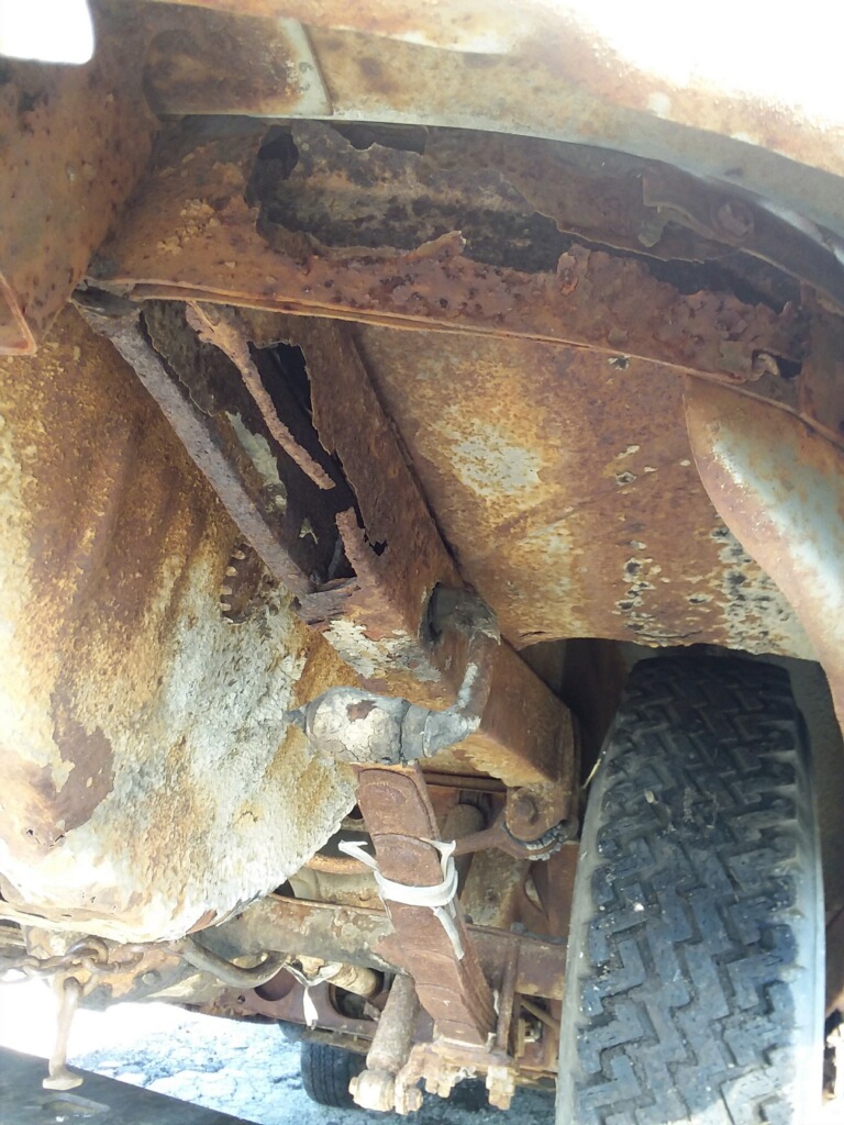

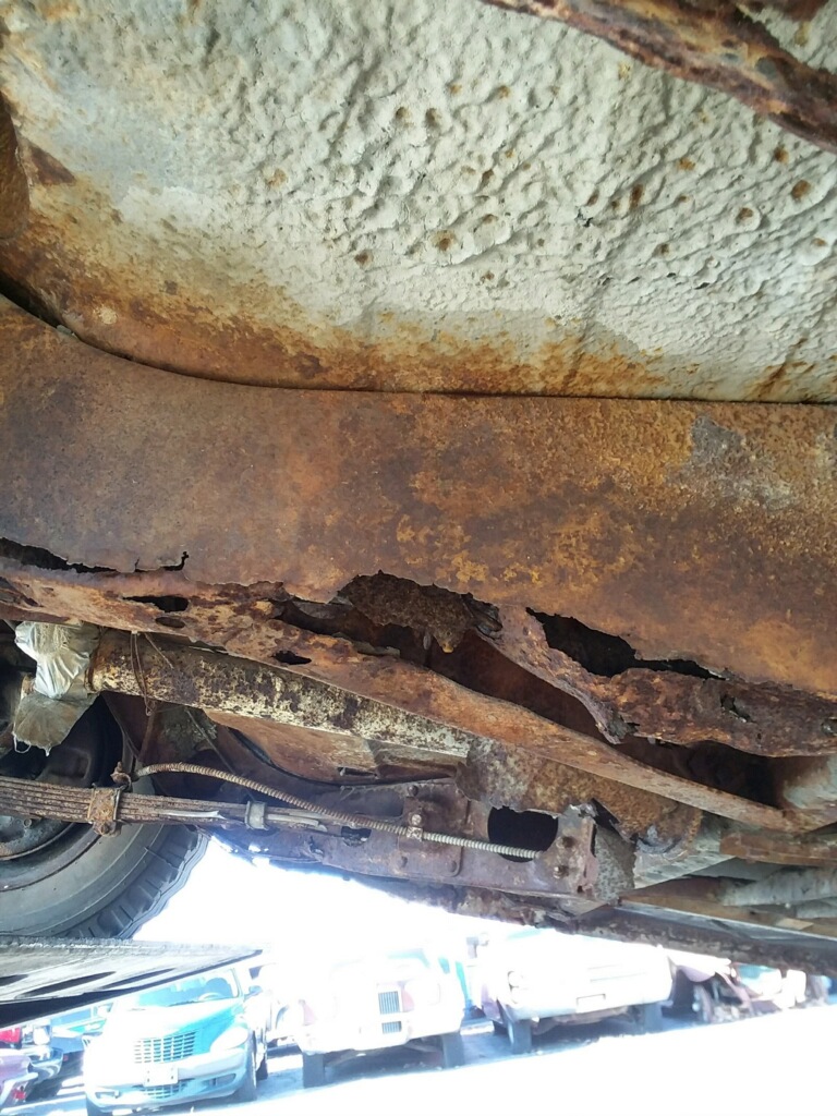

Ive taken a closer look and all the frame is solid but the frame in the rear from just after where the leaf springs attach back under the trunk floor is Pratt’s much gone .
Is this his too much to be worth fixing like was mentioned in earlier posts ?
Pretty much looks like like I need the drivers side pan/ toe board , the rear frAme section I just mentioned and a little bit of the trunk pan ... or if it’s better the whole trunk pan . The rest is just the coarse rust scale on the under side of the car .
I purchased a nice, body and interior wise, '53 Super Wasp sedan five and a half years ago and one of the things that sold me on the car was that it had a good, rear perimeter frame. And even then, the rear frame need a little body work performed by Doug Wildrick.

This is the rear frame ... are you saying that the rear frame neededIng work isn’t great but isn’t a deal breaker then ?0

Mike, you need to take stock at this point. Unless you work with metal, you will need to have someone rebuild this frame. There are people out there (we have one, in this area) who are surprisingly good and quite reasonable in price, and you can ask around amongst your old-car or streetrod friends to find who that is. You could then take these photos to him and ask for an estimate. However, you'll probably be spending a good deal of money just to get the frame done. And that's before you start on the rest of the car.
If you're intrigued by StepDowns, you can probably find one whose body is in much better condition, for less than it would cost you to have the frame repaired on this one. That other car would provide a solid basis for a restoration. Then, you can use the parts from your '53 to restore this "new" Hudson. The least you could do is contact someone in the Chicago-Milwaukee chapter and ask if they know of such a car for sale. Often, these things are not advertised, and you find out about them only by word of mouth. It's certainly worth a phone call or e-mail to find out.0 -

53_supwasp said:This is the rear frame ... are you saying that the rear frame neededIng work isn’t great but isn’t a deal breaker then ?

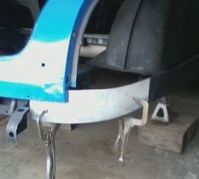

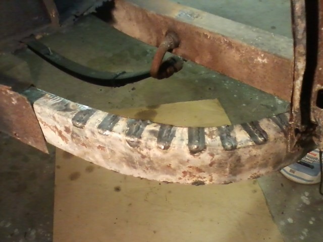

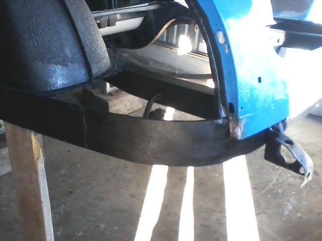

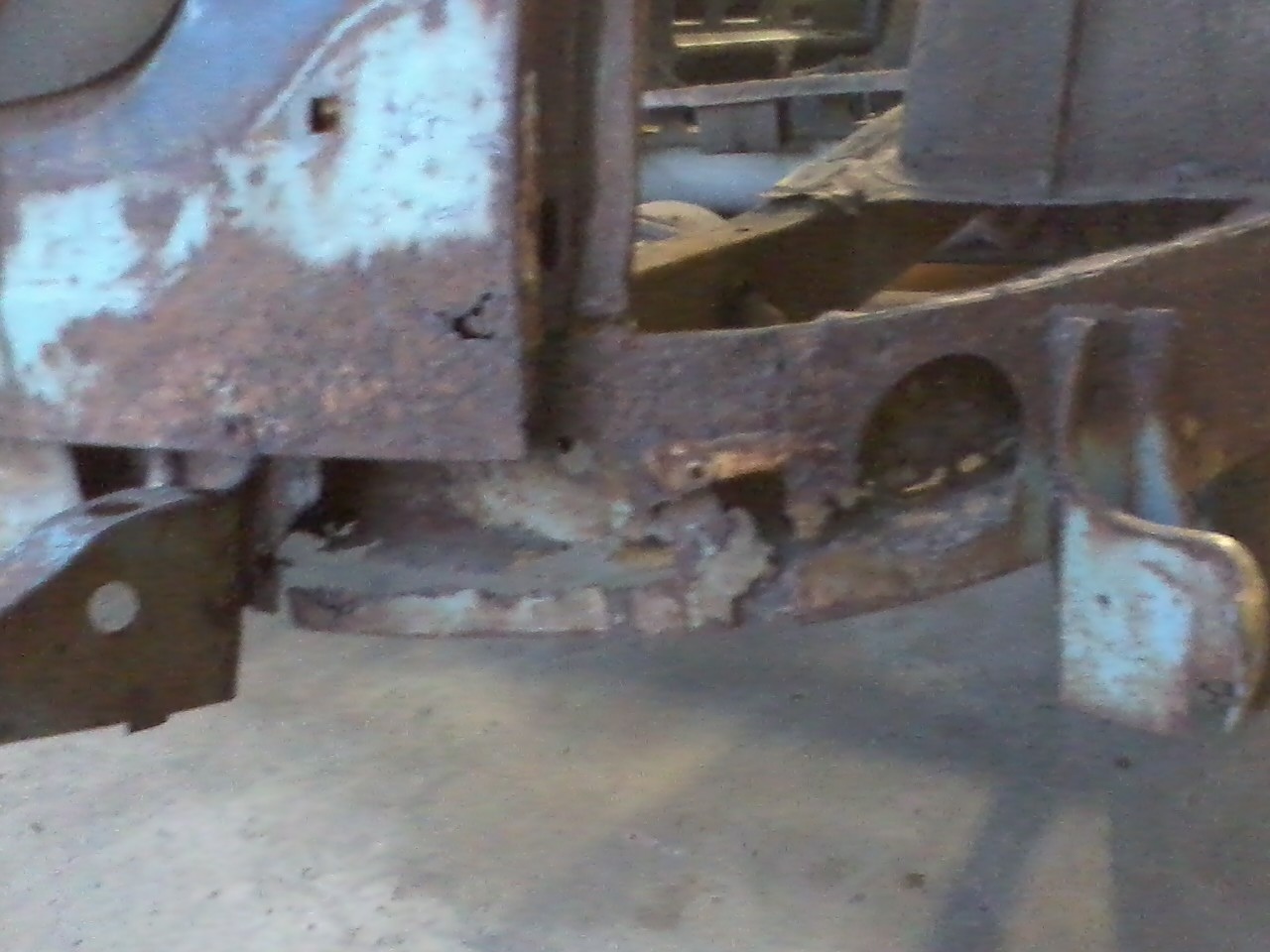

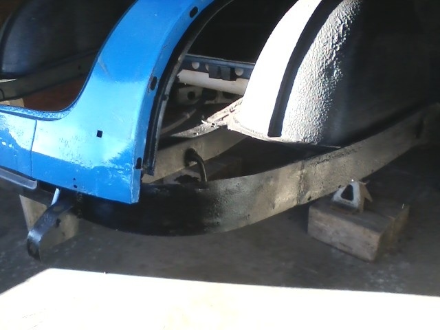

I don't think it is a deal breaker anything can be fixed. I did my own repair to that area after looking at the pictures on old farmers website . it took me approximately 25 hours per side to fix with minimal tools. I really think yours can be fixed, but don't know how much it would cost to pay someone to do it. Good luck with your project, hope you enjoy it as much as I do mine. Check out my build thread on this forum if you get a chance. Good luck with your project. Link below, thanks preston-triman62 https://openforum.hetclub.org/discussion/168295/51-hornet-project-with-pictures/p1

Wow ok ... my post at 9:38 am today there are clearly files attached to show the damage . If they aren’t displaying I wasn’t aware and apparently need to apologize .RichardD said:Amazing to me that you are describing something continuously without posting photos that would certainly show what you are trying to say???
If the attachments aren’t working you just have to give me a heads up and I’ll do my best to remedy the situation .
I was getting responses to the damage so I was thinking the attached images were working .
I will I’ll take a look from a regular desktop computer
Maybe Richard has an issue with his browser, but I can see the pictures fine.
I can see the pictures fine as well and details nicely how this common rusted area can be repaired.
Thanks for putting photos there; excellent, very explanatory.0
Yikes... that frame damage would scare me... As others said, you can probably find a nicer stepdown out there that would be cheaper in the long run...0
