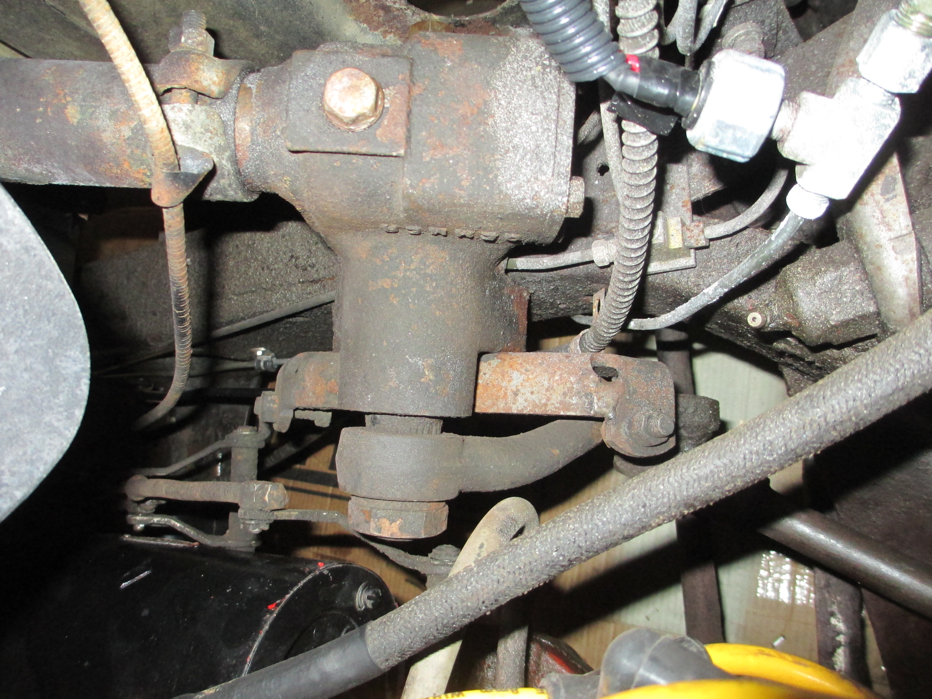

For many years I have collected digital pictures of Hudson accessory installations and the pieces of those installations. My friend Mike Madden sent me a picture of the steering stops in his 1954 Super Wasp which was previously equipped with Power Steering. My car is not equipped with power steering and does not have this arrangement.
The Hudson mechanical procedures manual and the Power steering supplement both mention that the Super Wasp and the Hornets are different in several ways. One is the Steering stop.

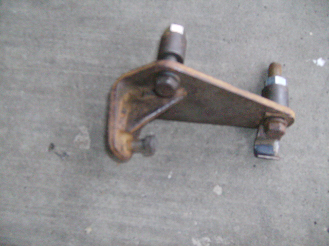

Finally, the second picture is of a power steering part from a Hornet installation. What is its purpose?
Any help with this is appreciated.

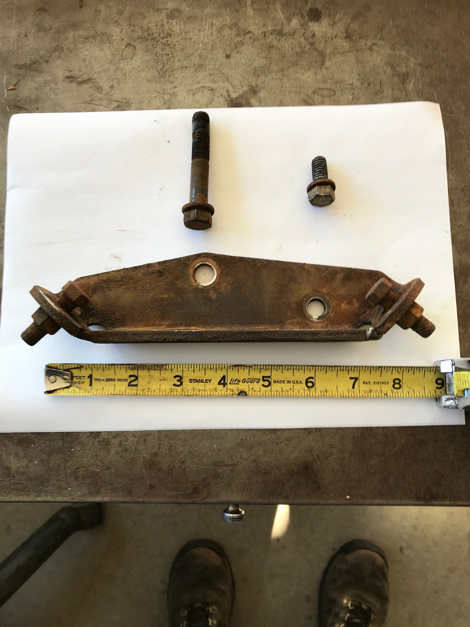

Here is a photo of an original 54 Super Wasp steering stop bracket with measurements, and one that I had made for Ken Cates. Ed0
Thanks Ed...0
Thanks for the picture of the parts installation0
