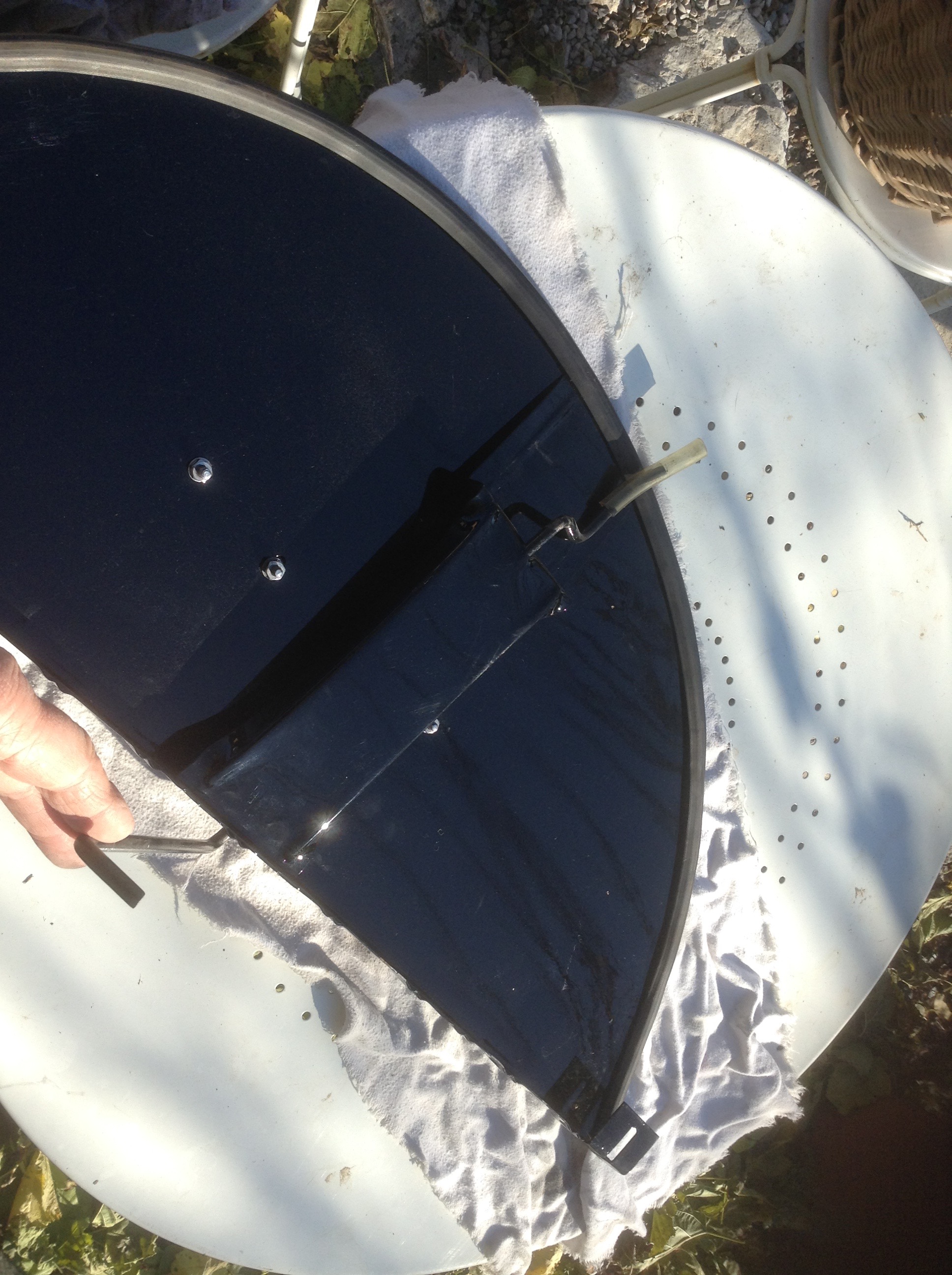

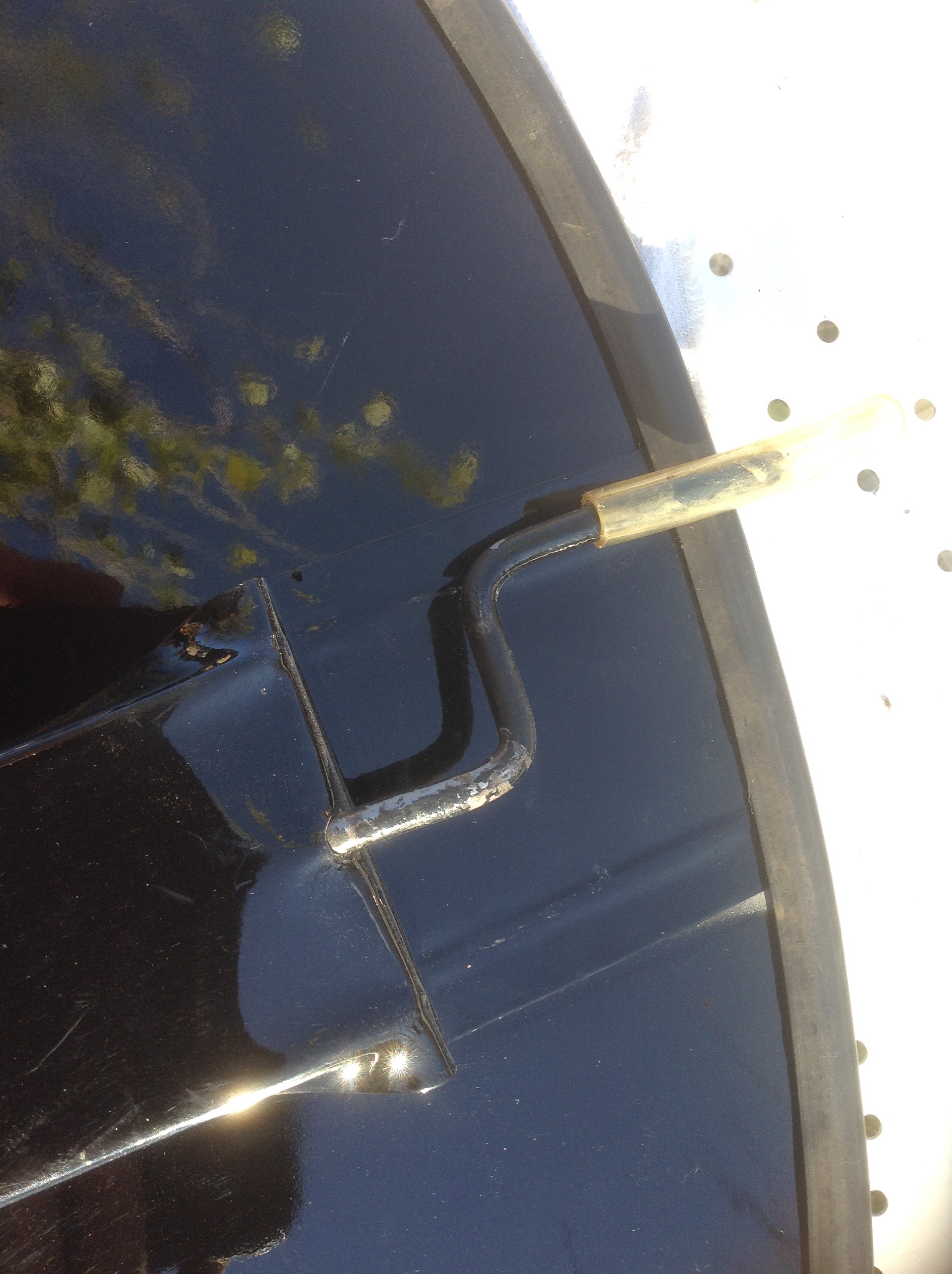

Thanks Guys. Mine don't have the wire clips - just a kind of lip that sticks up a bit. I guess I need to take some pictures of the other sides, but I had assumed they all fitted the same! Will take some photos and check back soon!
Hi again
Sorry about the long delay getting photos - the car's in storage for the winter 15 miles away, and I had to go and search out the skirts (they are always hard to locate because they're vulnerable so I tend to put them somewhere where they won't be disturbed, but then I usually forget where that was!).

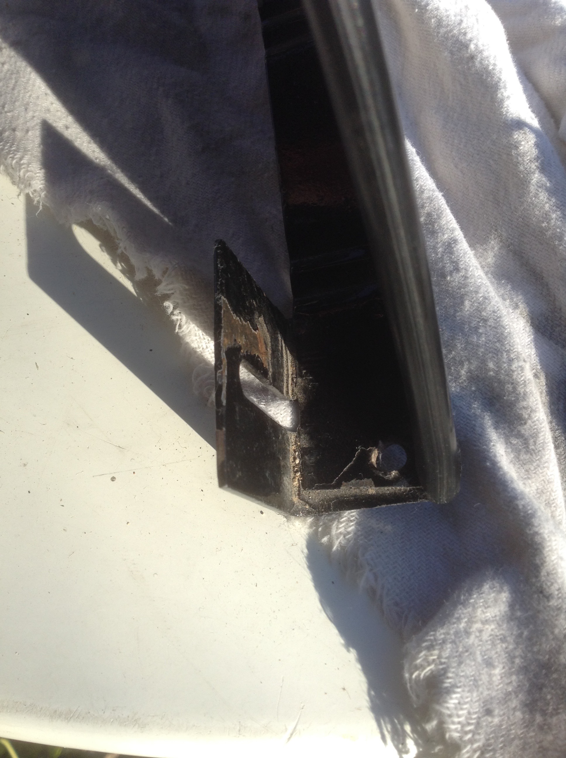

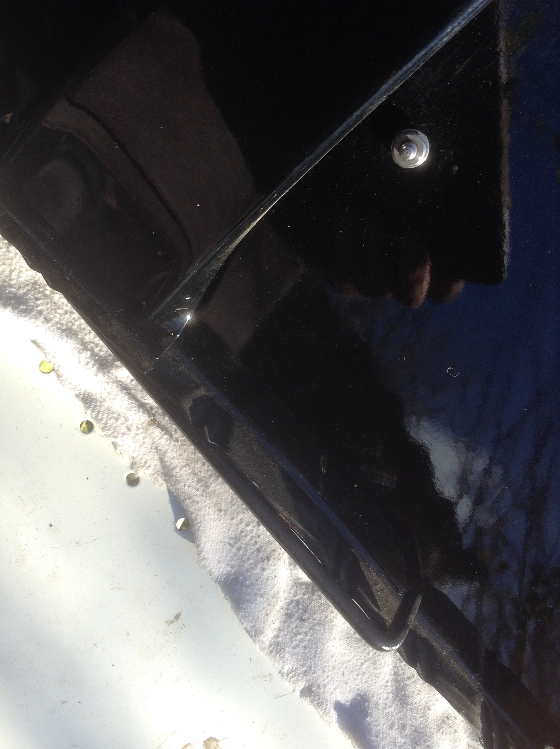

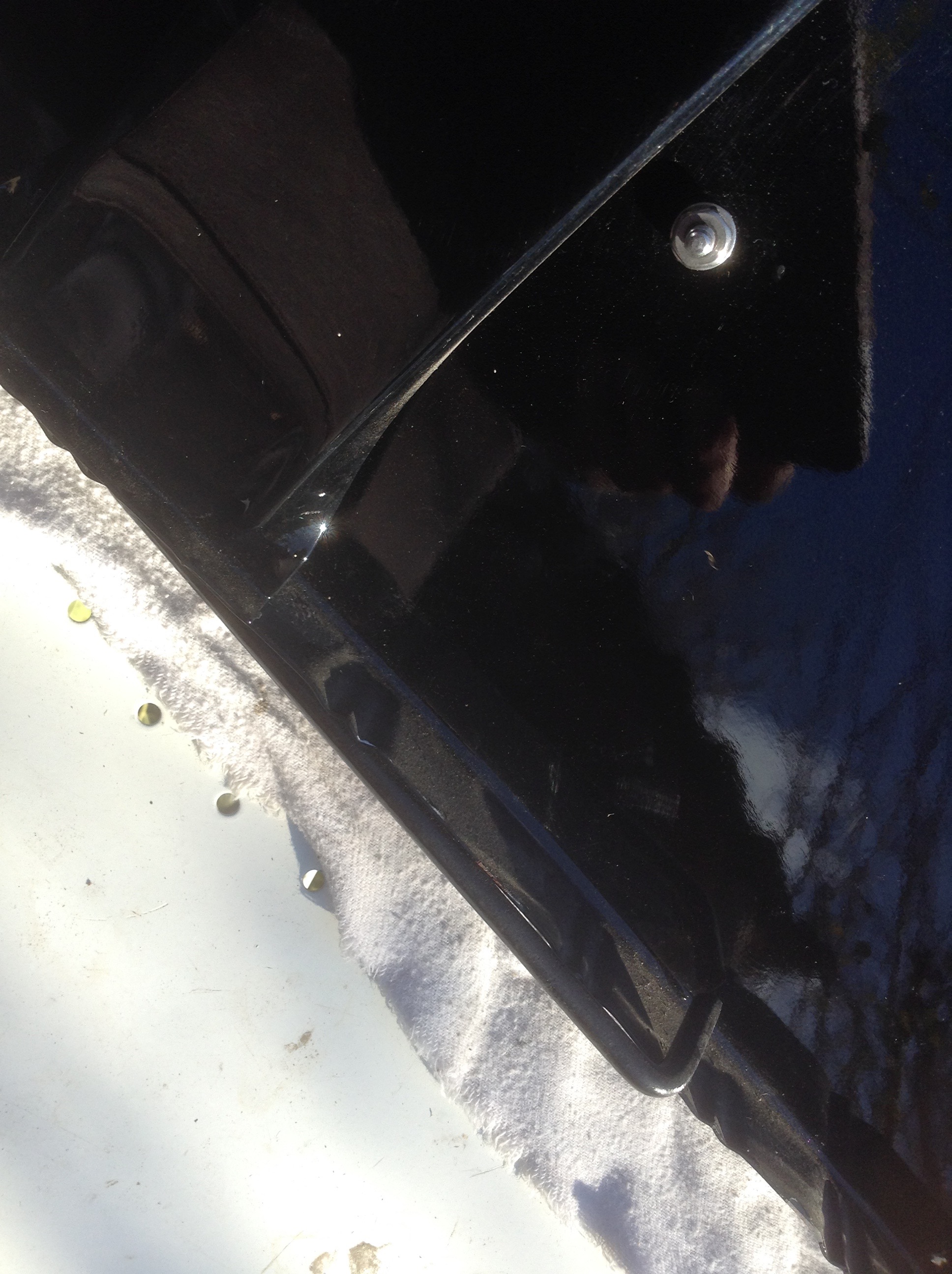

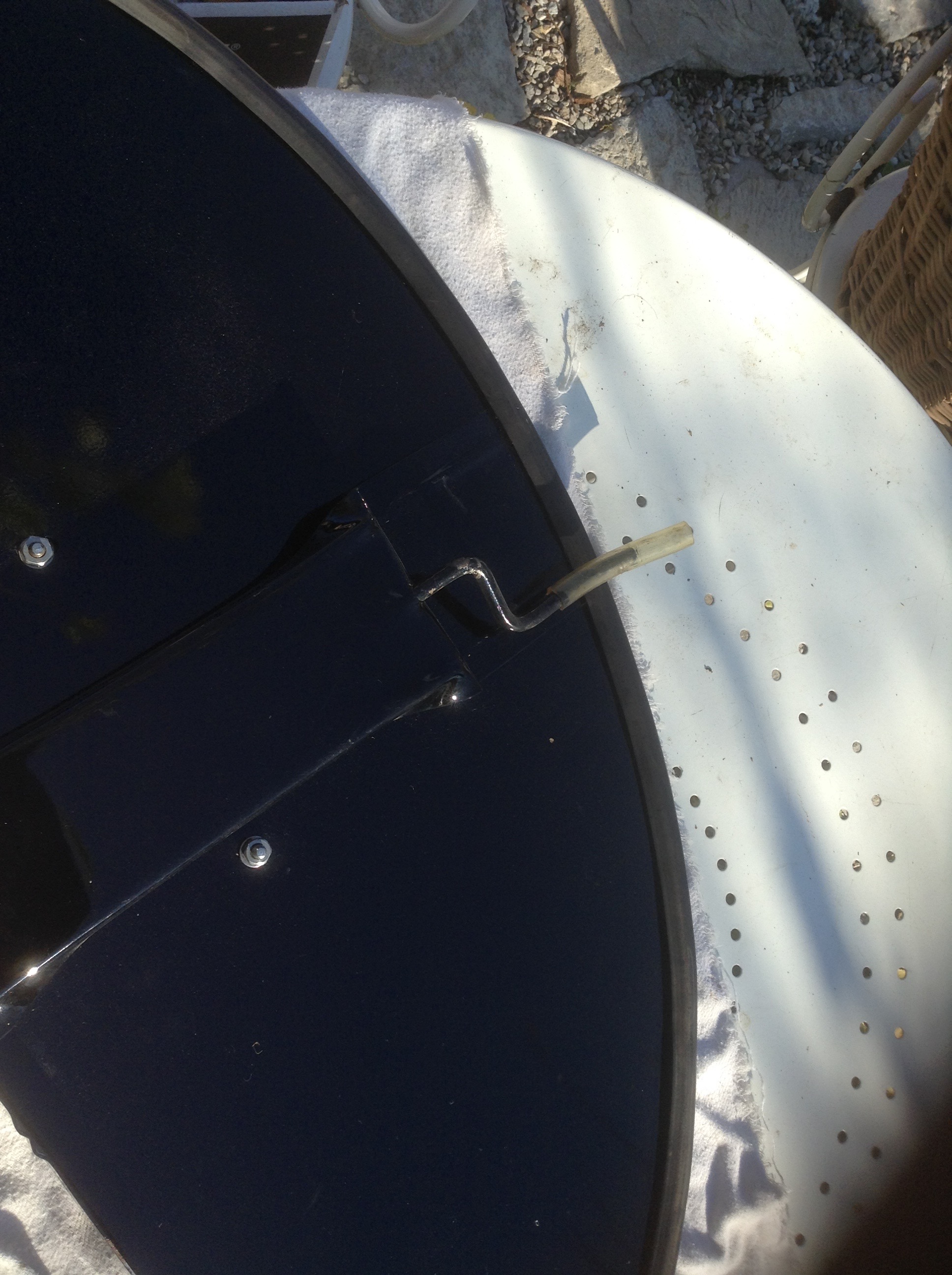

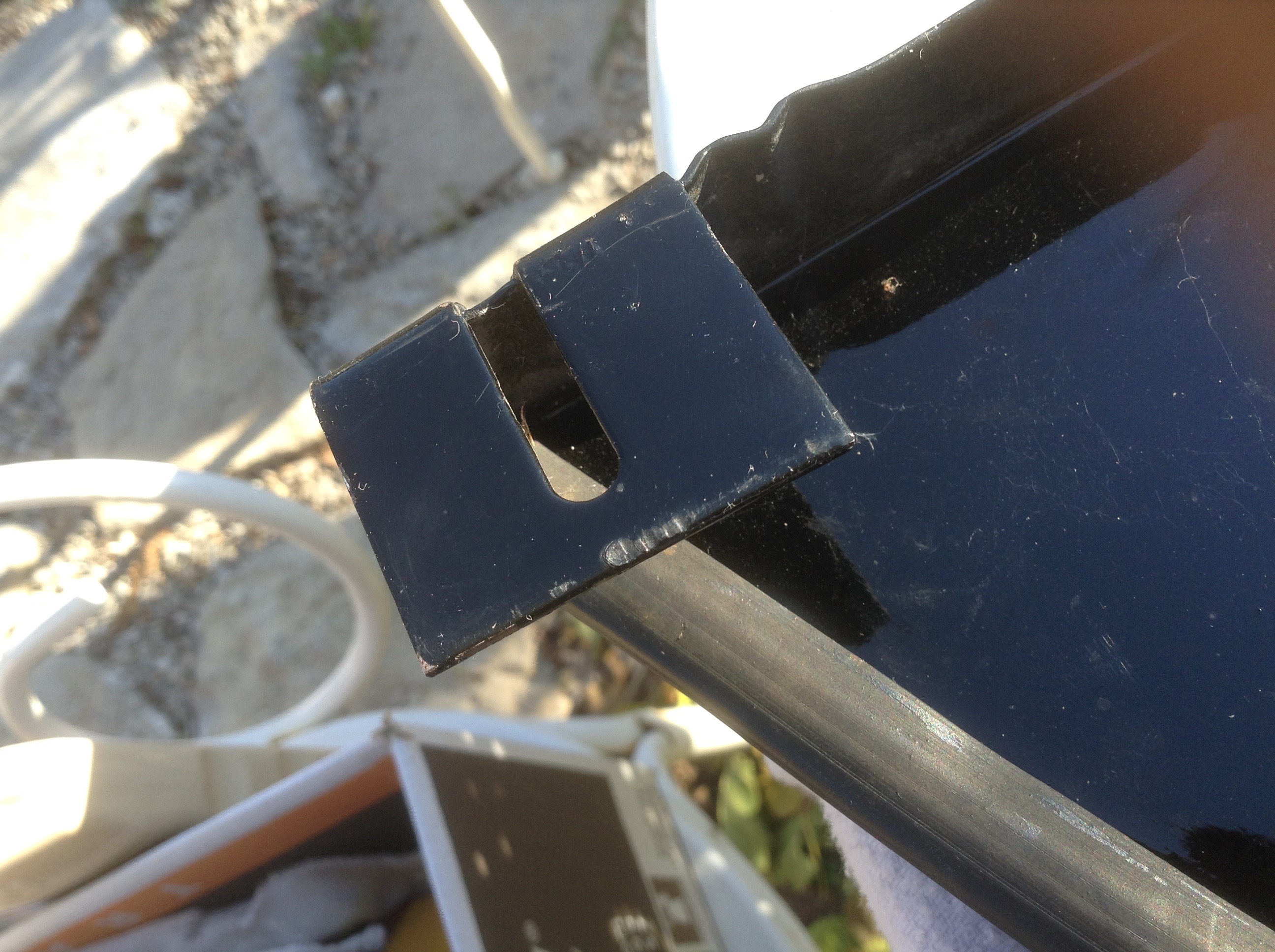

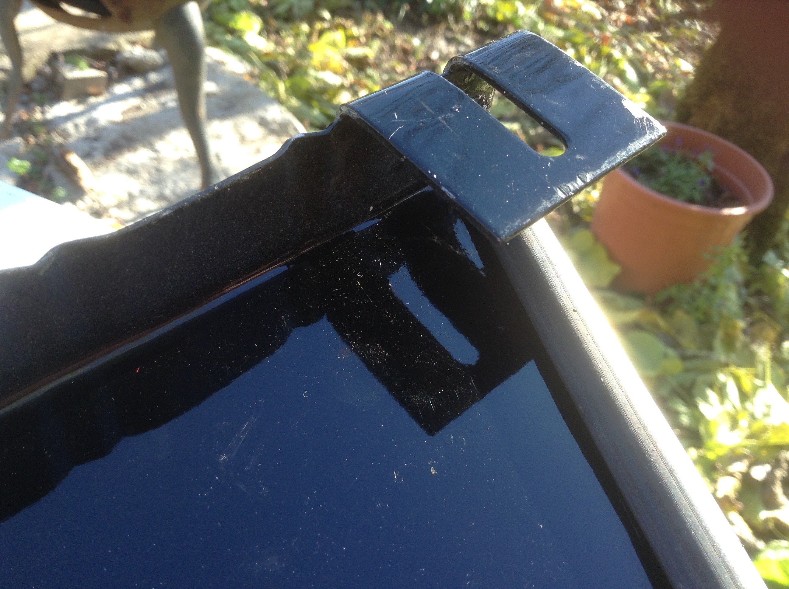

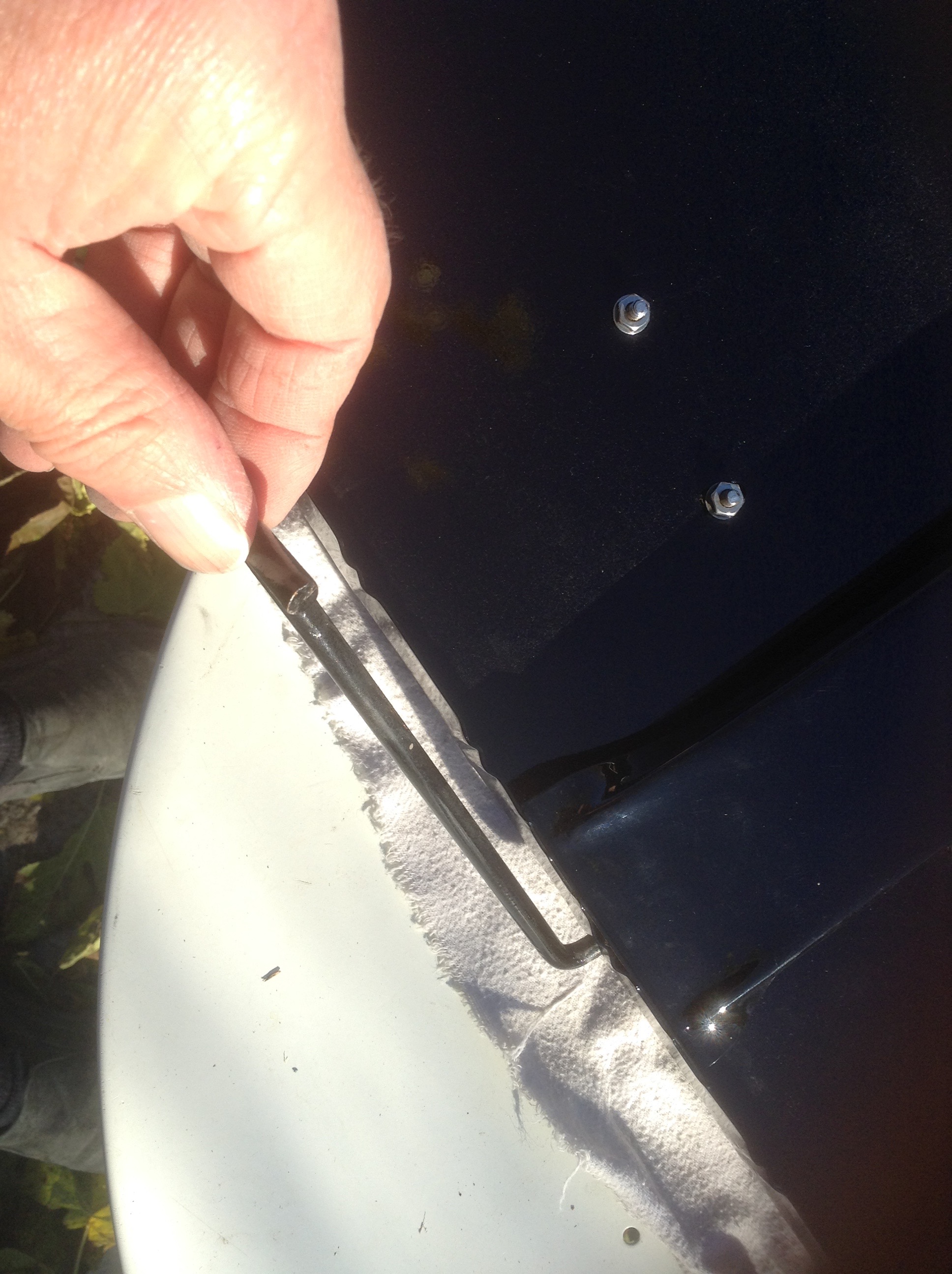

Anyway, here are some pictures - like I said, it looks as if there is something that should go in those brackets at the ends, but I can't for the life of me thing what!
I'll put the first pic here and then upload the others separately, to be kind to the servers.
Thanks...
Alan
Alan, unless I am mistaken these are the reproduction fender skirts that were being made perhaps thirty years ago. Possibly by Press Kale, though I'm not sure.

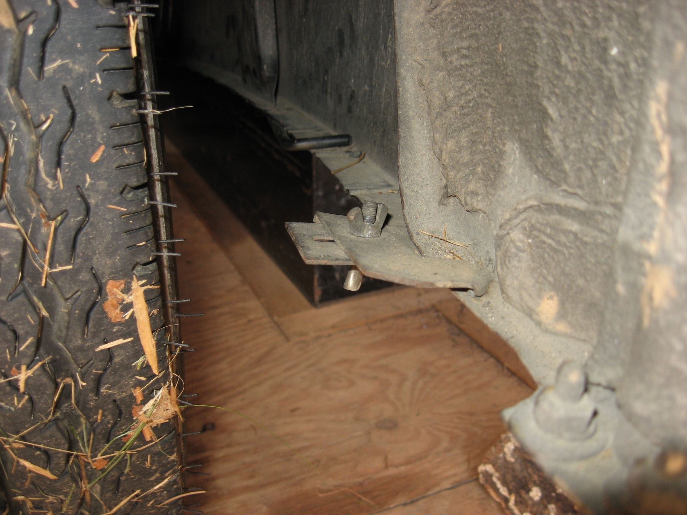

Here is a photo of the missing clip, that I just took.
The picture is taken within the right rear fender, looking downward toward the plywood floor of the car trailer in which my '37 is stored. The rear right tire is at left. The welded clip (that is already on your skirt) is the lower of the two clips in the center of the photo, and the skirt is just above it in the background. The vertical object at the center of the photo is the lower rear bead of the wheel opening.
The upper clip is what is missing on yours. It is essentially a 1/16" thick piece of flat stock cut in a sort of "L" shape and drilled for a screw with a wing nut. The L or hooked shape, reaches around and grabs the bead that turns in at the wheel opening, both to pull the fender skirt up tightly against the fender, and to prevent it from moving fore or aft.
The end of the clip furthest from you, is bent down at 90 degrees, and is about 1/4" long. That is done so that the clip cannot rotate once it's been bolted in place. If it wasn't bent down, the clip could rotate if the bolt wasn't absolutely tight, and the skirt would loosen up.
There is a similar clip at the front end of the skirt.
You probably have these clips kicking around somewhere and didn't know what they were. If they're lost, it won't take much to have a couple reproduced.0 -
