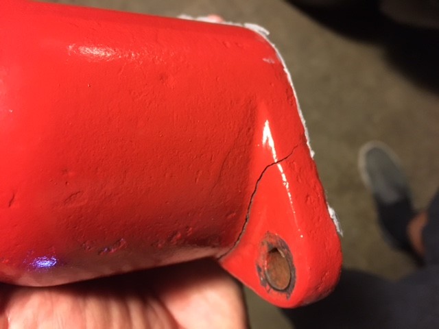

Overtightened and cracked waterneck housing. Replaced one, welded another. New gaskets with sealer. Longer bolts. Lathed thermostat to fit flush inside housing lip. Test fit with bolts appeared flush/flat. Any suggestions, tips? Shorter bolts? studs with nuts? Different gasket?

I used a gasket with red permatex on both sides, and didn't have any problems. I was always told never to overtighten those, as the ears can snap off. I can see now they weren't kidding!

Stephen, I got the replacements from Lance Walker. The head looks fine, took a file across it to be sure and did not appear to be any high/low spots. I was careful on the last install not to overtighten but may try a *little* more tightening 0
