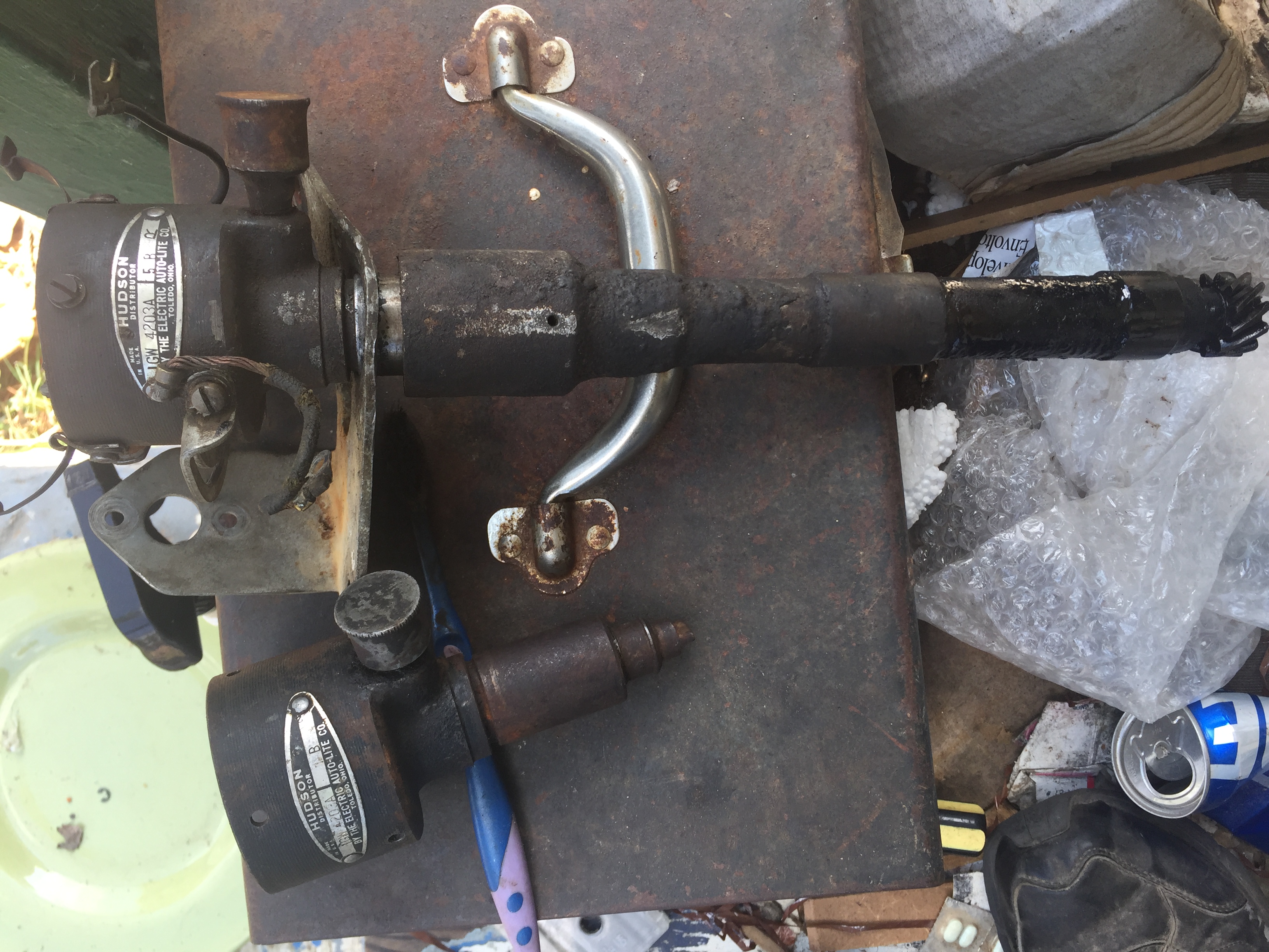

I got the distributor out. The distributor itself slips into another long cast piece with a shaft with a spiral gear on the end. I can't get the distributor out of that piece. I can't see anything holding it into it. Ive got another distributor. when I get off work I'll work on it some more.0
That part is stuck inside of a long cast housing that the shaft with the spiral gear is in. I had to remove it all and can't get that part out. I have another good one of those already, I just need to get the old one out0
Oops, sorry, I assumed it was the same mounting on a '47. But of course, being on top of the block the distributor shaft has to be longer to reach the camshaft than it does on the pre-war (sidemount) type.
I got it out. Maybe I'll be on the road again by tonight. Got dark on me last night. The shaft had so much play that setting the points was impossible. I bet there is at least .025-.035" play in the shaft. Could set them open and they would never close, closed and they would never open. It might or might not start. Hopefully this fixes it. I've got another good distributor.0
Got it back running. Got dark before I got it completely finished but I'll be good to go tomorrow.0
