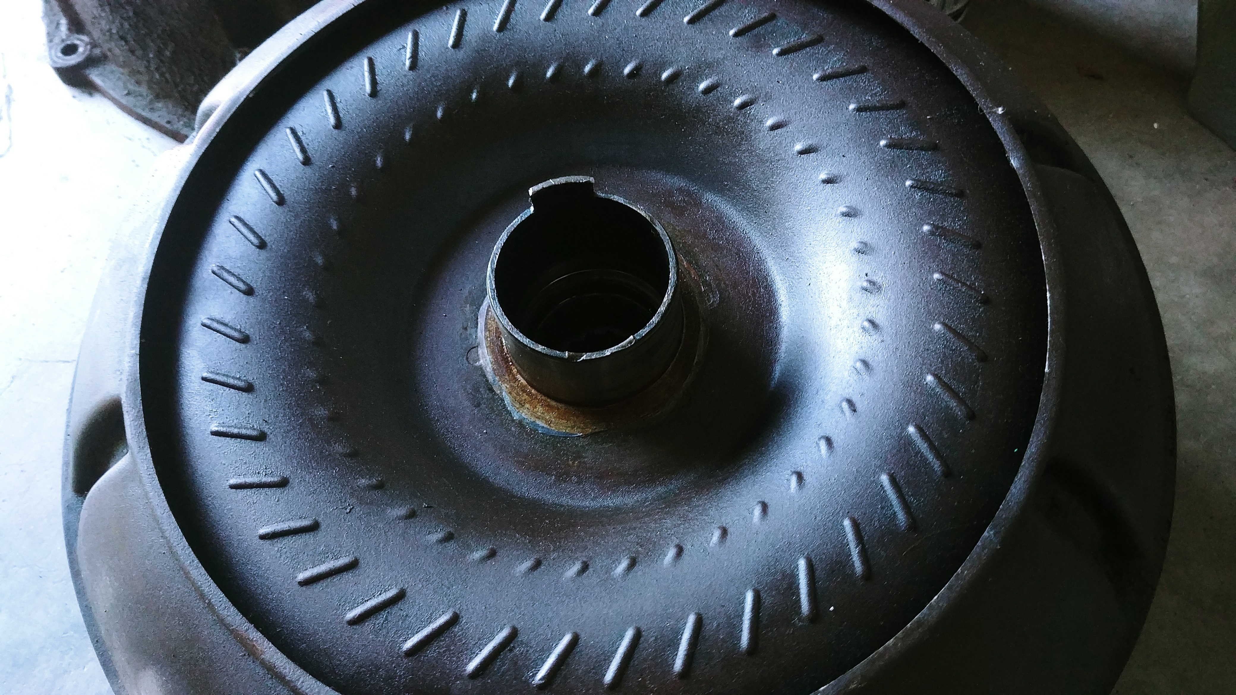

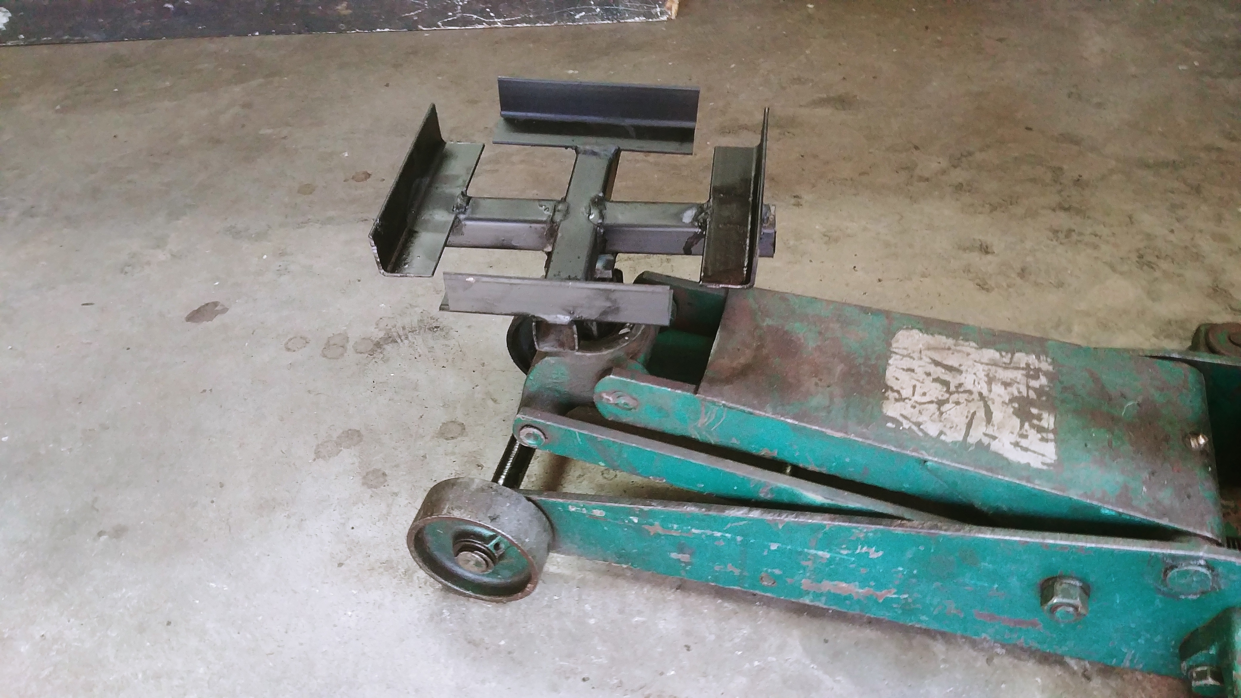

Well I read the work shop manual on how to remove the BG trans, the first thing was to have a cradle to hold the trans so it can be removed straight back. Pix below, once the trans was free from the torque converter I noticed that on of the ears that drive pump in the trans was missing (not good) Yep the front seal was as hard as a rock. So it looks like I need a torque converter. Any one of any BG trans laying around. iceblade the car had power brakes the master was trashed, I replaced it with a GM unit the found out that the Hudson pedal ratio was wrong so I built a new assy the pedal was some thing I had :-))
