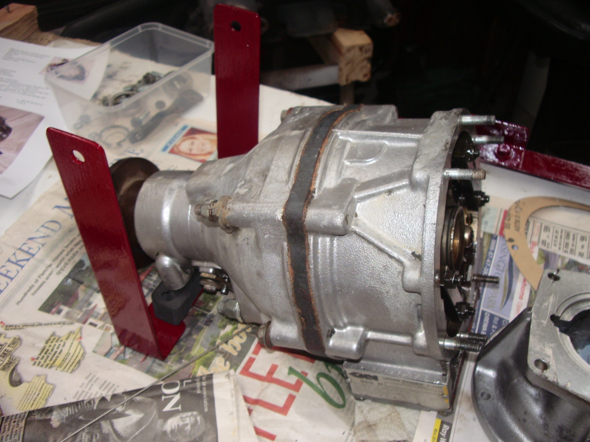

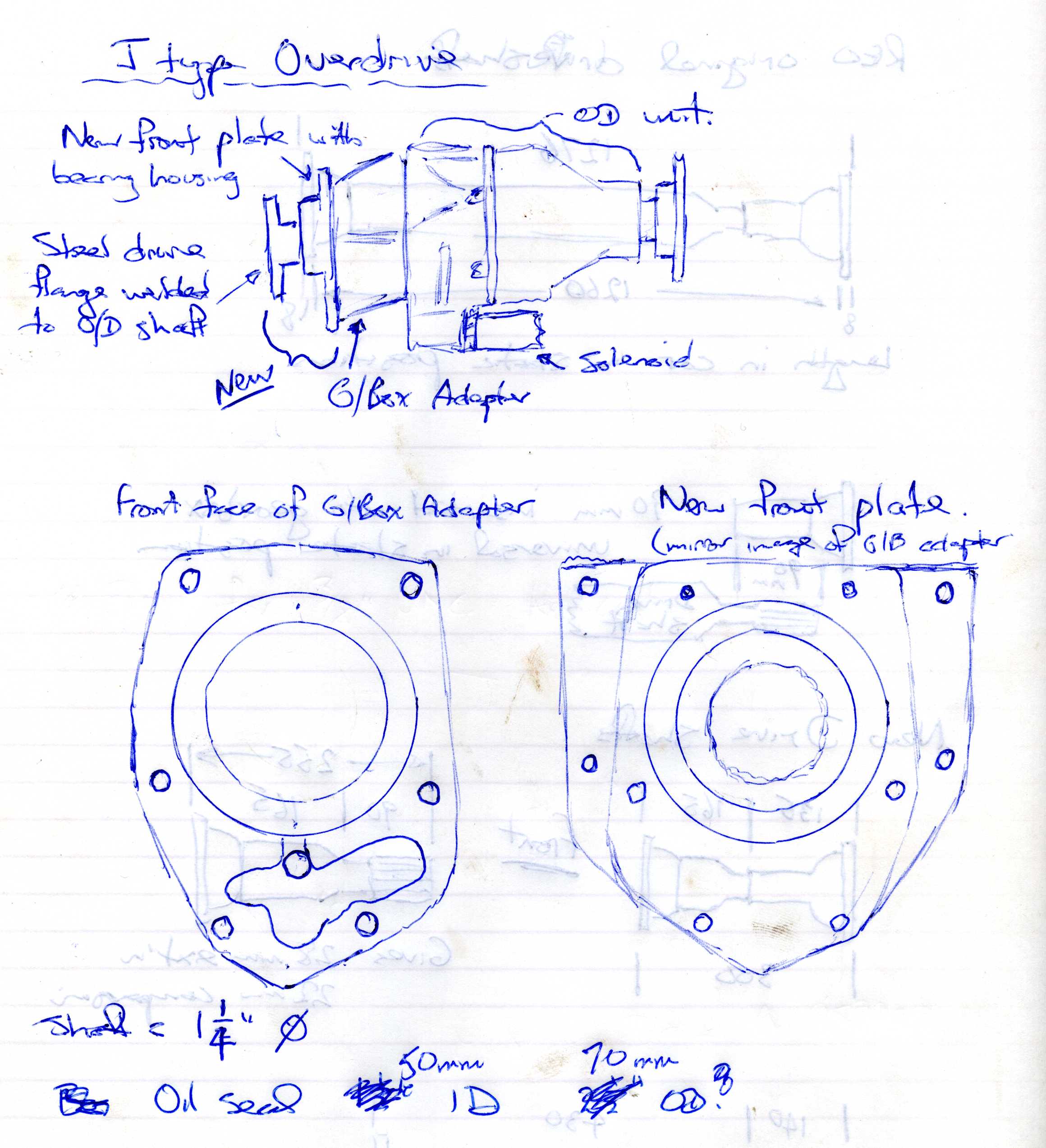

Hi there.

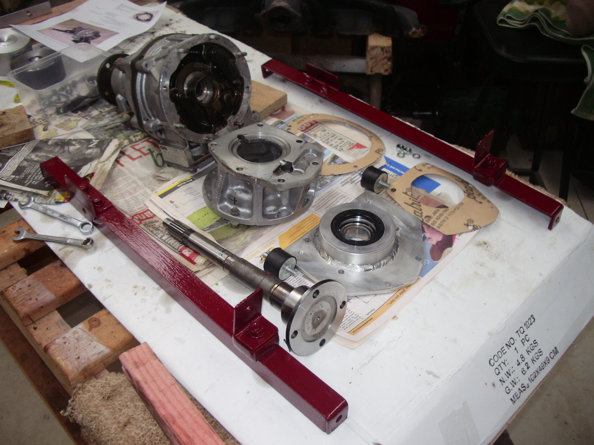

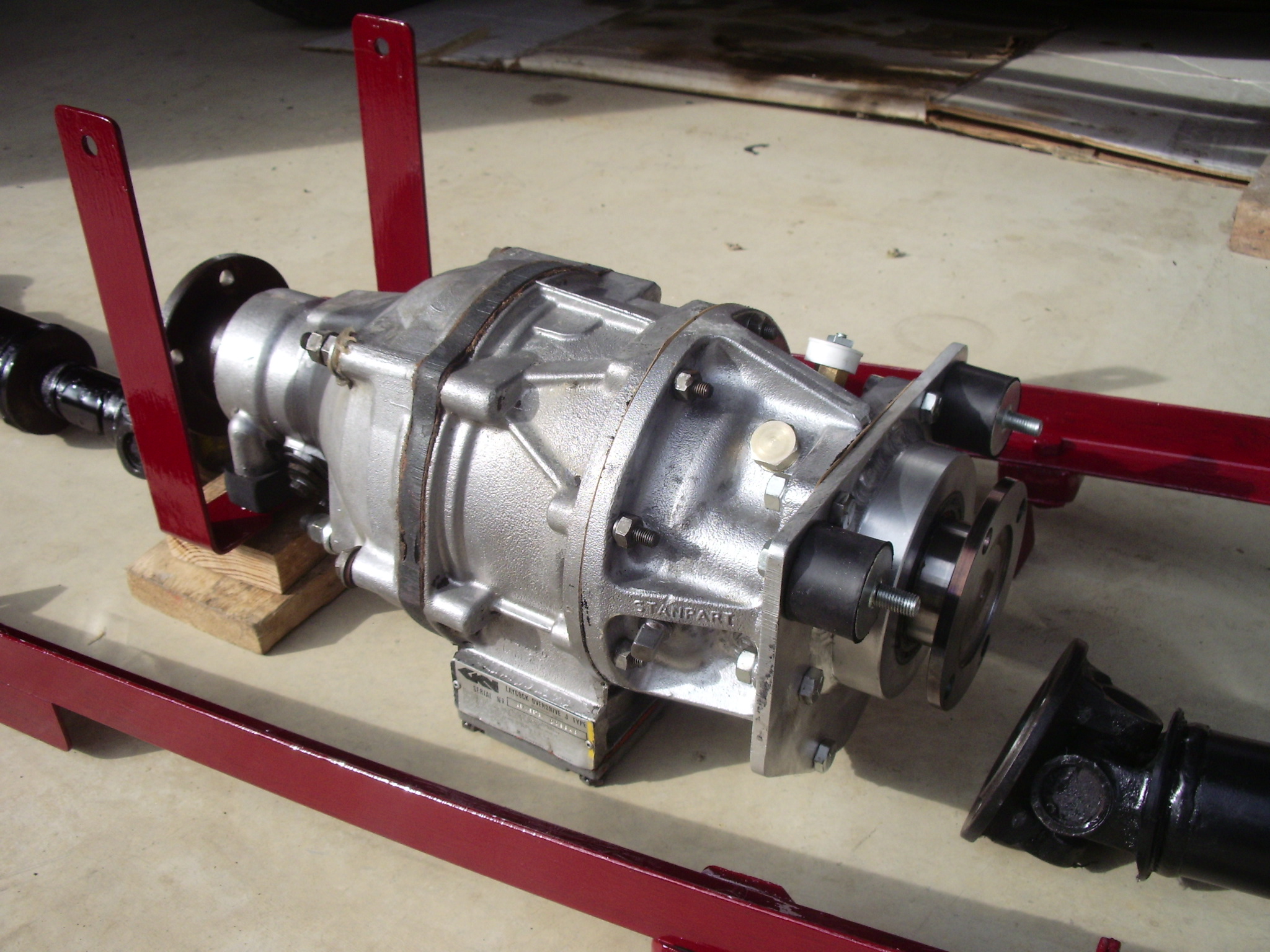

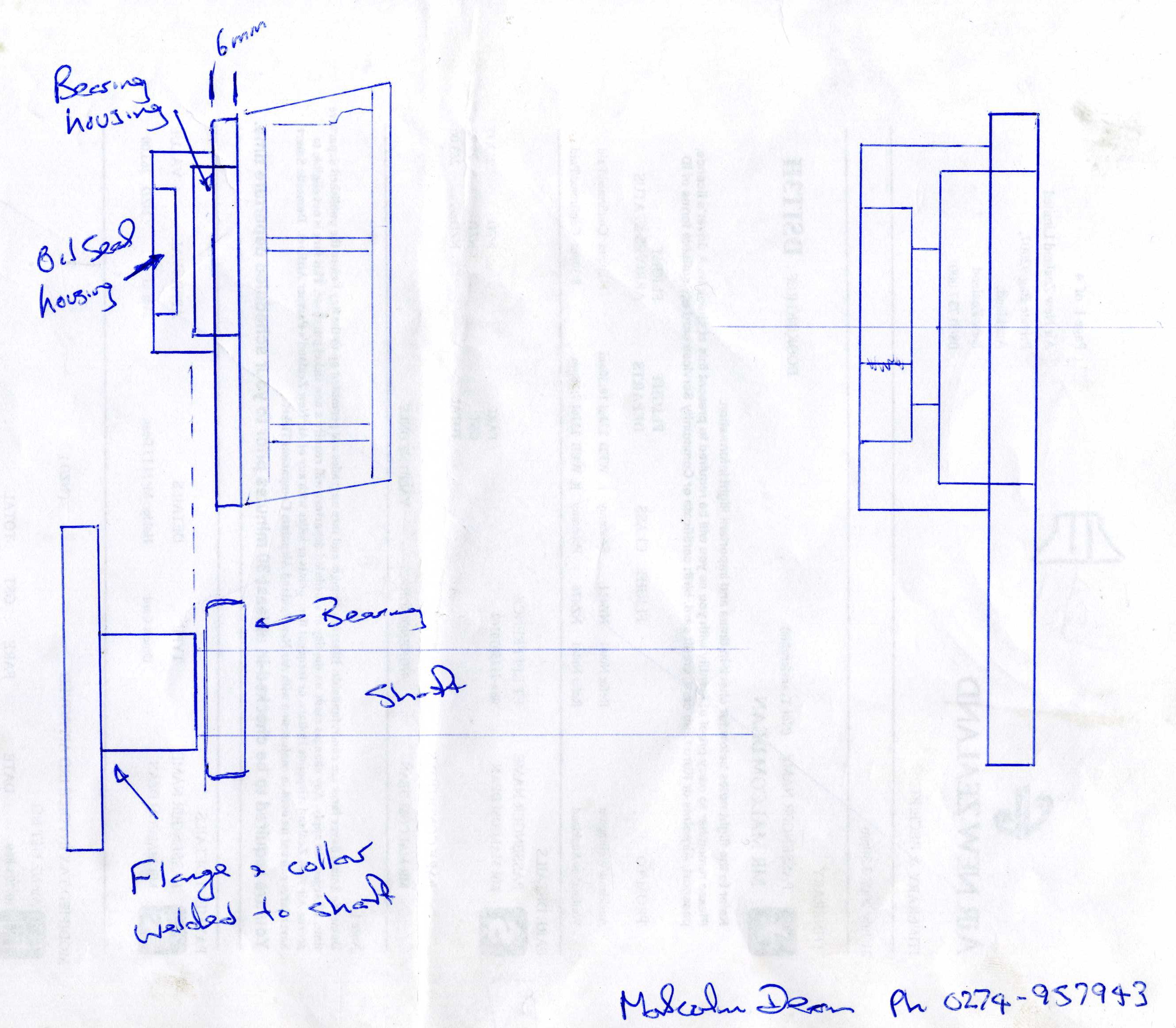

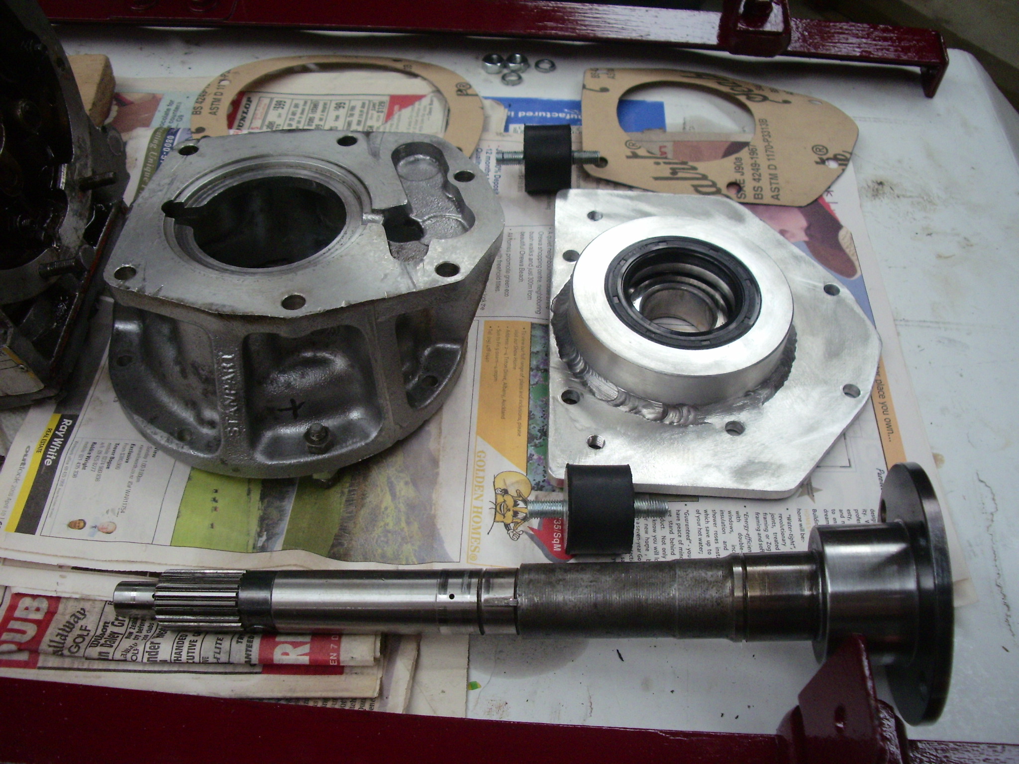

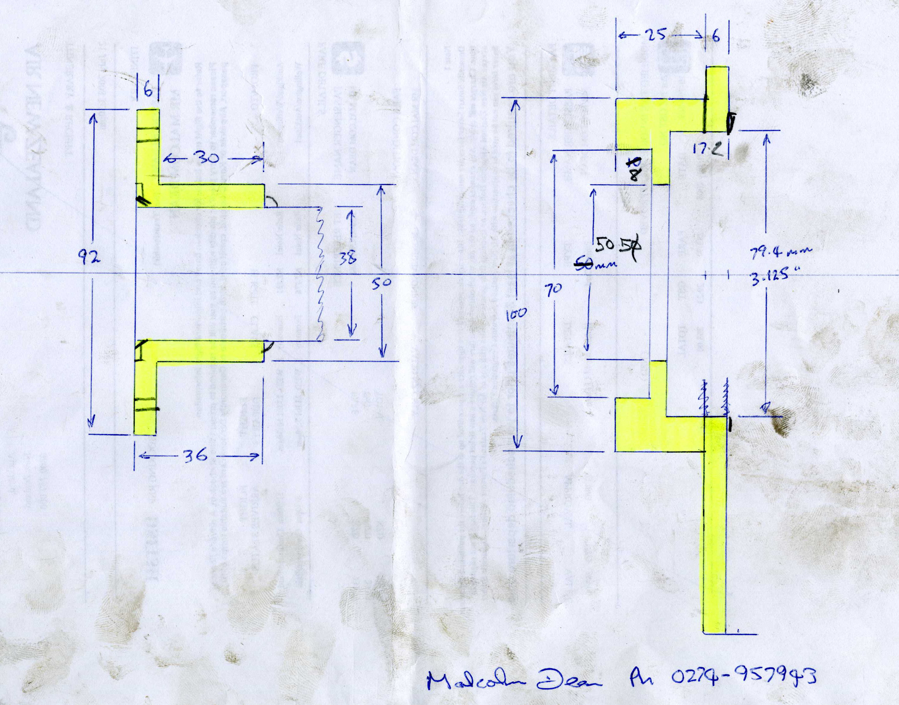

Have been reading your posts. Just a thought do you have laycock overdrives over there I am in NewZealand they were fitted to many English cars. eg MGB. triumph ect. If you are interested I can send you the plans to fit the overdrive to any 30s cars. I have a friend who has done the conversion to a 38 Packard It is a fairly simple conversion . I would need your e mail address. Or I could post the details on the forum. Let me know Regards Trevor
I have attached the details for you interest. Let me know if you need anything further.
trevor.dot.johnson@xtra.co.nz

Hi there. No problem I have some photos of the set up that I can post as well but my wife is away for a few days and she will know how to post them. I tried last night with no success.
Regards
Trevor
These overdrives sell in NZ for about $500.00

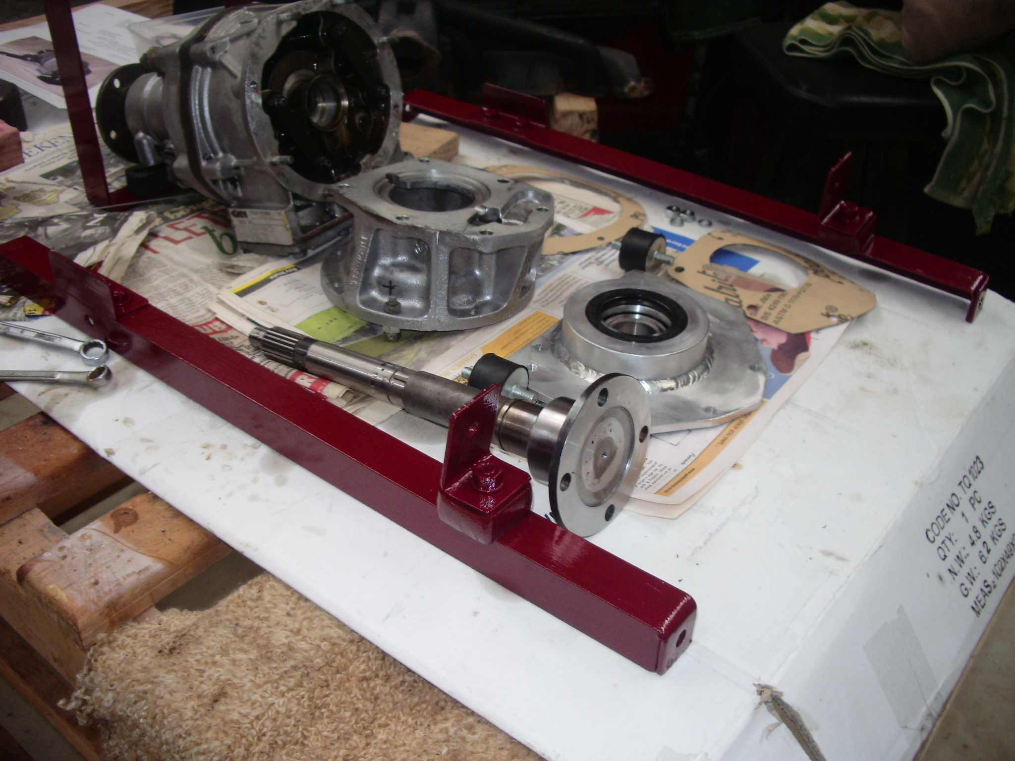

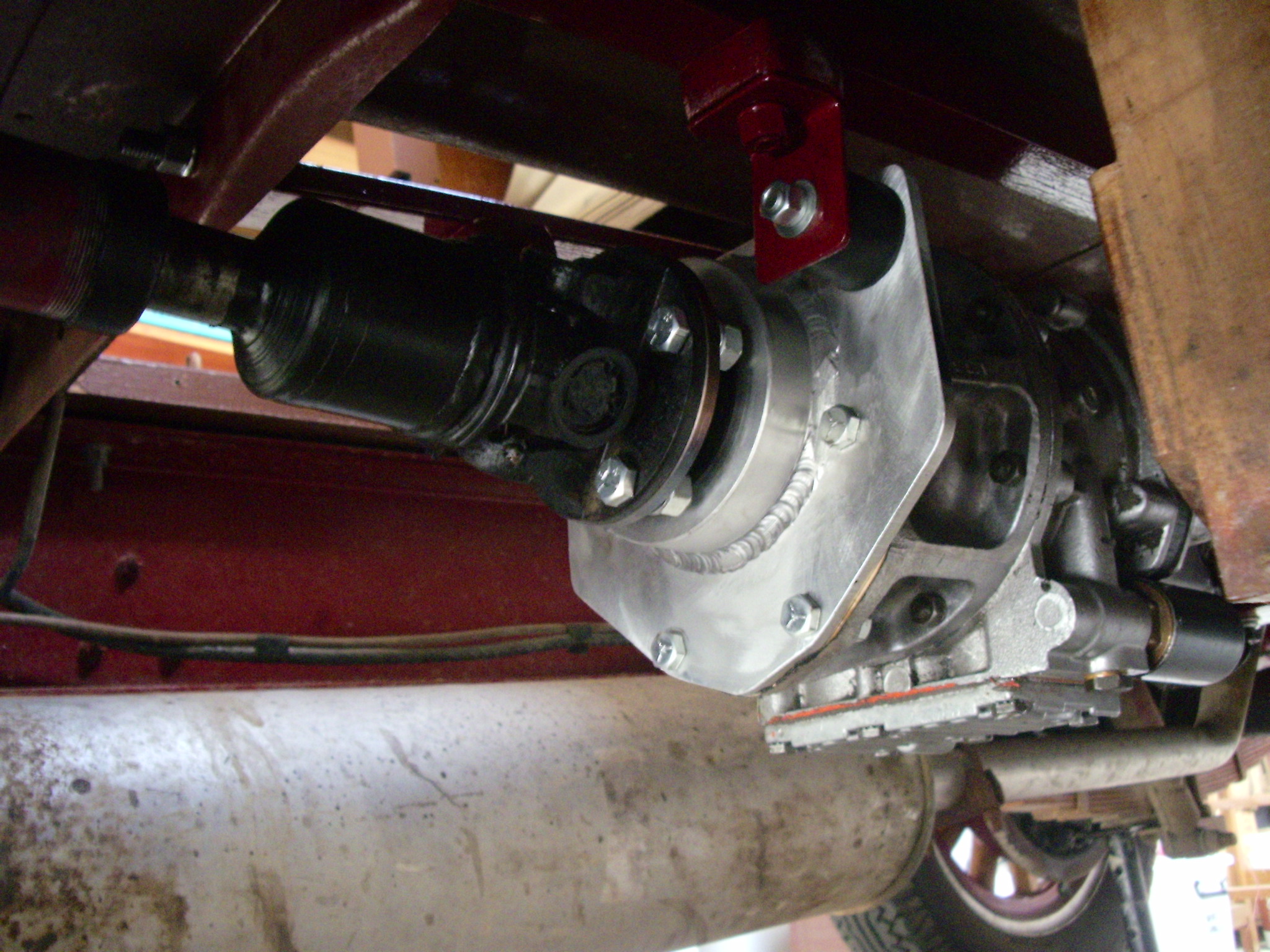

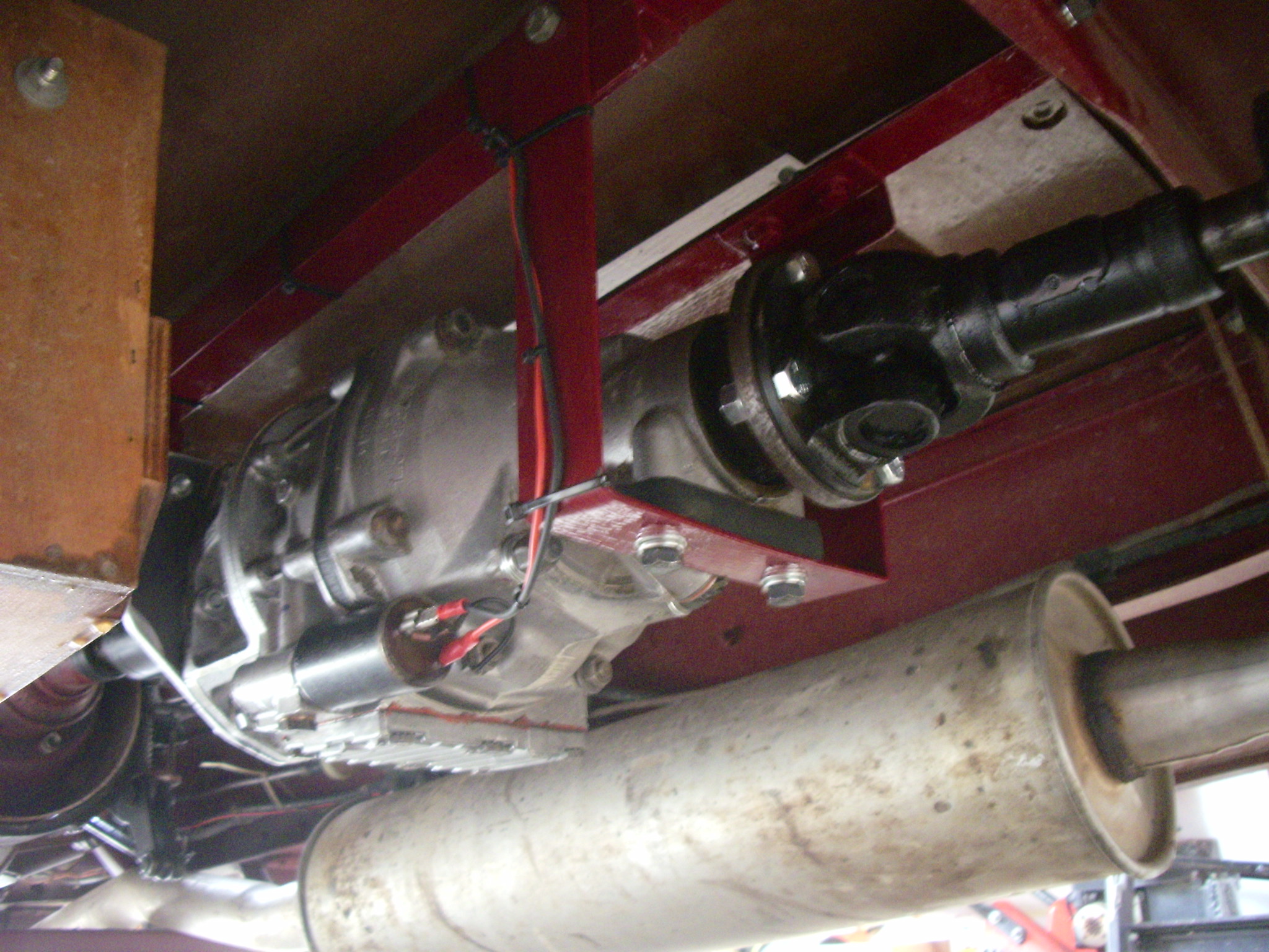

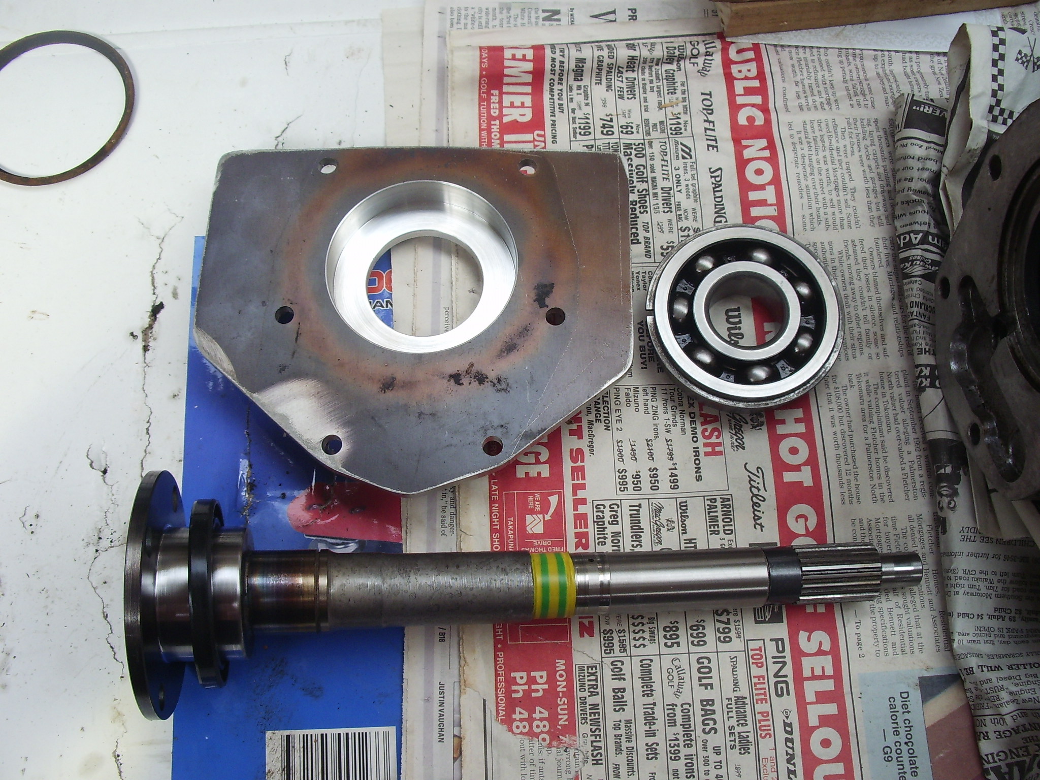

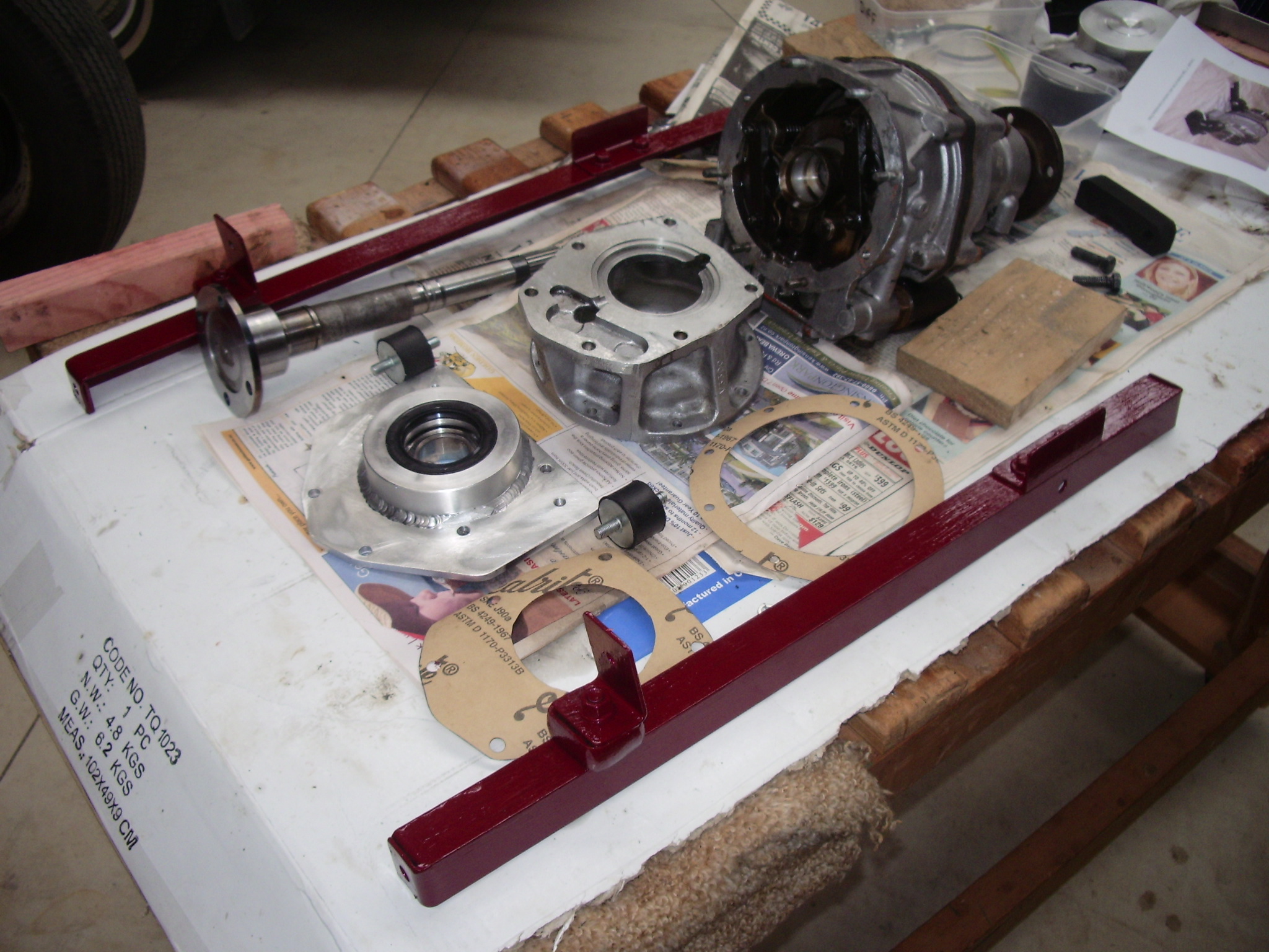

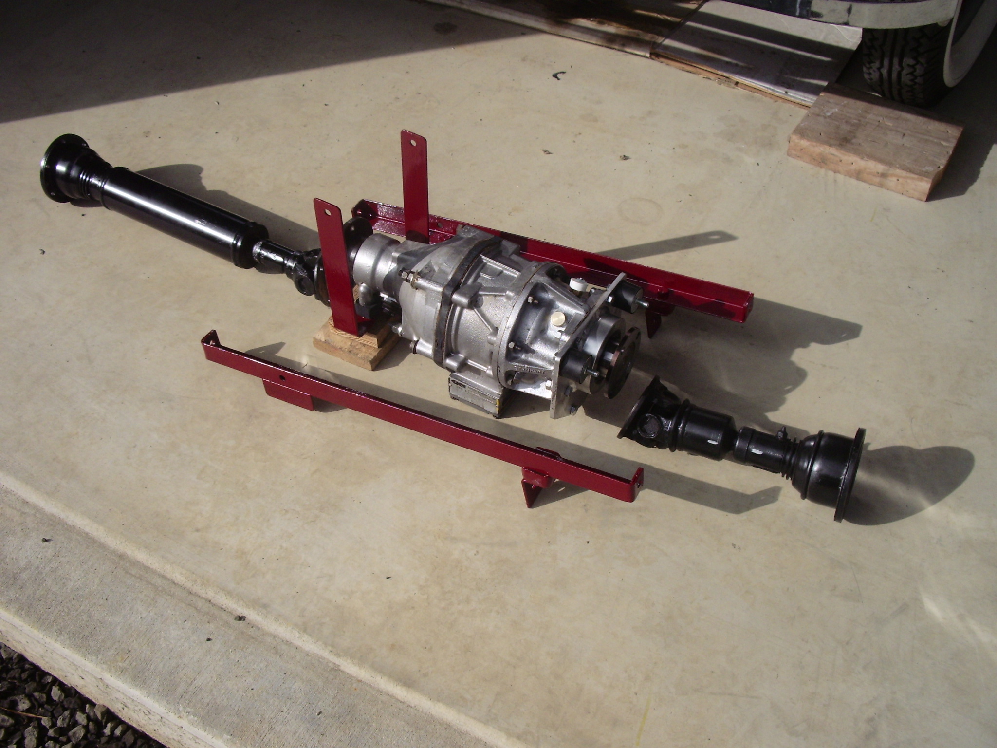

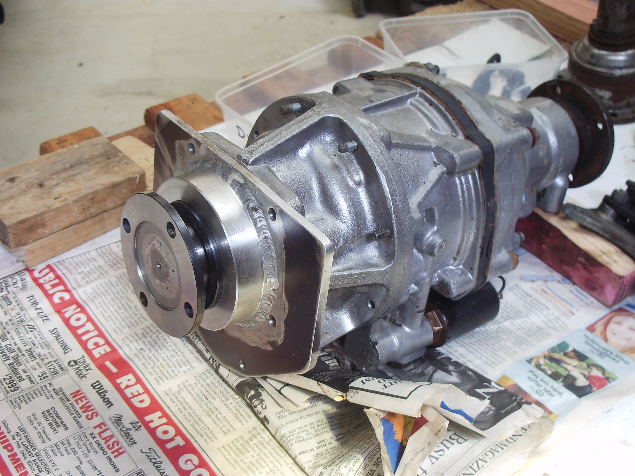

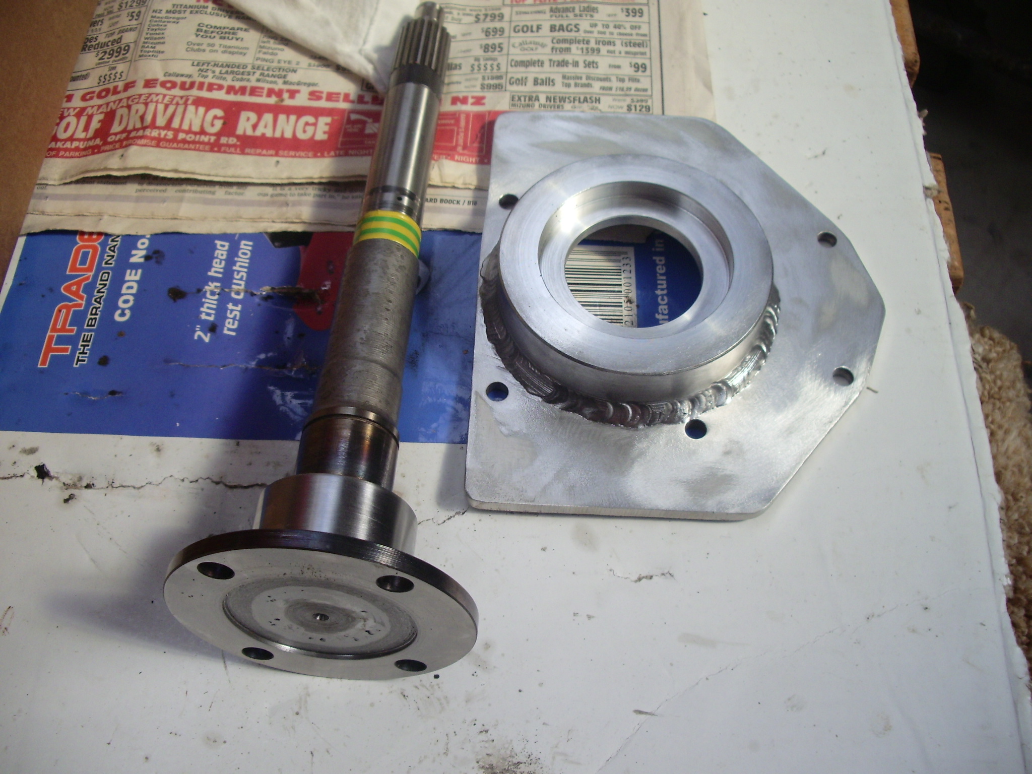

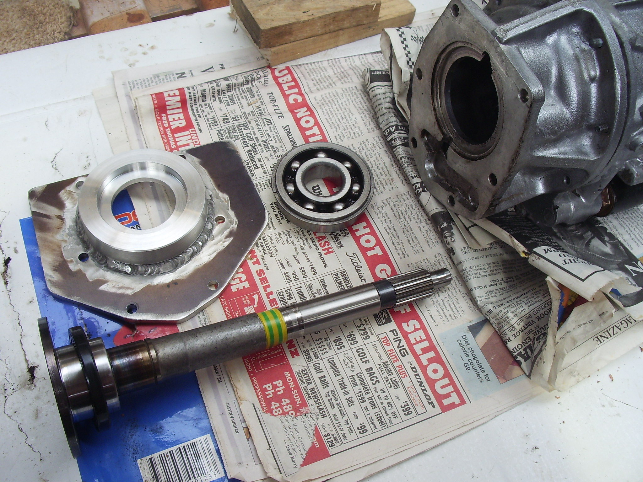

I have attached pics of the overdrive unit in case other members are interested or know where there is a unit.
Trevor NewZealand

Hi Jeff. As far as I know all the overdrives that you are referring to including the Volvo are basically the same. Interestingly enough I have a Terraplane box with a Laycock overdrive attached directly onto the rear of it with what looks like a factory adaptor I will send you a photo if interested. Apparently it came out of a 39 Hudson that had been in England maybe there was an adaptor available there in the day
Regards
Trevor
Trevor,
I'd be interested in pics of the Laycock O/D directly attached to the rear of the gearbox. I've got a Laycock O/D in the garage & this sounds a much nicer solution that what I've been considering for the Essex Coupe.
Thanks
Dave Young
