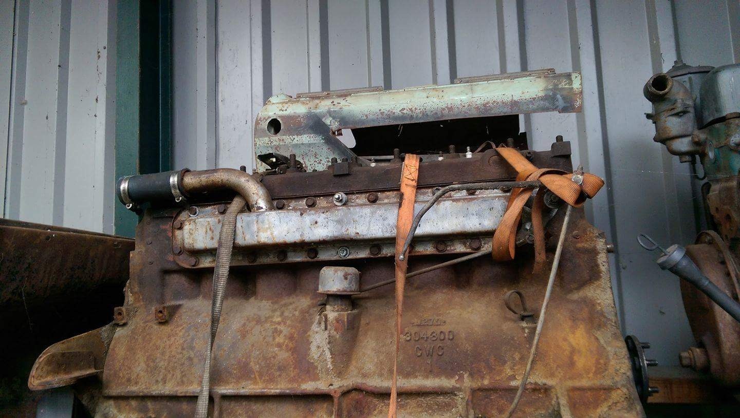

I am pretty new with Hudson 8 cylinder engines.
Can someone tell me from around wich year this engine would be?
And is it hard to find parts for..
The owner says this engine has NASCAR history..?0 -
The 8 has no Nascar history. The 308 cubic inch 6 does! I am sure Someone will look up the casting numbers and answer your question. Overhauling the 8 is very expensive..0
SuperDave said:The 8 has no Nascar history. The 308 cubic inch 6 does! I am sure Someone will look up the casting numbers and answer your question. Overhauling the 8 is very expensive..That is what I thought that the 8 has no Nascar history. Okay good to know this engine would go in a mid 1910 inspired speedster. I have read that there is not really an aftermarket for these engines?
looks like it a 37 thru 47 narrow block, whats that on top? overhauling not cheap, but not any worse than any other old engine0

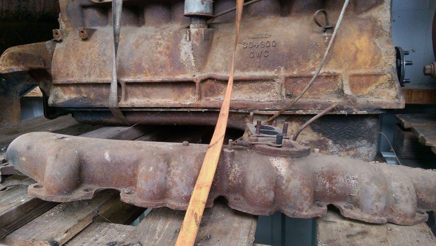

Based on the casting number, engine pictured is a 1951 or 1952. I'm not able to see the date code or could be more precise.0
Casting # appears to be J270 = Oct 27th, 19500
