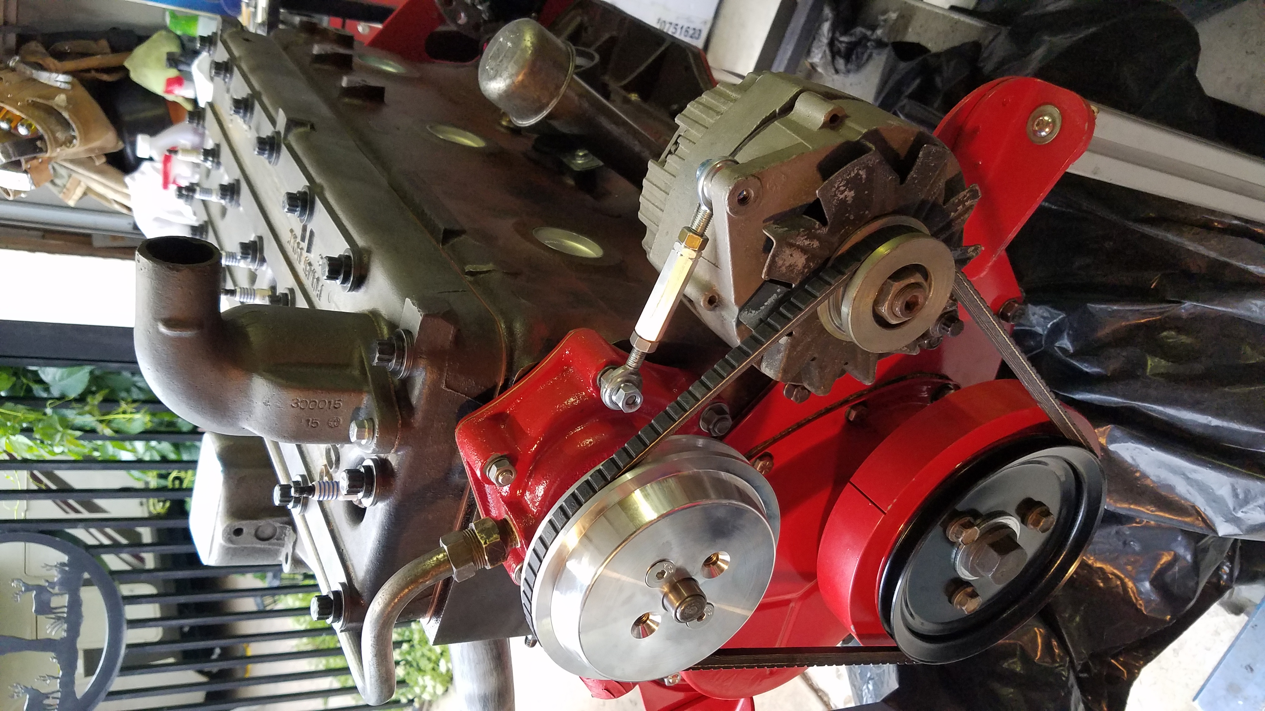

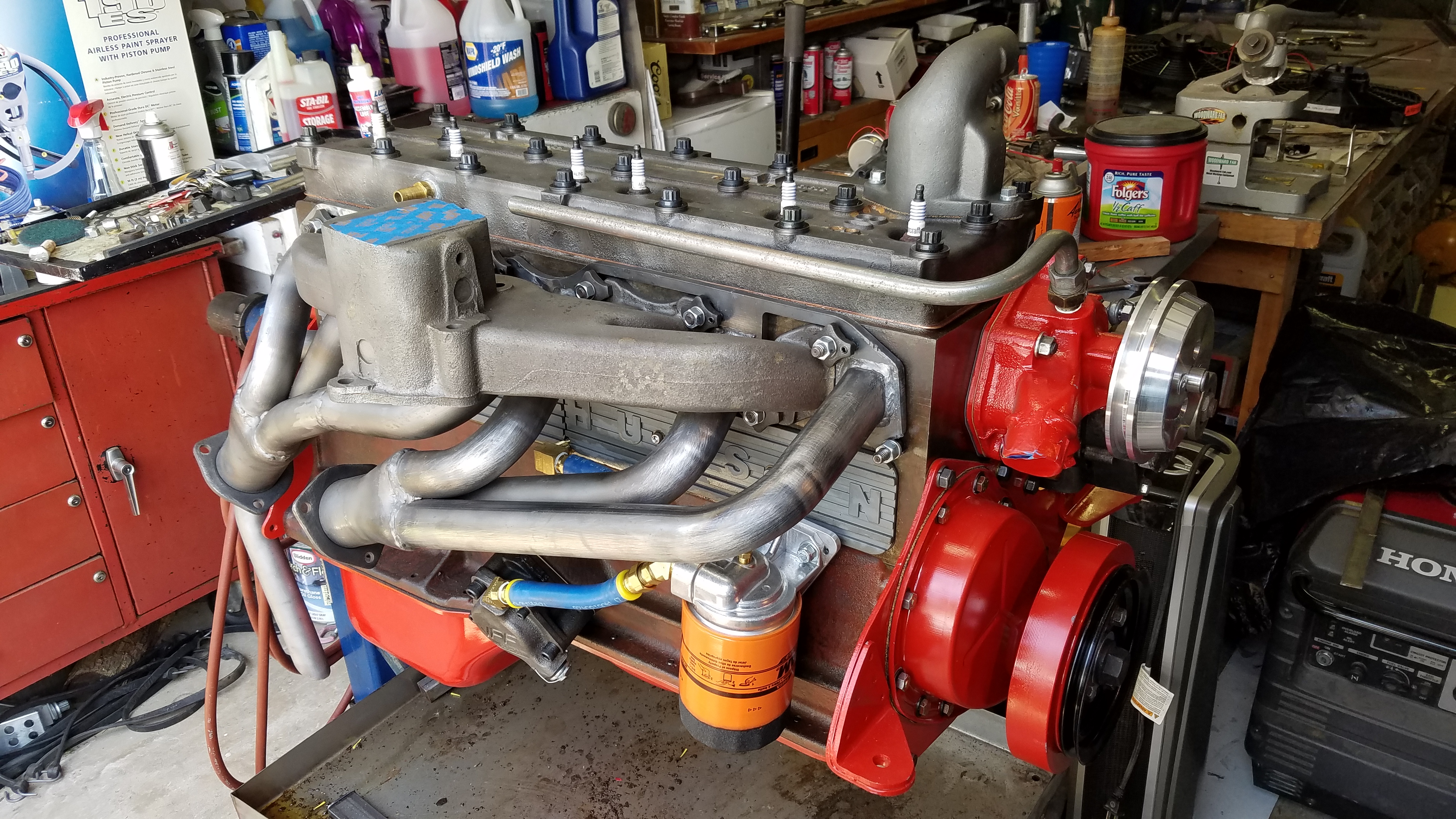

I've been kinda quite for awhile - slowly getting it back together. Not far off from starting it on a stand.
Grim, looks like Frank's (may he rest in peace) full flow set up. I had to use a smaller filter due to it hitting or being within mm of the frame on a 53 hornet. What is the dampener from?0
Yup, Frank's full flow setup. Dampener is from a Chevy 350, modified to fit the Hudson crank and a adapter ring for the front cover to use a regular Chevy front seal.0
