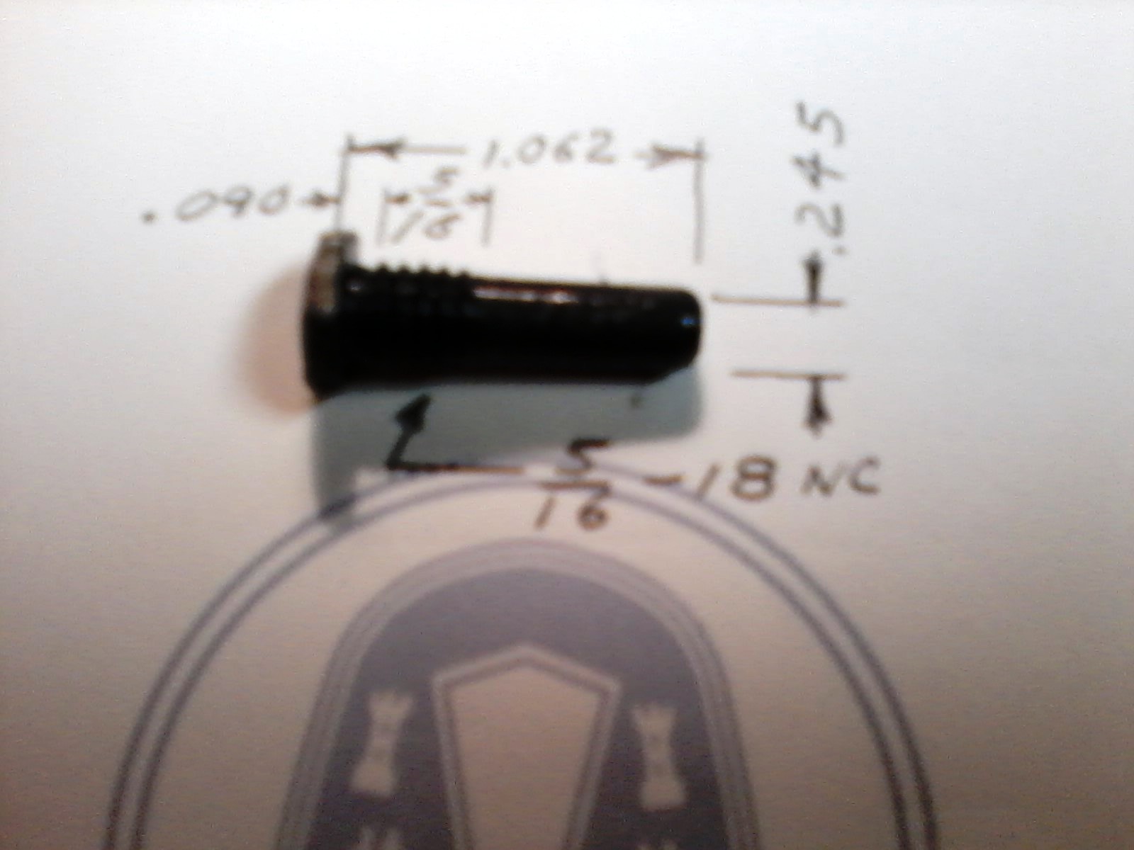

John, this is the one from my standard shift. Don't know whether it's the same one for auto as I don't have one.
John, this is the one from my 49 Standard. Don't know if it's the same one as auto as I don't have one.
Basically the thread is 5/16-18 NC x 5/16 long. the snout is about .245 dia and the whole thing is 1 1/16. The hex flats are 1/16 and the radius is another 1/16
Somebody should have one for an auto for you. At least this will bump it to the top.
