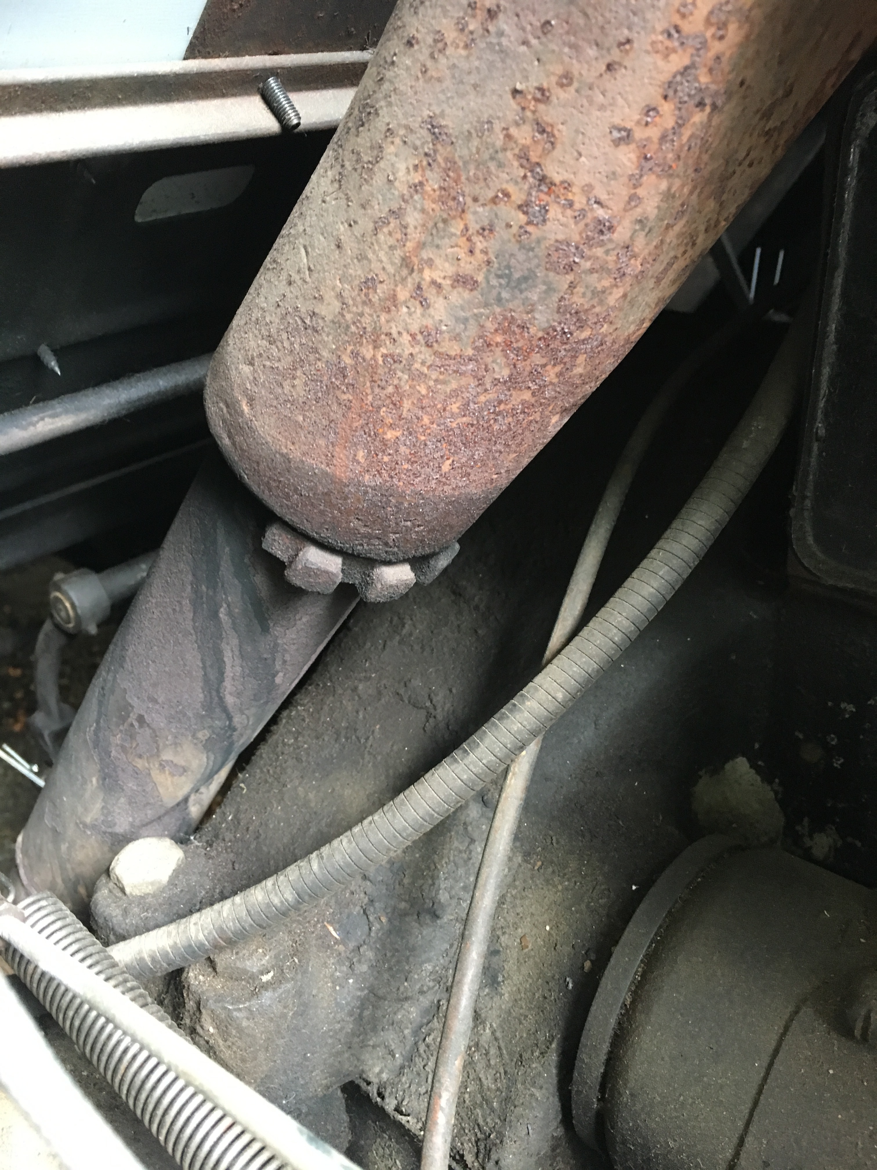

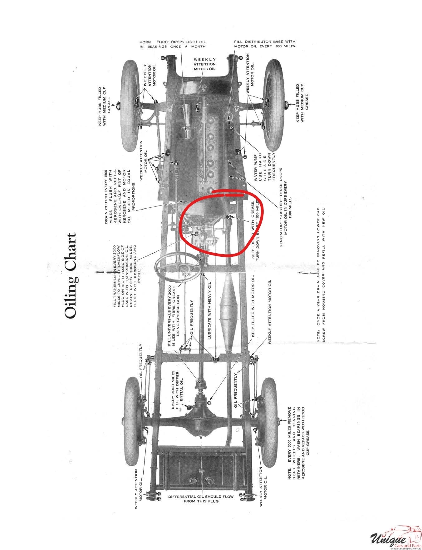

Thank you, I've been meaning to join for awhile. It's fuel Leaking but its not leaking from the tail pipe, its leaking from the area that's circled redJon B said:Welcome to the Forum!
Fuel is leaking out of the exhaust? Or smoke? If smoke, isn't it just a crack or hole in the pipe?
If it's running fine, how do you know it's getting too much fuel?
Have you examined it closely to see if perhaps the fuel isn't dripping down from (for example) the intake manifold onto the exhaust pipe (dangerous condition!)? It's hard to imagine that the fuel is getting through the cylinders un-burned, thence working its way through the exhaust. But hang in there, sooner or later one the owners of an "older" Hudson will jump in here, and might have the answer.

It's coming out from that area there. But there's a substantial amount coming out
