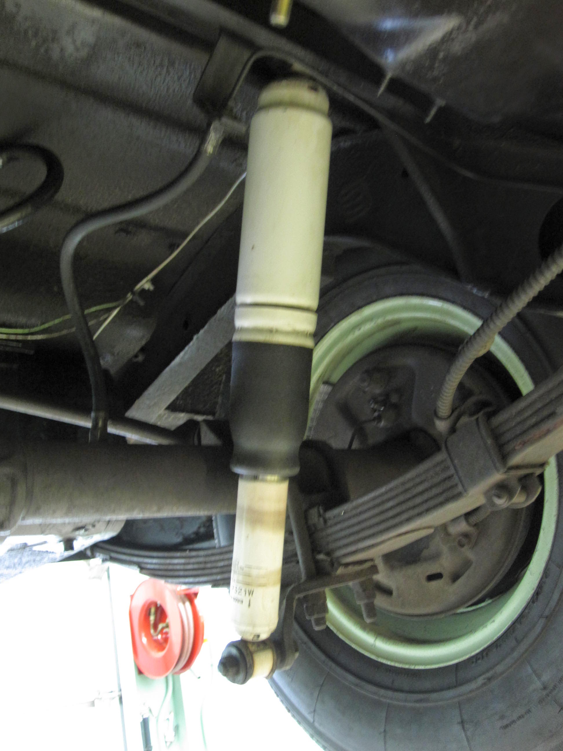

Monroe air (pump up) shocks #MA727 at Advance Auto for $70. Call Monroe at 734-384-7809 to see if they fit the 52. I have on my '53.0
If you are into gas shocks... I have a set of four I bought from Kanter 5 years ago. I am happy with them... running 7:10 X 15 bias ply tires on that sedan0
have the spring over on the 53 Sedan rides like on air. Thanks for the info fellows0
