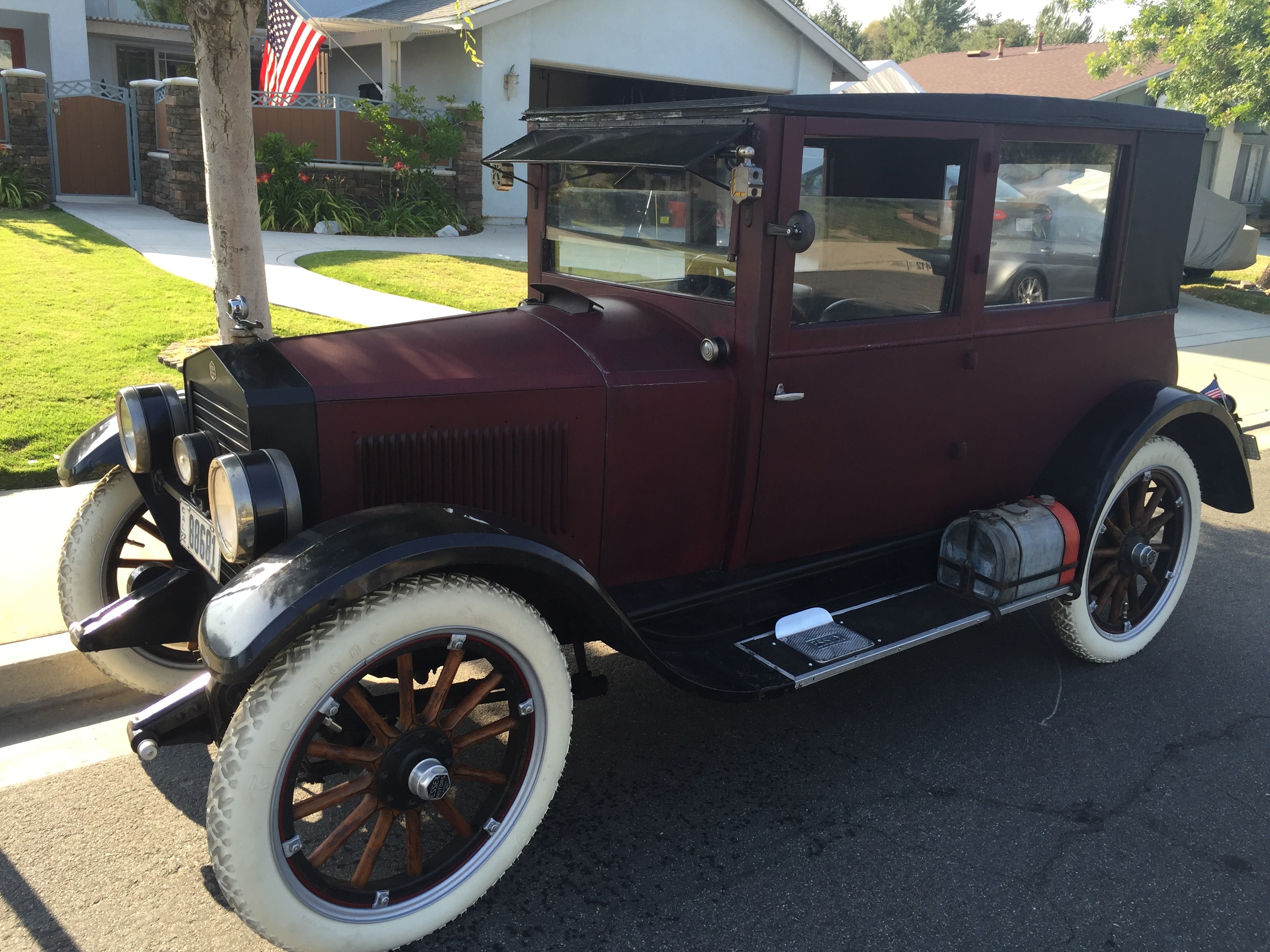

You can get crazy and put white tires on for big bucks but be ready for them to turn brown in about a year. I got mine from Coker and they replaced the first set due to the discoloration. The second set is talking slightly longer that a year to turn brown. They look great at first. Very disappointed in the color change but I like everything else about the tires. Jay
Beautiful car. I like the natural spokes and the flat maroon paint0
The car above has firestone no skid tires $350 a piece. Coker has a $280 goodrich and universal has a ribbed tire for $280. Thoughts on why i might want on or another of these?0

Just looking for a solid functional tire0
Then buy what you feel comfortable with. They are all pretty much the same. However, get new tubes (more than 4) and new flaps (at least 4). Also give the inside of the rims a good look over. If rusted, get rid of the rust and paint with good paint. The last thing you need is the split rim rusting from the inside out. Safety always the first consideration. Also if the spokes are loose, deal with that immediately. You don't need wobbly wooden wheels at any speed.
Jay
Rims and spokes are first on the list. Current tires look like it was driven over a land mine0
