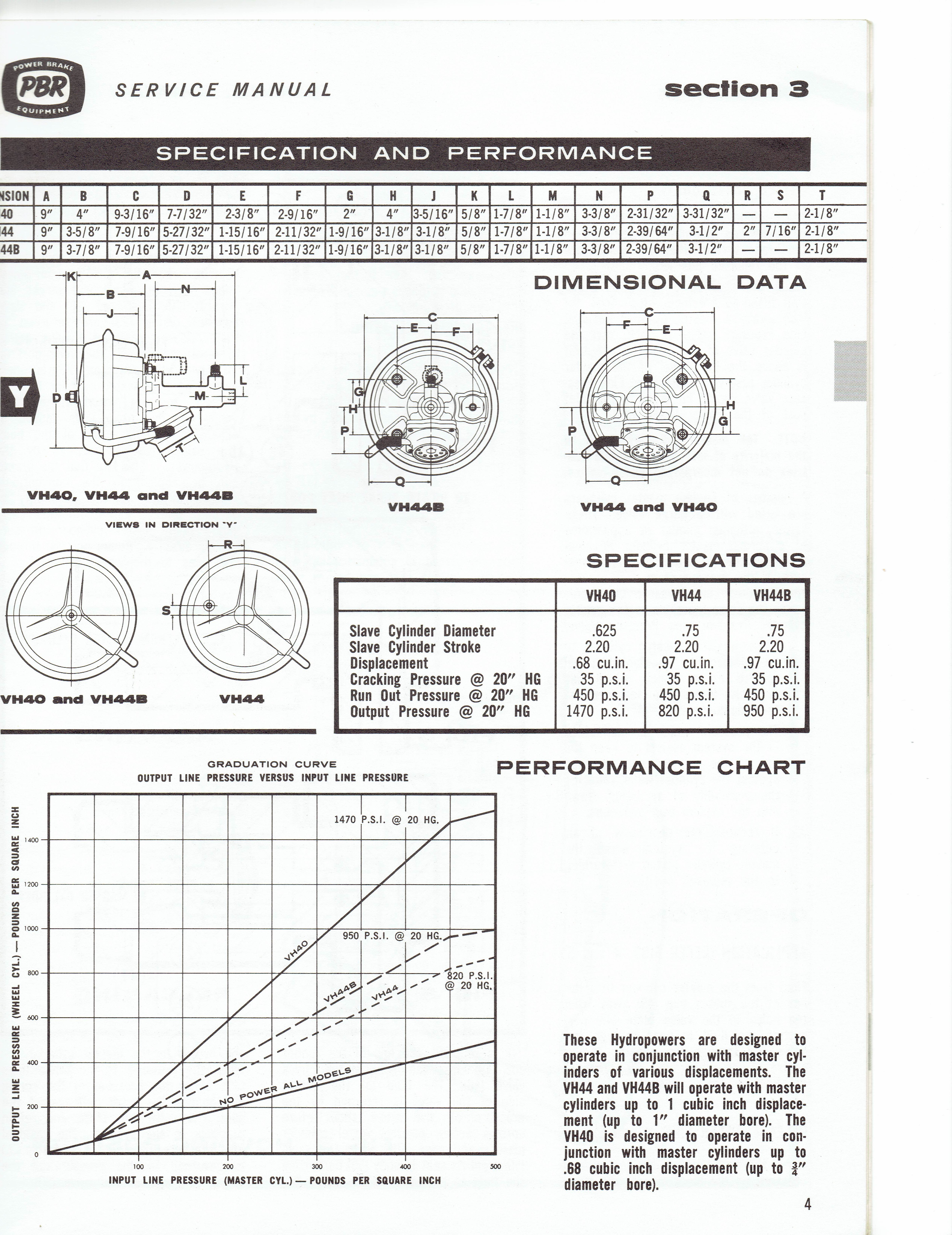

Dan, just installed a PBR VH40 booster on my '53 {1450 psi @ 20"hg}. You will not believe how good the brakes are. EXTREMELY strong--in a heartbeat !! Check your messages.0

No, Kerry, just stating what the attachment has on it at max. Think 16" would be good. Thanks, now I am curious.
Would need to be the vacuum when the brakes are applied. But I am glad stopping is not better than it is now. Not sure that the 18" above is a minimum; would be an unworkable system. That is why I attached the graph for 'typical' hydrovacs.0
