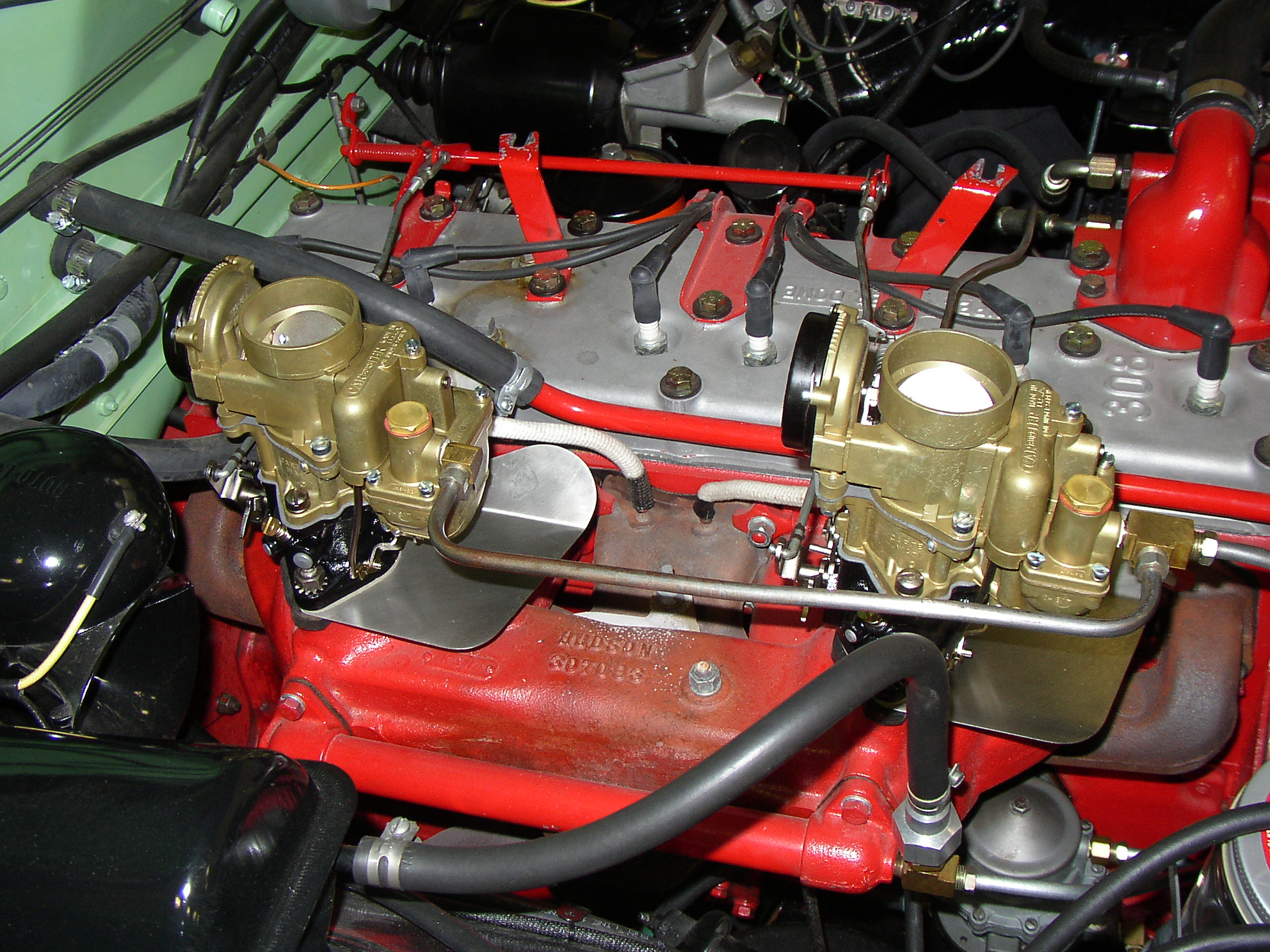

Hi John,
Thanks for the photo and the confirmation. I appreciate it. By the way, love those "golden" carbs. How did you get them to look like that? Very cool.
Tim0 -
Tim,
I had Daytona Parts rebuild them a few years ago. They anodized them during the rebuild process but stopped offering it a year or two ago. Someone told me that they don't rebuild carburetors any more either, they just sell rebuild kits.
John0 -
John,
They look great. Thanks.
