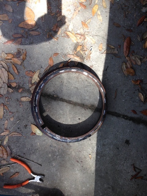

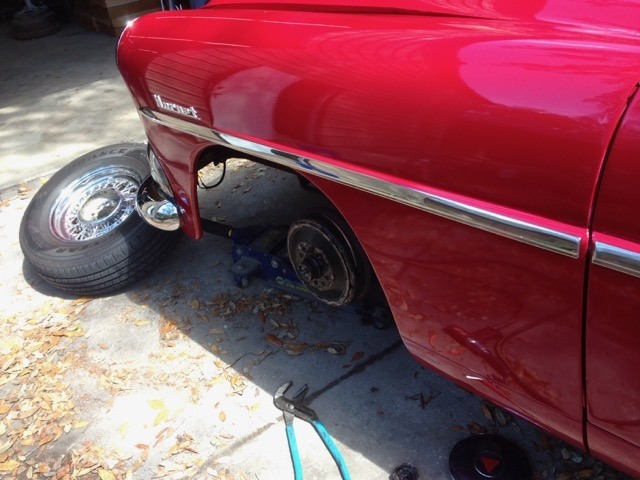

Finally, after 3 months I finally got down to Joe Stinnett's to pick up the Red/Black '54 Hornet coupe I bought from him in December. My 81 year old Dad, and my 15 year old son are making the trip with me. Of course nothing is ever as you plan it when driving an older vehicle, even one in really great shape. We pulled out of Joe's driveway and took off down the road. About a mile later I remembered I wanted to get a picture of Joe with us and the car. We made a Uey and as we pulled back into his drive a horribly scrapping sound came from the left front wheel well. We pulled off the wheel and found that the disk part of the drum had sheared off from the outer rim (see pic). This was really strange as I nor Joe had ever seen this happen. Joe did try to make a front drum from a rear but that did not look like a good idea. So we made the two hour journey to Bill Labud's place for a good used drum. Bill is quite a character by the way. We got back and after some more effort finally got onto the road, 6 hrs later than planned. The good news is that the car so far has run great even at 70+mph and 90 degree heat today. Made it to Charleston tonight.

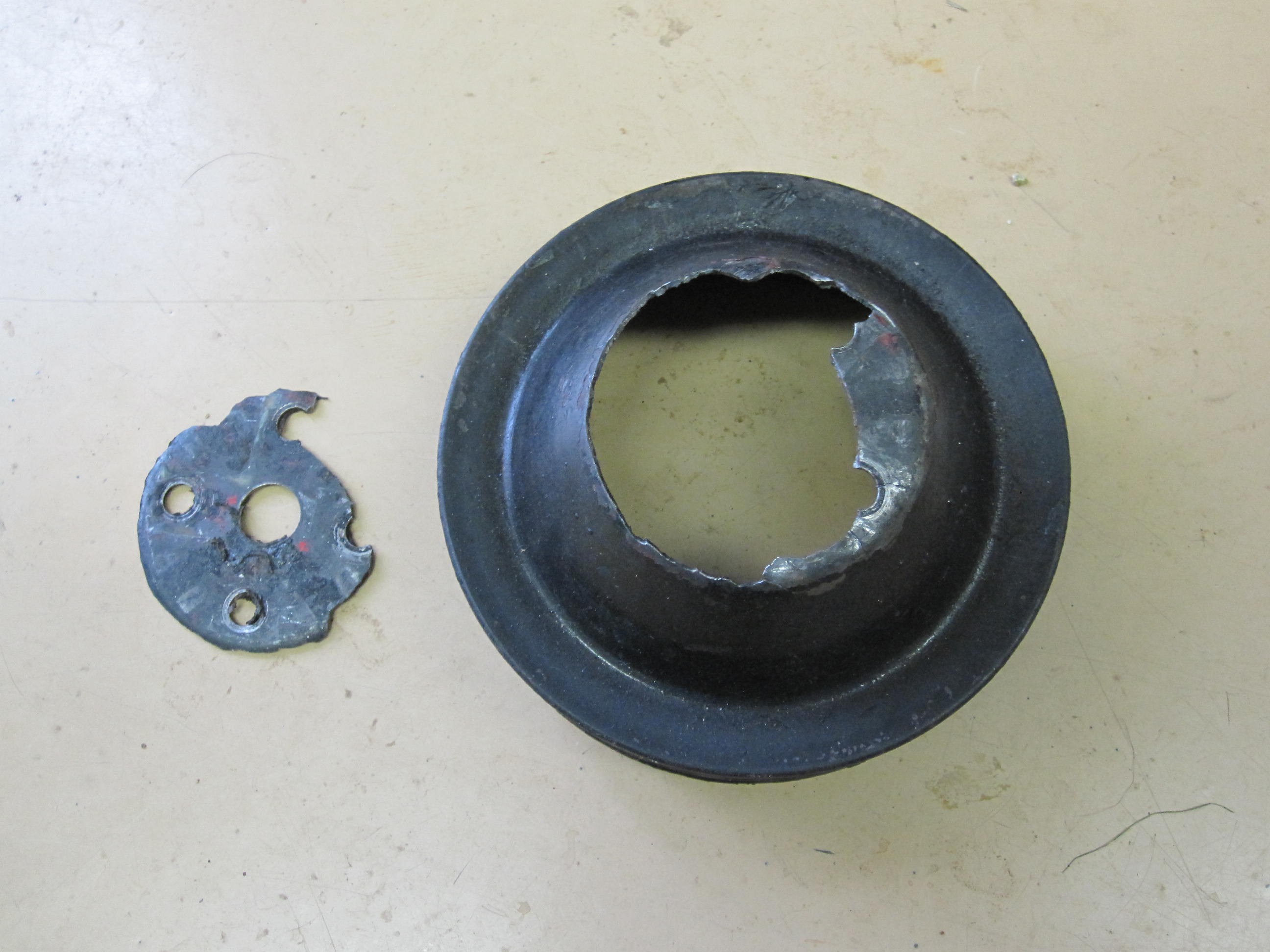

Come along little doggy !! Keep coming. Here is what happened to my '53 in SC while bringing my car back from Fla to NC. Yes, a rollback carry for 200+ miles. This is the water pump pulley (double for A/C) that is made from 1/16" thick metal
Good thing the fan stays put when that happens! I'd guess it just makes a lot of racket.
F
What irritates me is the 1/16" thickness. .
Ken what you see is the area under the disk where the disk and rim rubbed against each other when it let go. This is not the top that would be against the KH wheel.0
