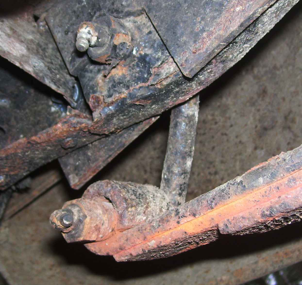

sent picture to your email. Hope it helps.0
Hello Mr. Klemm,
I received the pictures, and they were exactly what I was looking for. It looks like my rear shackles were modified at some point.
Thank you, and take care,
Steve Bryson0 -

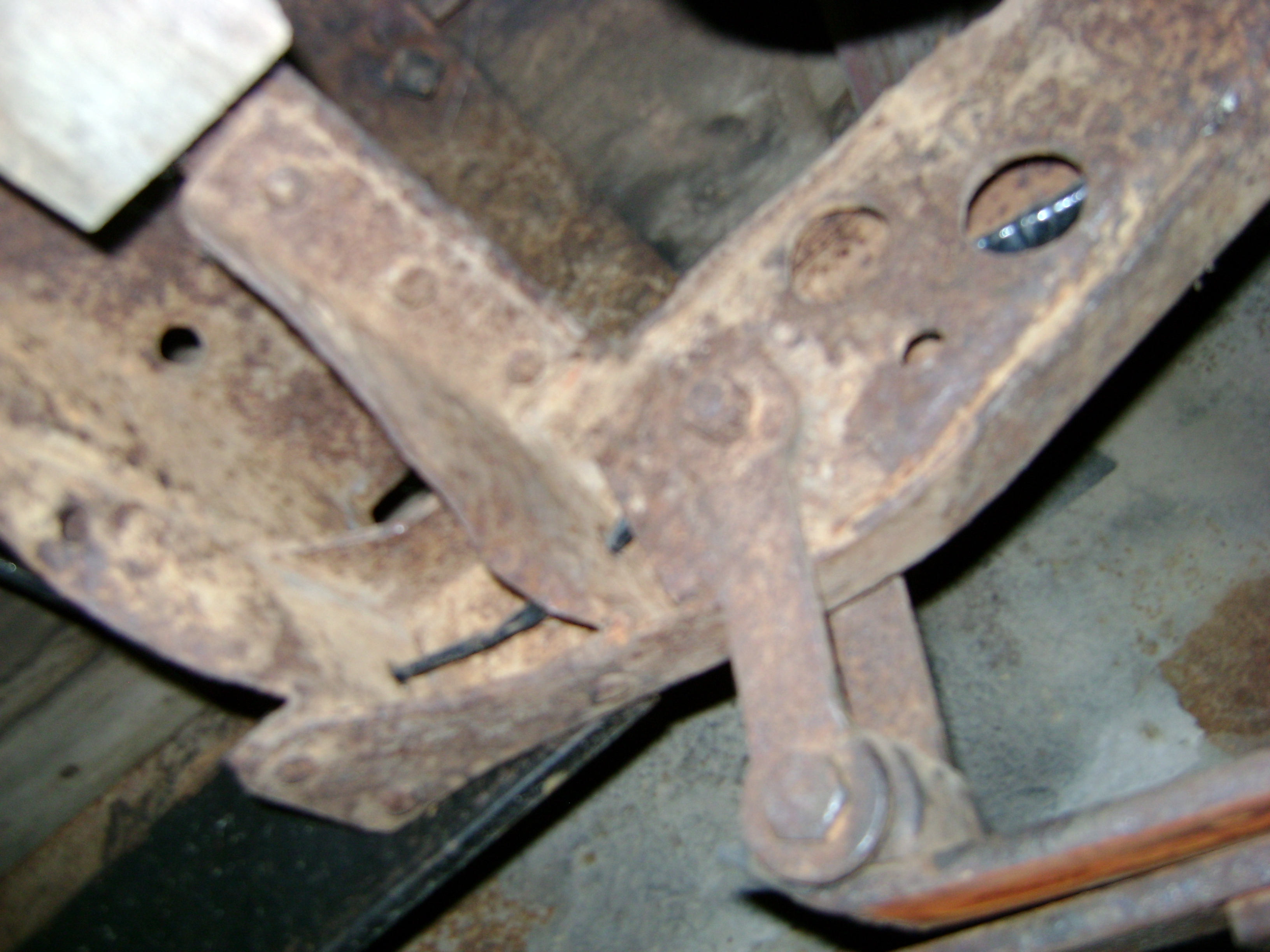

Keep in mind that the left rear shackle is left-hand threaded
If the wind and snow lets up today, I'll see if I can get a pic of mine for ya
This is how it goes. The frame has some fish plating, grease, rust and gunge so ignore that.0
Hello Uncle Josh,
Thank you for the photo. Between your photo, and the ones Mr. Klemm sent to me, I have a pretty good idea of how the shackles are supposed to be.
I have seen replacement shackles like the ones on my truck for sale on E-Bay. I suppose it was an easier way to replace the shackles than with the original-type ones.
As I mentioned, I have NOS shackles of the correct type (a left and a right), so hopefully no modification was done to the frame when they were changed.
Take care,
Steve Bryson0 -
